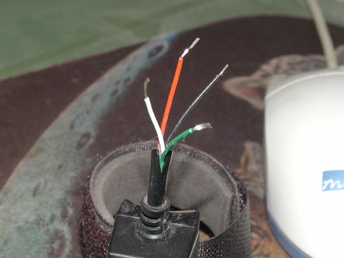

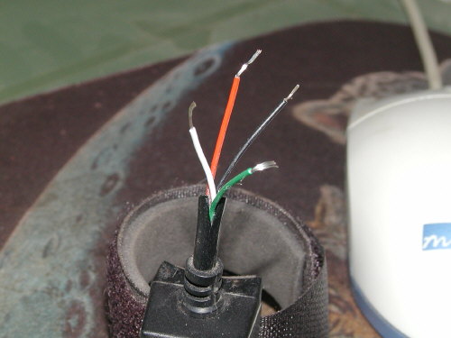

I want to use the buttons on my grip to activate the push to talk switch. Thinking that it should be a simple act of a momentary switch I cut my factory switch wire into. Long enough to splice it back together if thing went as they normally do. Instead of two wires, I find that there are four in that little bundle. Any one know anything or at least enough to help me out here? I have searched the internet and can't find anything other than where to buy them.

OK, I just tested the four wires Red and Green are activated when the button is pushed. Black and white are also activated when the button is pushed. My grip button has only two contacts. Anybody have a clue as to how to wire this thing.[img]cid:003801c74316(at)usermj5tjr71vq[/img]

Hi Larry,
When I was messin with my old com system...my PTT also had the 4 wires.... there were Two momentary switches...
One - normaly open
One- normaly closed
What this did was cut-off andbody in the intercom , while the pilot is using the radio...
Sounds like yours might be the same...
You could , just use the two wires and elbow the passenger...He he he
Or maybe you have something different...
I think mine was Comtronics...

PostPosted: Sun Jan 28, 2007 12:55 pm    Post subject: help! Reply with quote
Larry
The four wires is for a double pole double throw switch?????

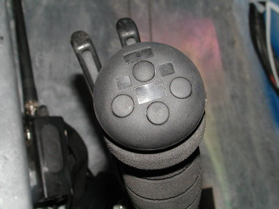

Hi Larry,
One - normaly open
One- normaly closed
using the radio...
This one is I-com. Here is a picture, perhaps that will help. If I weren't
afraid of frying the final or something else in the radio, I would just
connect the four wires together into two pairs and call it good.
Larry,Oregon

Larry:
Don't take this for gospel, but I think the white wire is the PTT
wire. Ground it and the radio should go to xmit.
However, don't do that because I said so. Let me see if I can find my
schematic for my icom.

Does your PTT include a plug & jack for your headphone mic? If so, that
would explain the extra wires.
Do you have an ohm meter? You can use it to identify which wires are
tied together when the PTT is pushed & which wires go where at the plug
end of the wire.
If you've got an ohm meter & need some help with how to identify the
wires, let me know & I'll try to walk you through using it.
