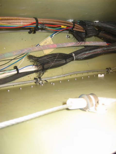

This is how we did it in the tunnel (the line on the right above the brake
line is the return line). It can then go out to that tank or can "T" into
that line and you will want to pull from the other tank when purging the hot
fuel (if you are doing it that way). Has anybody else lined up the fuel
system to allow for straight lines connecting the pump, filter and flowscan?
Am I missing the reason they are not lined up to start with?
Hope this helps.
Jesse Saint
Saint Aviation, Inc.
jesse(at)saintaviation.com
www.saintaviation.com
Cell: 352-427-0285
Fax: 815-377-3694

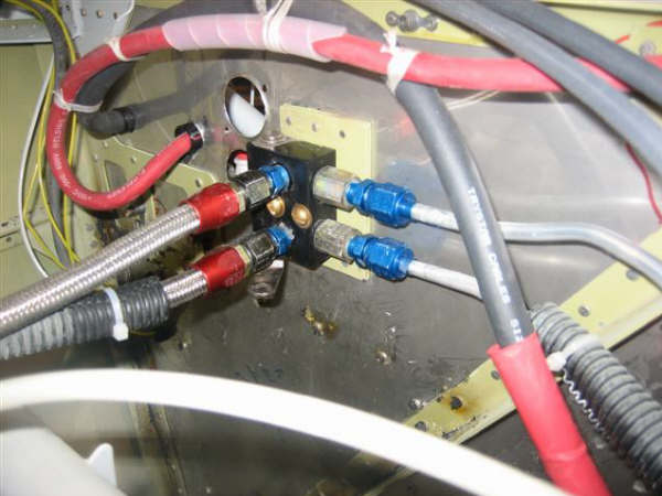

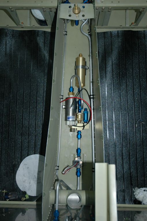

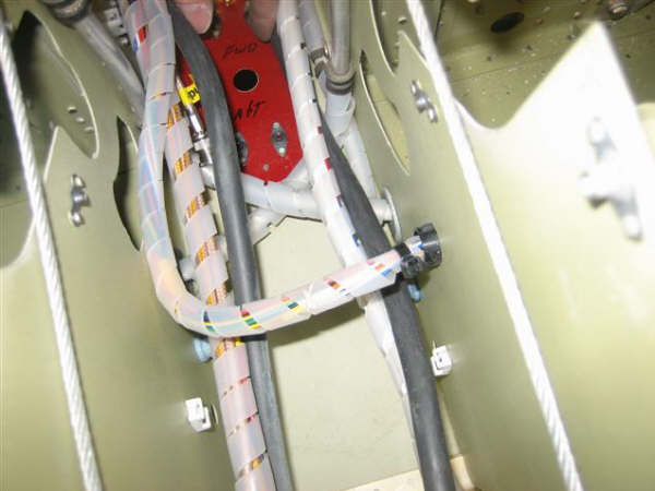

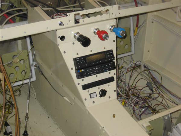

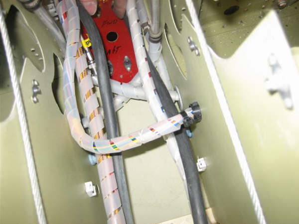

Jesse,
Does your fuel return have a separate selector?
We plan to use the Andair duplex valve (p/n FS 20-20-D2) using -6 lines for
both supply and return.
We also built a "shelf" off the floor of the tunnel to mount the
filter/pump/sensor to.
This allowed us to put 2-3" of insulation directly on the tunnel floor under
the pump/sensor.
Also, we wrapped the brake lines with nylon spiral wrap in the tunnel.
After the insulation was packed into the tunnel for a trial fit we found the
brake and fuel lines could chafe on the shop heads of the rivets directly
below them in the tunnel.
Here's a few pictures of the lines, valve, pass-thrus, parking brake, and
the center console.
ERic--
