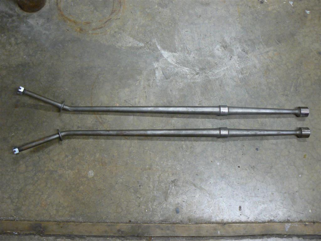

They did sell springy ones. I have a set that I am saving for the time when I trash my aluminum gear legs.
Here is what they look like:
Richard Pike

I have a set of those gear legs installed in my VW powered MKIIIc. They are
indeed springy. When you land hard with a bit too much airspeed you will
find yourself 10ft in the air with very little airspeed. A blast of power
fixes the next landing. These gear have I would guess the third most air
miles as any Kolb. I bought them from ??? in Hawaii. He sold them because
they were too springy. Personally I think they are just right. When everyone
at Oshkosh is grumbling about how rough the ground is I just say "is it? I
can't really tell".
There are two things I would recommend doing to the gear before installing
them. These are the same gear that the Old Kolb sold but they welded a steel
tube 6 to 8 inches long on the end to carry the bending load further up into
the landing gear sockets. I would weld that same tube on. The next thing
would be to bend the gear down a bit to make the wheels run more vertical
(is that camber?). They squat a bit when the plane is loaded.
Rick Neilsen
Redrive VW powered MKIIIc

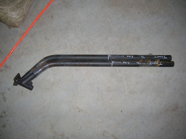

Colder than a well digger's knee caps here, I woosed out last night, but got a picture today. Still in TNK tape and factory insert up to here lines.
Rick
