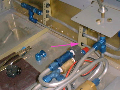

gerf(at)gerf.com Guest
Posted: Thu Feb 08, 2007 6:43 am Post subject: Fuel Injection System |
Not quite correct. Its not a full time return line, its only for use with the purge valve for flushing he fuel lines before startup. It doesn't need to extend back to the tank. In my setup its T'ed into the right tank supply line just up stream of the fuel selector in the cabin. No changes to the fuel tanks required, easy to retrofit even on a completed plane.
g

dan(at)rvproject.com Guest
Posted: Thu Feb 08, 2007 8:02 am Post subject: Fuel Injection System |
See the attached photos for what Gerry mentioned. Very easy to tee the AFP purge return into the fuel supply.
)_( Dan

david.nelson(at)pobox.com Guest
Posted: Thu Feb 08, 2007 12:57 pm Post subject: Fuel Injection System |
Hi Dan,
I'm curious - in looking at your pics, why didn't you plum the return in
between the two backets?
/\/elson
Posted: Thu Feb 08, 2007 1:45 pm Post subject: Fuel Injection System |
My philosophy was...the closer to the tank the better. I don't think it
makes much difference.
)_( Dan

If you plumb into your fuel supply system instead of the tank or vent,
then there is a possibility of contaminating the fuel supply with air
should there ever be a problem with the return lines. IF this happens,
the result is a loss in steady fuel supply to the system and potential
engine failure.
I have personal experience with this failure mode.
Mike
