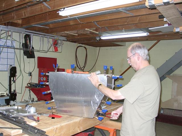

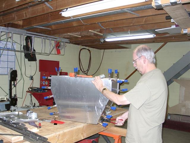

Just some pitures from my recent efforts. It is basically the Brothers Hauck design. A little thicker (.063"). Originally calculated 20.5 gallon capacity. Ended up 21.5 gallons when I did the flow test and level gauge markings check.
Still haven't flight tested it yet!

Michael Sharp
Joined: 10 Jan 2006 Posts: 118 Location: Oak Grove, MO (Kansas City)
Posted: Wed Feb 14, 2007 6:05 am Post subject: Gas Tank Study |
John,
NICE!
How many Workhrs do you have in fabrication?
Mike in MO

jim
Joined: 03 Nov 2006 Posts: 107 Location: N. Idaho
Posted: Wed Feb 14, 2007 8:40 am Post subject: Gas Tank Study |
Are you going for a Kolb record of non-stop coast to coast?
Wow, that's a lot of fuel!
| Quote: |

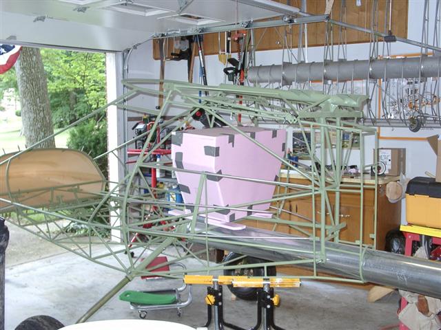

Here are some pictures of my gas tank mock up and fabrication. the shape allows it to be installed with just one cage tube cut out. The sloped sides allow for room to install the fuel pump, gascolator, hot box and battery. It's about 19 1/2 gallons. I added an extra fitting on top so I could pump fuel into it from an aux. tank in the passenger seat if ever required. I had to fabricate and weld in a mounting platform for it to sit on.
Rex Rodebush

Joined: 09 Jan 2006 Posts: 4639 Location: Titus, Alabama (hauck's holler)
Posted: Wed Feb 14, 2007 6:06 pm Post subject: Gas Tank Study |
Rex:
My fuel tank is very much the same shape as yours. We designed mine
to fit in the upper rear half of the fuselage in order to open up the
bottom rear for a cargo compartment. Looks like you could do the same
thing and not kill available cargo space.
With 25.0 gal I never consider using the left seat for an aux tank.
That is my flight desk.
A couple things I could never get over to the Kolb folks is a nice
generous cargo compartment and a big fuel tank. Maybe if we keep
reminding them that these are quite necessary items for those of us
that like cross country flying, we can get them working on a couple
upgrades.
Glad to see folks upgrading fuel capacity during the building phase of
their projects, and not after they are complete. Most folks finish
the airplane, fly it a few hours, and immediately want more fuel.
_________________ John Hauck
Titus, Alabama |

Rex Rodebush
Joined: 10 Jan 2006 Posts: 209 Location: Branson West area, Missouri
Posted: Thu Feb 15, 2007 8:30 am Post subject: Re: Gas Tank Study |
Hi John,
I thought about mounting the tank as you did but was concerned about aft C.G. (I know this has been talked about before and your tank has not been a problem for you!). Anyway, while the area under the tank will have the battery, hot box, fuel pump, gascolator and ELT; I will make a storage area behind the tank, accessable from the outside, for lighter stuff. ie, sleeping bag, tent, etc.
Rex
| Back to top |
