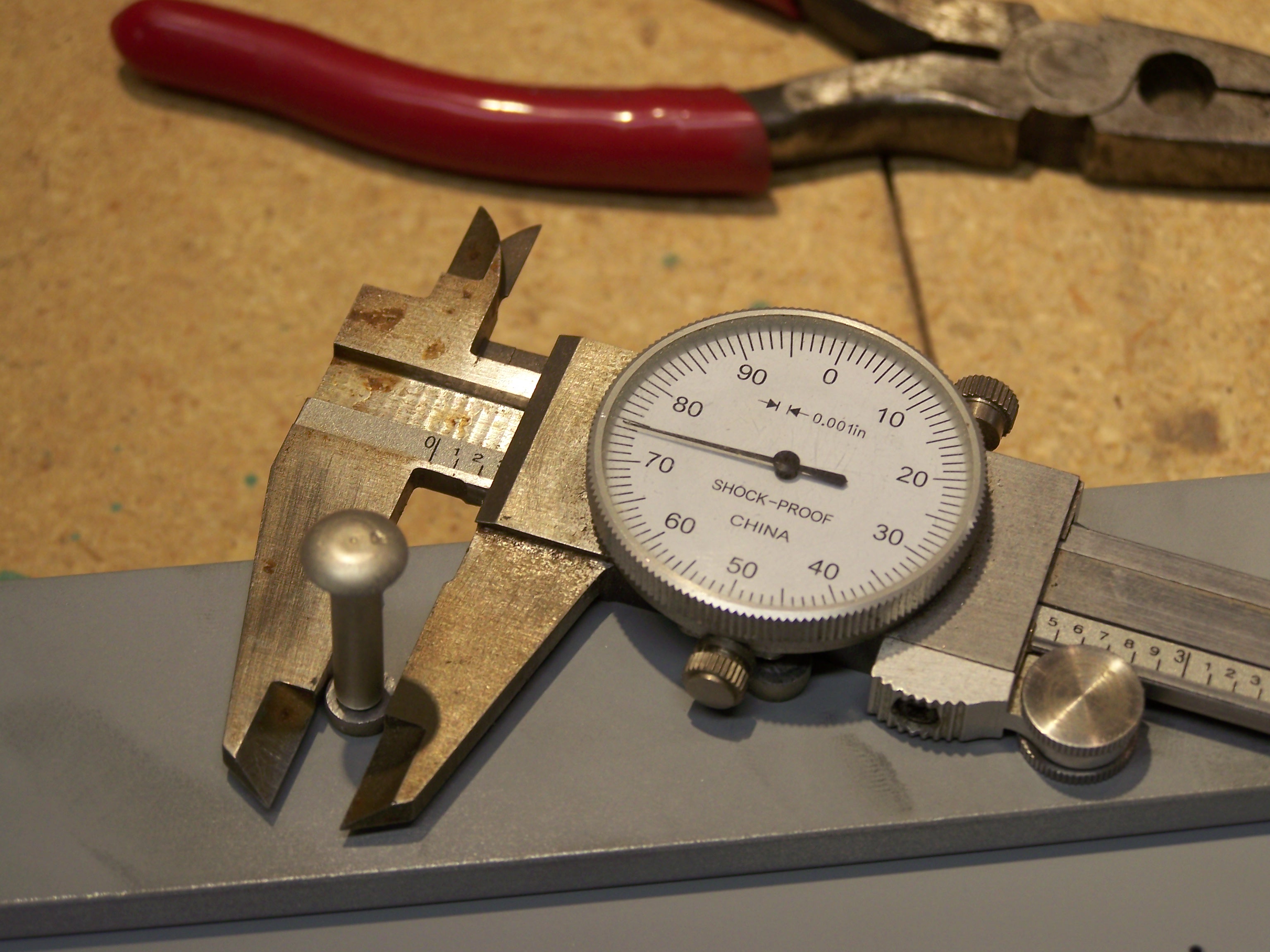

Posted: Mon Feb 26, 2007 9:10 am Post subject: Solid riveting spar - setting solid AN6 rivets |
Anybody have any problems setting these to .281 shophead diameter? I'm getting to like .260 before it seems to get work hardened at which point I don't want to overdo it.
I tried a few on less pressure at first (90psi) as well as a lot of pressure (130 psi) and either way it seems to get work hardened at about .260".

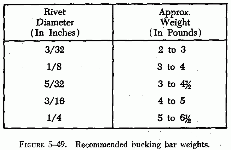

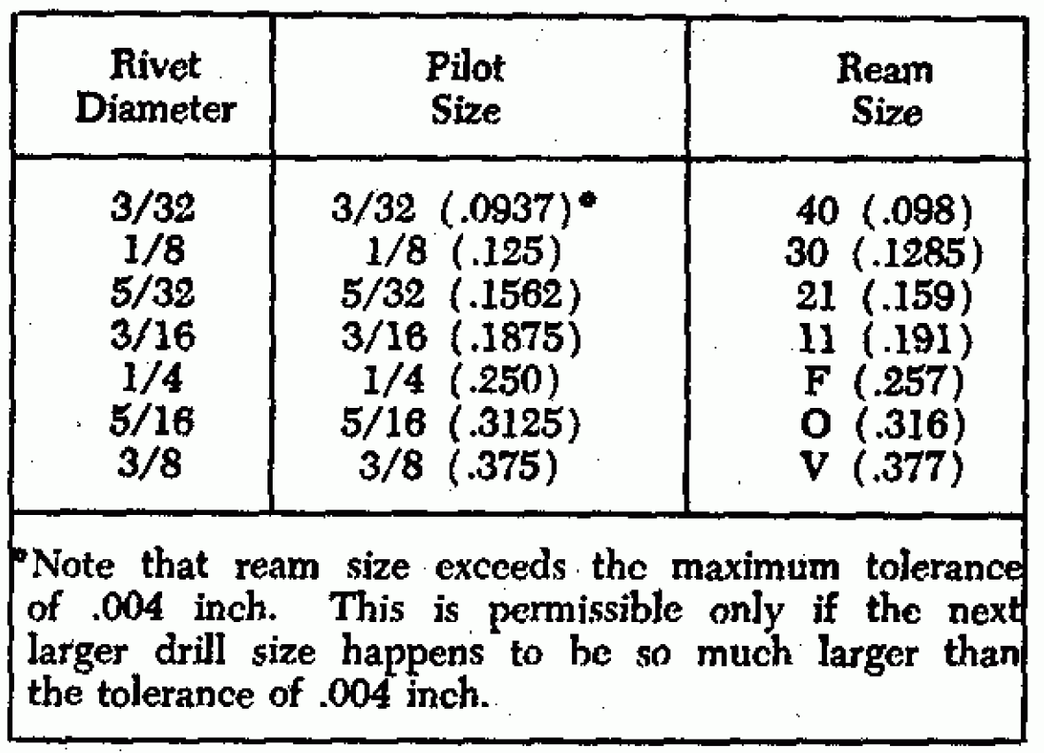

Hopefully,there was no offense taken from my comments earlier. Plese review the attached files. They were copied from the AC65-15A Airframe Handbook. These are the officially accepted hole diameter limits for the AN470AD and MS20470AD driven rivets. Since the rivets you refer to are 7/8" long we assume that the joint stack is 11/16" thick, clamped. If the hole for tat fastener were drilled with a 3/16" bit (0.188"ø) the rivet will be too long and not only will the rivet be difficult to drive with the requisite 1.5ø x 0.65d height shop head but teh strength will be somewhat substandard due to a lack of proper work hardening.
The weight for the bucking bars are also important as they directly contribute to the number of impacts needed to upset the shop head.

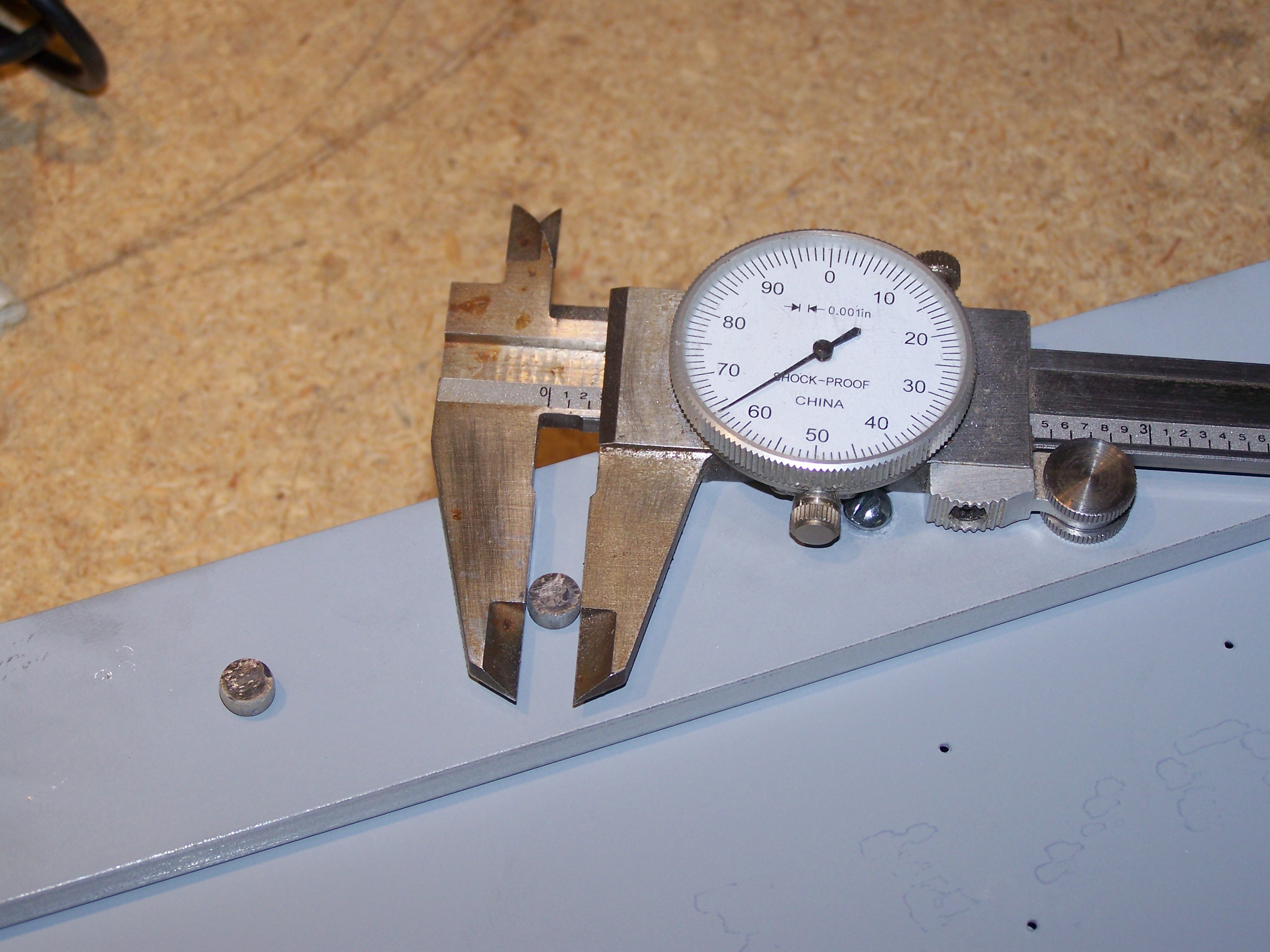

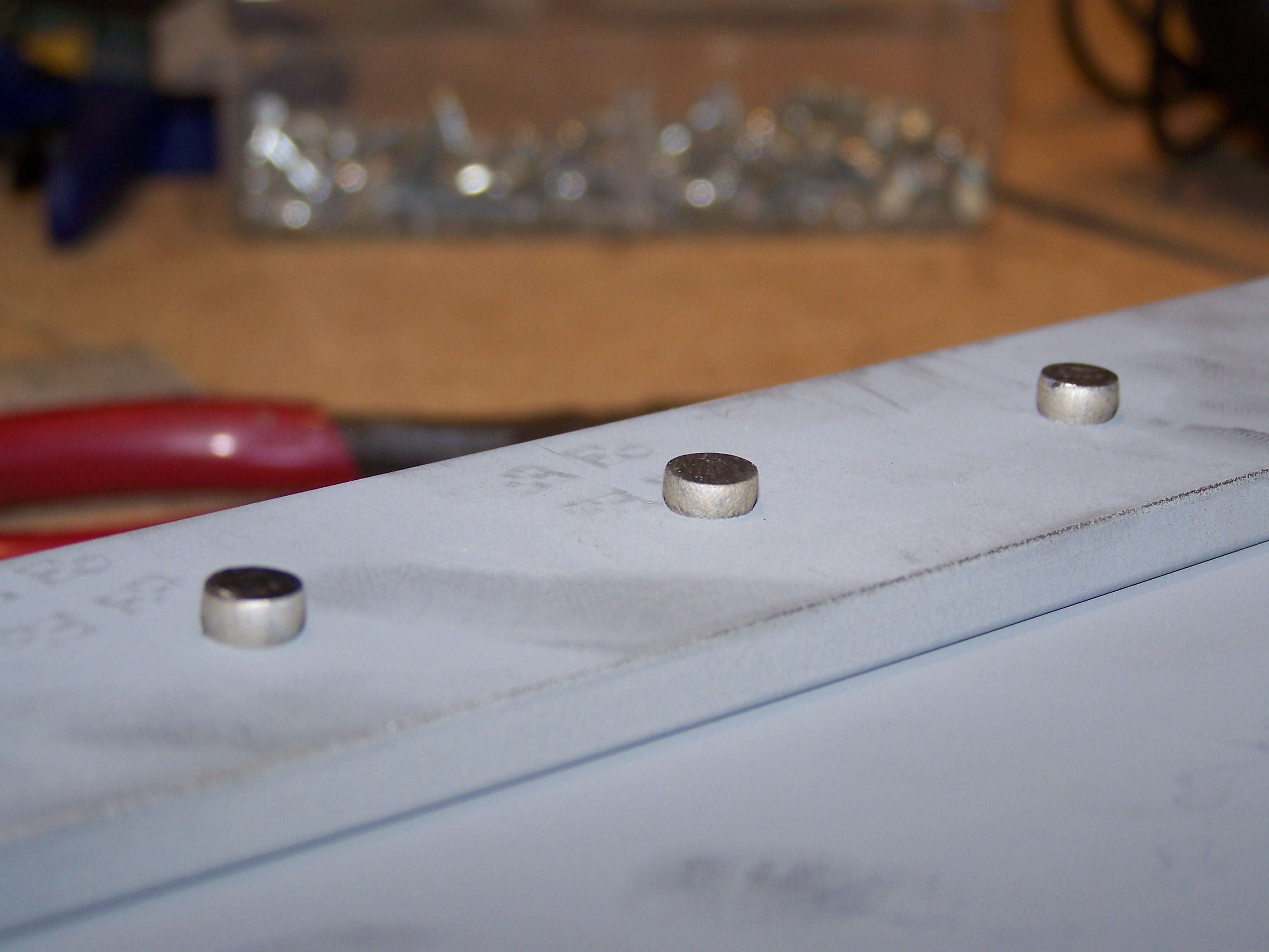

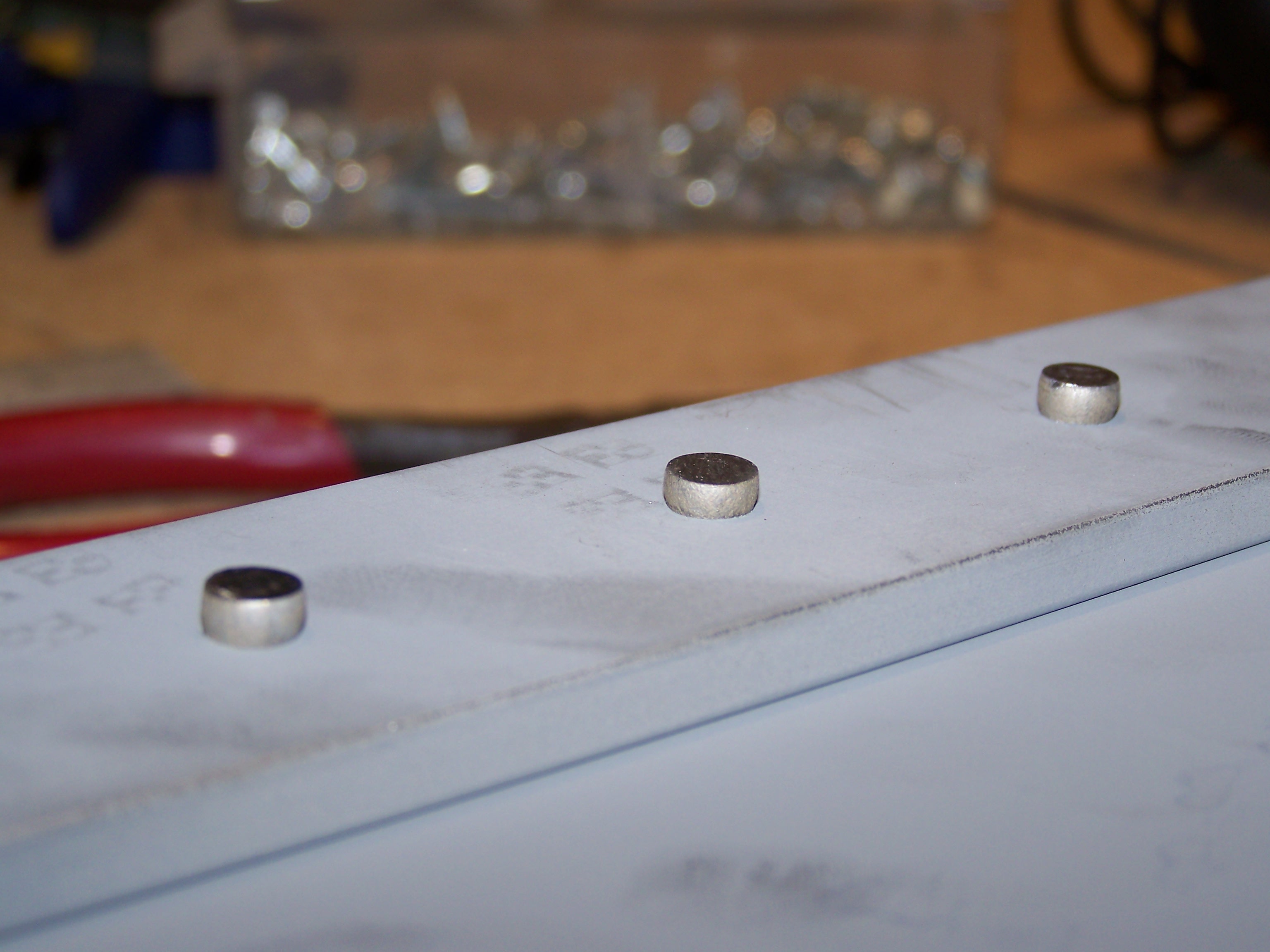

Picture's worth a thousand words. Here's a few thousand words. Most come to about .262. A few are up to .274 as seen and a picture of one of the bad ones .249, plus a side shot of the rivets for inspection of the heads. I placed a rivet on top in the pix to see the shank of the original rivet (.187). The holes have been reamed to .1895.
I can go back and try hitting the not so good rivets again, I just don't want to work harden it too much and make it weak. Is it possible to heat treat them to get rid of some of the hardness, and them hit them again?

They actually look good. I still suspect both of my earlier observations. The minimum hole ream size should be 0.191 for a 3/16 AD driven rivet so the slightly small bore will contribute to slightly tall shop heads.
What you have is grossly superior to the result of trying to drill out and replace the fasteners. They are probably within 5% of nominal mechanicals as is.
You can always go back and set them a little more - but they look as though you need a bigger gun or heavier bucking bar.
Keep in mind that this plane was designed to be built by amateurs - and CH is noted for making accomodations for the builders varying levels of skill.
Overall, I would not lose a lot of sleep over them. I haev seem many, many, many worse in virtually all manufacturer's products - Boeing included...

ashontz
Joined: 27 Dec 2006 Posts: 723
Posted: Tue Feb 27, 2007 5:00 am Post subject: Re: Solid riveting spar - setting solid AN6 rivets |
Thanks for the feedback guys. I think I'll leave them and maybe try to set a few of them a little more with the air hammer. The hammer may be a little anemic. But the results overall was pretty consistent. The spring set up helped alot with that. Check my website for details on that. The whole assembly sat on about 6 springs which let the rivet shophead just kiss the bucking bar. No cumbersome handling of the assembly was needed to move the setup closer to the bar as the rivet was set, just push from underneath with two fingers at first to keep the manufacturers head flush when first riveting, then once it starts to set, just push down with the rivet gun and the springs did their thing. Like I said, out of 150+, only two got messed up and that was because I goofed up with the gun briefly, once not letting go of the trigger before pulling the gun away, and once having the gun set on high for the large rivets and then forgetting to set the pressure back down and going back to doing small rivets, the gun jumped right off the rivet head. Otherwise, the other 99% look as you see them.
When I messed around trying to make a homemade rivet squeezer I did shear a few rivets with that setup, so I know it doesn't take much to mess up a rivet, that's why I'm interested to know what's best at this point for these rivets. I agree, what I have is vastely superior to trying to drill them out. If I was going to do that I'd just rebuild the spar. Wouldn't be worth it.
I may try a longer rivet, but at the same time, the set I'm getting is slightly high as it is, so theoretically, it's the right size rivet seeing as how I have more to squash down and more to expand outward. The one pictured that's set at .274, is only slighty higher than the .5 x shank spec.
