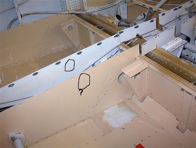

There are 2 small holes in the aft part of the tunnel that are still empty. They are located near the flap motor, near the top of the tunnel and are arranged in a vertical pattern. They show up in the plans from place to place but I can’t see what they are for. Early on I thought they would be for rudder cable guides but if they are I have overlooked installing them and they don’t seem to be lined up correctly if that is the intended use. Any help would be appreciated.

Posted: Tue Feb 27, 2007 12:49 pm Post subject: Extra Holes in Aft Tunnel |
I would need a little more detail. The rudder cable holes are in the top corners of that area, and side by side, not vertically aligned. Do you have a picture? What size are the holes? Someone with that part open will probably be able to help more.

Albert Gardner
Joined: 10 Jan 2006 Posts: 455 Location: Yuma, AZ
Posted: Tue Feb 27, 2007 1:12 pm Post subject: Extra Holes in Aft Tunnel |
There are 2 small holes in the aft part of the tunnel on each side that are still empty as I well along in construction. They are located near the flap motor, near the top of the tunnel and are arranged in a vertical pattern. They show up in the plans from place to place but I can’t see what they are for. Early on I thought they would be for rudder cable guides but if they are I have overlooked installing them and they don’t seem to be lined up correctly if that is the intended use. Any help would be appreciated.

ron.mcgann(at)baesystems. Guest
Posted: Tue Feb 27, 2007 1:36 pm Post subject: Extra Holes in Aft Tunnel |
Albert,
The holes are for rudder cable guides - See page 38-9. Installation is not mentioned in the instructions, but they are in the drawings. I have seen several web sites with these guides missing.

jesse(at)saintaviation.co Guest
Posted: Tue Feb 27, 2007 2:20 pm Post subject: Extra Holes in Aft Tunnel |
OK, now I see. Little holes, like #40 holes, on the side of the tunnel, not on the bulkhead. They are being riveted in the attached picture. The part is F-1016H and can be found in the plans on page 38-9.

Albert Gardner
Posted: Tue Feb 27, 2007 2:25 pm Post subject: Extra Holes in Aft Tunnel |
OK, I’ve attached a pic and circled the holes in question.

rvbuilder(at)sausen.net Guest
Posted: Tue Feb 27, 2007 4:58 pm Post subject: Extra Holes in Aft Tunnel |
Yep, one of those sites would be mine darn it. Nothing worse than having everything all hooked up and realizing you forgot them.

CJohnston(at)popsound.com Guest
Posted: Tue Feb 27, 2007 6:20 pm Post subject: Extra Holes in Aft Tunnel |
Hahahaha. It’s funny because those little aluminum pieces for the snap bushings are the ONLY pieces in my entire aircraft that weren’t primed with AKZO primer because it was late, and I discovered it as you did in the plans picture only, and I had already run the cables, so I cheated and shot it with a lesser rattle can primer. The only grey primer on the aircraft. Probably one for the gotcha page.
Posted: Tue Feb 27, 2007 6:41 pm Post subject: Extra Holes in Aft Tunnel |
They almost 'got' me (and Tim O) too - see <http://www.myrv10.com/tips/gotchas.html>
BTW Mine don't have the BMS 10-11 Super Anzapon green primer either - they have rattle can grey
