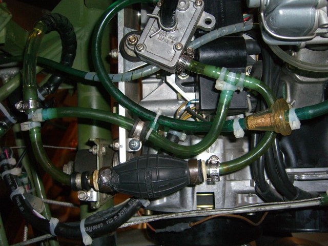

blackbird
Joined: 10 Jan 2006 Posts: 51
Posted: Wed Feb 28, 2007 6:45 am Post subject: Re: Primer versus Choke? |
Ok guys,
Would you plumb in the primer "tee" before or after the squeeze bulb?
Also, on my Kolbra would you run the primer to the cockpit or underneath the engine?
Really don't like the fuel up front with me........
Your thoughts....
Wayne
_________________ Wish I lived in the American REPUBLIC!!! |
| Back to top |
David.Lehman
Joined: 10 Jan 2006 Posts: 265 Location: "Lovely" Fresno CA
Posted: Wed Feb 28, 2007 7:18 am Post subject: Primer versus Choke? |
Picture's worth $.02 of words...
DVD

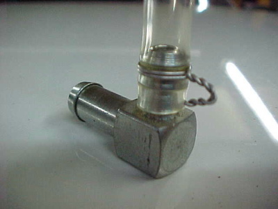

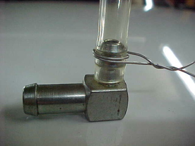

Richard Pike
Joined: 09 Jan 2006 Posts: 1671 Location: Blountville, Tennessee
Posted: Wed Feb 28, 2007 8:06 am Post subject: Re: Primer versus Choke? |
Really nice arrangement David. Let me throw in my $.02 worth - I am not all that crazy about tie wraps as fuel line clamps, I really prefer something that will clamp the tubing in such a way that the soft tubing is pushed extra snugly around the barbs of the fittings. I am not convinced that tie wraps will do this, and I am convinced that most hose clamps do not apply even grip pressure for the full circumference of the tubing.
Here is what I use instead of either of them, details on this page:
http://www.bcchapel.org/pages/0003/pg13.html

David.Lehman
Posted: Wed Feb 28, 2007 8:23 am Post subject: Primer versus Choke? |
Richard, I totally agree...
The tie wraps are on their way out... My whole fuel system is safety wired except for that area, which I need to change (most of it was plumbed before I bought the engine)... The plane's in my garage this week so that I can finish up my Navman installation and get flying Saturday...
Thanx for the advice...

At 10:18 AM 2/28/2007, David Lehman wrote:
| Quote: | Picture's worth $.02 of words...
Looks like a neat installation. Only thing I don't see is how the bulb can
draw anything from the tank unless the bypass line is pinched off... is
that what you do?
-Dana
Ever notice how fast Windows runs? Neither did I.
| Back to top |
David.Lehman
Posted: Wed Feb 28, 2007 10:28 am Post subject: Primer versus Choke? |
Dana...
It's magic...
Seriously, I agree it shouldn't work without pinching the bypass line, but... Apparently the bulb produces more flow than the bypass can handle, so it still fills the carb. bowl (bowls, when I had the two carbs. installed) without pinching the bypass line...
DVD
On 2/28/07, Dana Hague <d-m-hague(at)comcast.net (d-m-hague(at)comcast.net)> wrote:[quote] --> Kolb-List message posted by: Dana Hague <d-m-hague(at)comcast.net (d-m-hague(at)comcast.net)>
that what you do?
-Dana
_________________ ô¿ô
"Both optimists and pessimists contribute to the society. The optimist invents the aeroplane, the pessimist the parachute."
--- George Bernard Shaw |

Re: safety hose clamps. I've used soft copper instead of
steel...won't cut fuel line, and easier to use on smaller lines. Fire
away, gridleak.

Ok,
The primer "t" goes after the squeeze bulb.......CPS says it must be mounted in the horizontal position.....New issue..
What about the primer in the cockpit...............any thoughts?
Wayne

Posted: Wed Feb 28, 2007 1:47 pm Post subject: Re: Primer versus Choke? |
I used to have my primer ..."T'd" in my fuel line....
Just thought that was a bad idea....So it has it's own pick up tube from the fuel tank now.....
Gotta Fly...
Mike & "Jaz" in MN
| blackbird wrote: | Ok,
Wayne |
