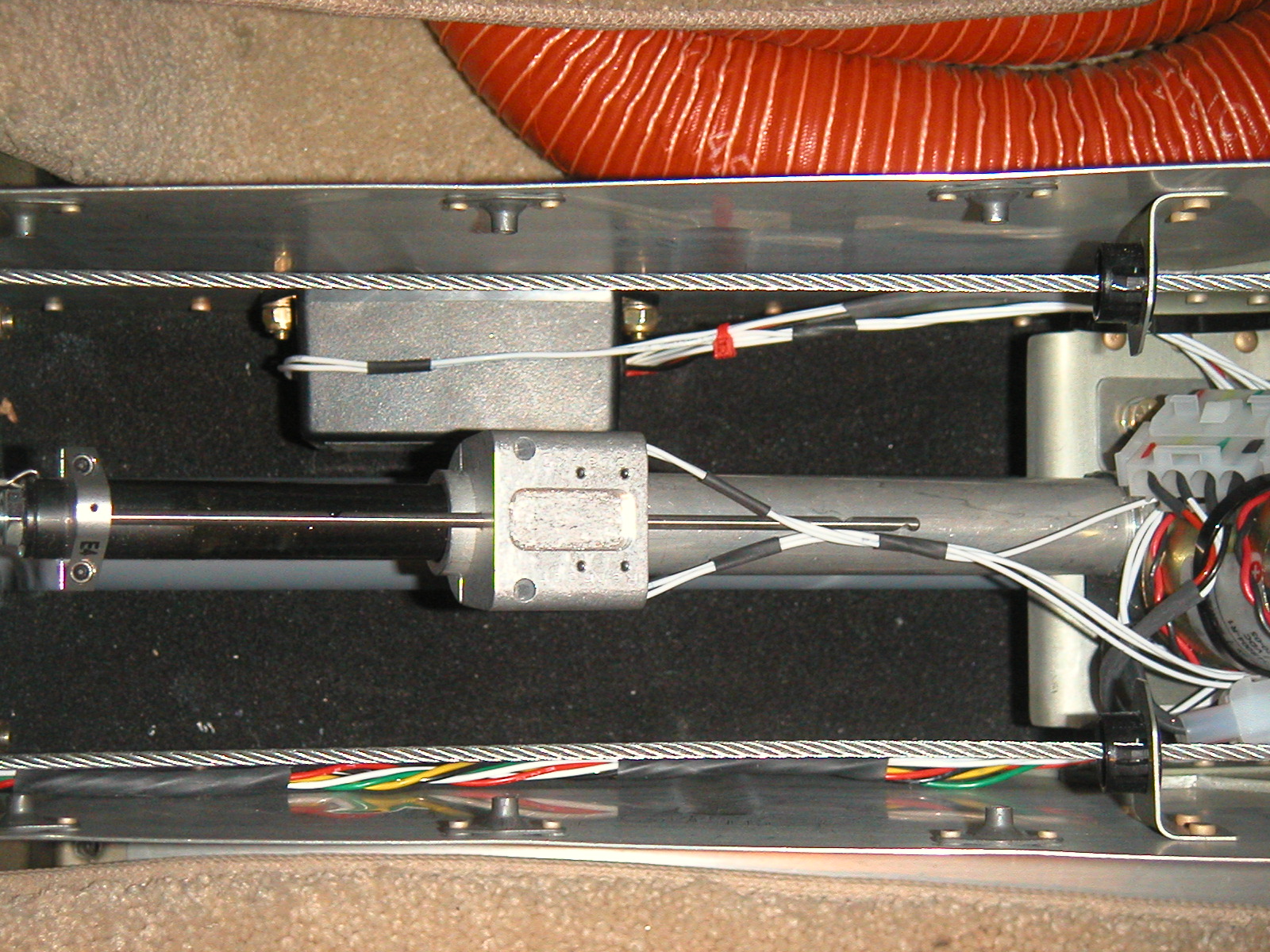

I’m looking for pics and ideas on how folks have mounted the control box for the one-touch flap positioning system.

Rob here's a couple of pics.
http://deemsrv10.com/album/Sec%2040%20Flap%20system/slides/DSC03045.html
and
http://deemsrv10.com/album/Sec%2040%20Flap%20system/slides/DSC03047.html

Deems,
We did ours the same way on one and I think that's the best place. On one
we cut the wires and extended them and mounted the box on one of the gear
leg supports under the front seat. This was a pain and not worth it.
One thing I noticed on yours is the loop of wire going into the back of the
controller box is pretty close to the nut on the flap tube. Make sure you
have plenty of clearance so that bolt doesn't catch the wire when it turns.

davelammers(at)mchsi.com
PostPosted: Thu Mar 08, 2007 7:17 am    Post subject: ShowPlanes Flaps Reply with quote
Rob,
Inside the tunnel, on the left side tunnel sidewall, adjacent to the actuator. Pix attached. Plenty of room there, and the wire runs are short. Requires quite a bundle of wires going back to the switch. I color coded them, twisted and routed them under the flap torque tube cover and up the sidewall to the switch and used a molex connector as a maintenance break (in case any components need to be replaced).
Dave Lammers
