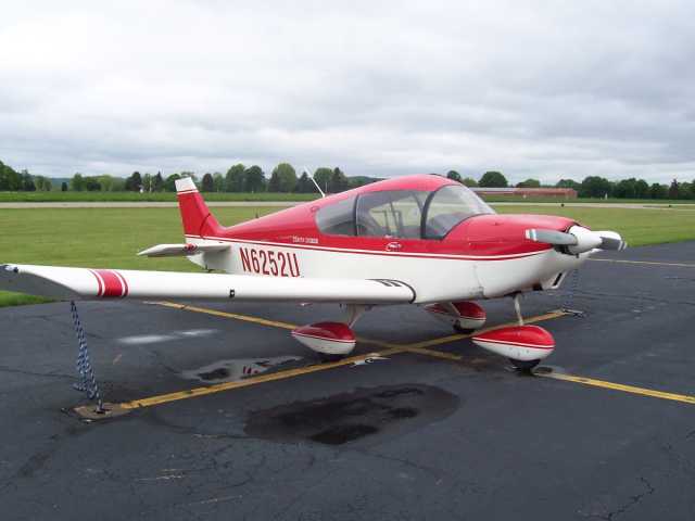

Dave, to what extent can the canopy be changed and still be registered as a 601XL? I'd love to have a Piper Cherokee style canopy, actual hardtop with doors. Or even like the CH2000. The roofline on that basically extends all the way back to the tail instead of a bubble canopy. Otherwise, the fuselage looks a lot like the 601XL.
[quote="planecrazydld(at)yahoo.co"]I posted this question a while back and got a few very vague responses but no leads I could follow up on. Does anyone know of someone trying to match a RV6/7 canopy to the 601XL fuse?
The planview fuselage width distributions between the two planes, while similar in overall width, have substantial differences in terms of wherer the maximum girth point occurs and also in the direction of taper.
I bought the RV study plans so that I could develop CAD models of both installations and see what the specific sticking points would be but have not done that yet.
I realize that the after fuselage upper frames and skins will be reshaped and raised a couple of inches to execute this change. I called Zenith and they told me that the XL has, if anything, more than adequate directional stability/control and that the increased height and more squared shoulders should not affect the flight behavior in any detectable way.
Any comments? All comments please? Since I am scratch building the bulk of the plane it is not an issue to develop and fabe the adaptation - if it is doable.
