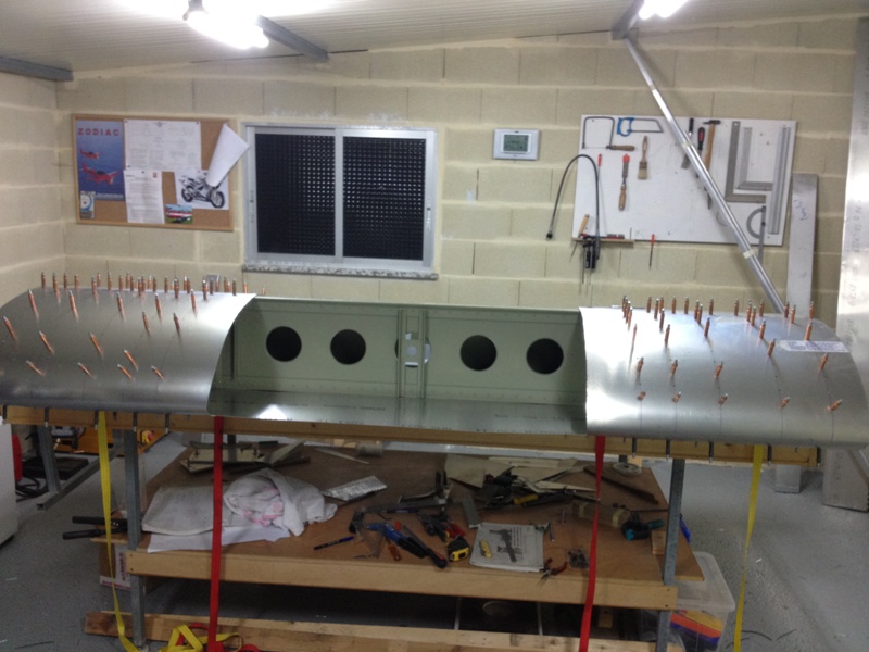

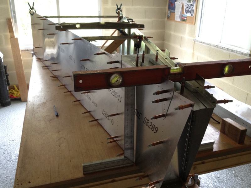

Thanks a lot for the information. I´ll order ER70 to start welding brake pedals and control bar.
Here some pictures of my progress....
My Best Regards

PostPosted: Sat Sep 06, 2014 5:33 am    Post subject: Zenith601-List Digest: 0 Msgs - 08/30/14 Reply with quote
Beautiful work Marcos,
The 601 is a great project that satisfies during the build process.
If my website can be of any assist in your fabrication process,
do visit and send questions if needed.
Best regards,
Larry McFarland
