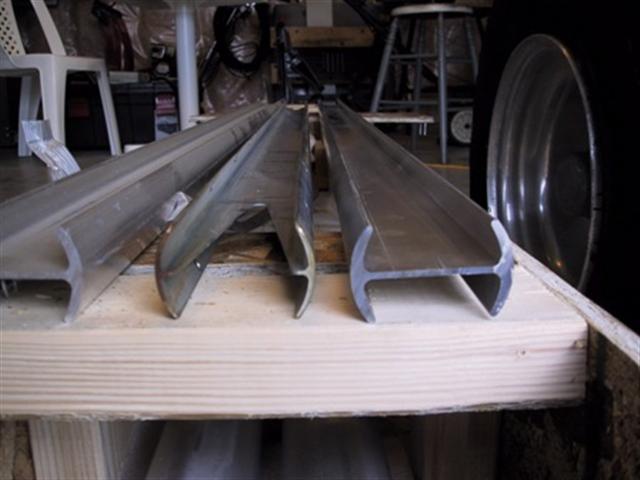

Here is a close up of the insert end on.
Are the inserts still good? The one you show appears OK. Couldn't you re-use them? (The old holes don't matter.)

PostPosted: Wed Sep 06, 2006 8:37 pm    Post subject: wrong photo. Reply with quote
I am surpised to see that the new inserts do not have
the "V" relief cut in each end. This "V" cut is to
reduce the sharp change in stiffness at the insert
ends, which creates stress points on the spar.
Anyone else have the inserts without the relief "Vs"?
It is new to me.
Kurt S.

PostPosted: Thu Sep 07, 2006 2:23 am    Post subject: wrong photo. Reply with quote
I believe you cut those in yourself. You definitely want them.

PostPosted: Thu Sep 07, 2006 3:25 am    Post subject: wrong photo. Reply with quote
<smokey_bear_40220(at)yahoo.com>
It is new to me.
They just came out of the crate, I'll get to that.

PostPosted: Thu Sep 07, 2006 3:29 am    Post subject: wrong photo. Reply with quote
The old insert for one side is still good, but Kitfox recommended they not be reused. There is some scratching from being pushed out. With the thicker walls I don't think the old inserts will fit the new spars anyway.

PostPosted: Sat Sep 09, 2006 6:12 pm    Post subject: wrong photo. Reply with quote
A senior moment on my part. They were already done on
my quick built wings, but I now remember the
instructions for them.
Kurt S.
