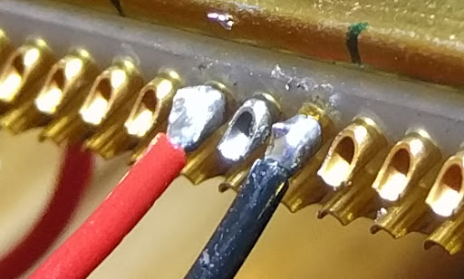

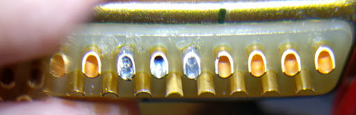

I am trying to solder 20 gauge wire into DB-25 connectors and having a tough time. The conductors just barely fit into the cups on the backs of the pins when everything is "dry," before tinning. After I tin either one, pin or wire, I cannot get all of the conductors into the cup. I end up with something like this:
[img]cid:ii_itdlrj9b0_1574f4d7e91899df[/img]
I'm afraid that those are not acceptable. What do you think?
If they are not acceptable, what is the solution? Can I trim a few conductors away so that the remainder will slip into the cup? Or should I just give up and switch to crimp pins? Or what?
    -- Art Z.

To me they would be acceptable but there should be some more solder on each pin, so that the solder surface tapers smoothly.

Be careful about dry joints, the solder should be bright and shiny all around
the joint. If the wire is carrying just signal, clipping a strand or two should
be fine (with adequate strain relief). Power carrying wire demand more
careful consideration about potential resistive heating and voltage drop.
What I see missing in your picture is heat shrink tubing on each wire
pushed all the down to the connector's insulator block. I'll
assume it is not there just to illustrate the solder joints clearly.

Do you really need 20 gauge? 22 or even 24 will do for many avionics. If the diagram calls for 20, I'd clip off a few strands. It won't change the wire resistance measurably and if it did, the D-sub acts as a heat sink.
BTW, i would rather solder than fiddle with crimp pins. I tin the cup, tin the wire, then touch the side of the cup with the iron while gently pushing the wire into the cup. It normally slips right in. You must hold your tongue properly, of course. Smile
-kent

You and everyone else who hasn't spent a lot of time practicing soldering them. Two choices. Keep trying until you get it right or my favorite:
Get rid of the solder connectors and order some crimp ones.

To tin the wire, I first clamp the stripped wire into my padded vise. After applying solder, I immediately wipe the tinned end to remove any excess solder. I use an old washcloth. Reapply heat, pinch the rag between thumb and finger around the wire and pull straight off the conductor. This should result in no stray strands and minimum solder.

Then don't 'tin' them first. In my Shop Note for dealing
with solder-cup d-subs, I suggest tinning before dropping
it into pre-filled cups. With 22AWG, the fits are not so
tight and the process works well. When the stranding is
tight, as with 20AWG, it's better to dry fit then solder.

. . . which is easy to achieve with 63/37 solder featuring
quality flux.
be fine . . .
I've attached 18 AWG wires to solder-cups by trimming
back excess strands. This was a system with long runs
of wire where voltage drop was an issue. There are
companies that make special adapters to put too-large
wires into 20AWG solder-cups but trimming the strands
is more compact and works good too.
The backshell is were wire-support takes place.
Heat shrink is more of a hedge against pin-to-pin
shorts by conductive contaminants . . . a thing
that just doesn't happen in a clean work environment.
Power carrying wire demand more careful consideration
Sort of . . . but pin-to-socket interface within
the connector is the driving concern about path
resistance. 20AWG wire is 10 milliohms per FOOT,
22AWG is 16 mOhms/Ft. A single pin-to-socket
interface on a d-sub can present 3 millioms of
resistance over a millimeter. Variability in
resistance between pin-to-socket interface within
a connector gives rise to the prohibition for
paralleling pins to increase current handling
of any one path.
I designed and qualified a paralleled d-sub pin
process at Beech that was used in both targets
and production aircraft. This involved EXTENDING
each pin in a paralleled array with say 12" of
22AWG wire before the pin-paths were joined in
parallel. This ADDS 16 milliohms resistance to
each 1-3 milliohm pin-to-socket variability.
This 'ballasting' resistance forces the sharing
of current across an array of paralleled pins.
The short answer is that concerns for heating
due to current flow reside in the pins . . .
not the wires.

Art, if you do not have 63/37 solder of known
pedigree, drop me your mailing address and
I'll send you enough to do a handful of d-dsub
jobs . . . having a good solder is 75% of the
task, good iron is 20% thus making your probability
of success in mastering the last 5% more of
a sure thing.

Thank you for all of your advice. Last night, I did some more experimenting and achieved much better results. My solder-sucker doesn't completely clean out the old solder from the cups so I will try some solder wick tomorrow (no time tonight). I got most of the solder out, trimmed a few conductors from the wire, and was able to neatly and securing solder 20 AWG wires to pins. It was quick and I have connections that look safe and secure.

What I thought would be a simple assembly process has turned into a great learning exercise.
My 'lifetime supply' of Chemtronics wick is holding
up well so I'm out of school on current
offerings. I'll order some samples of current offerings
on 'solder wick' off eBay. It's a whole new bunch of
players since I ordered any.
art(at)zemon.name
PostPosted: Sat Sep 24, 2016 11:49 am    Post subject: Problems Soldering DB-25 Connectors Reply with quote
On Fri, Sep 23, 2016 at 9:29 AM, Efraim Otero <efraim.otero(at)gmail.com (efraim.otero(at)gmail.com)> wrote:
Art:Please send pictures so us newbies can compare… thanks for sharing!!
Efraim,
Your wish is my command Smile
Desoldering went well. Bob's suggestion to melt the solder and then wack the pliers-holding-the-connector on the workbench did the trick much better than the solder wick. I ended up with nice clean cups like this:
[img]cid:ii_ithli9ql0_1575db16d60d4473[/img]

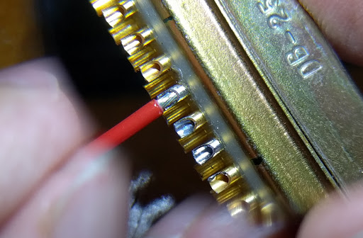

I stripped the wire to the length that would fit into the pin. Here is a photo showing the scale (I am not going to solder this wire into the pin on the end).
[img]cid:ii_ithljh8h1_1575db248f2d8d0a[/img]

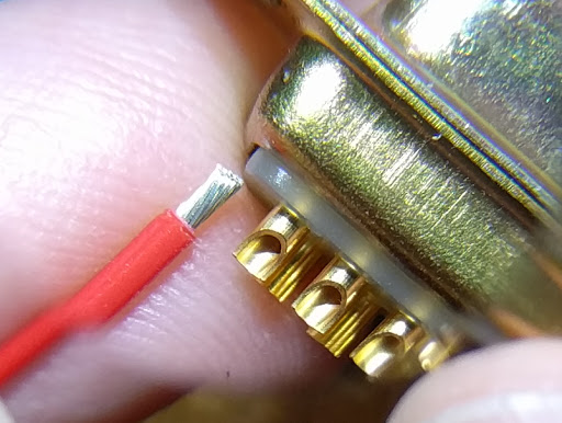

I set the wire into the pin and it stayed nicely in position all by itself, making the soldering super easy.
[img]cid:ii_ithlp7ok4_1575db6612438769[/img]

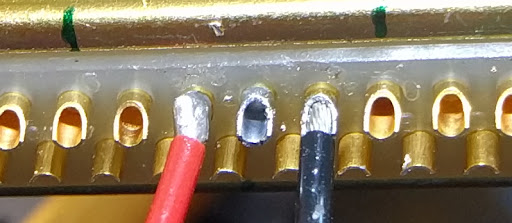

Here is a photo with the red wire already soldered and the black wire set in place, ready to be soldered.
[img]cid:ii_ithlmbyv2_1575db453e7b7502[/img]

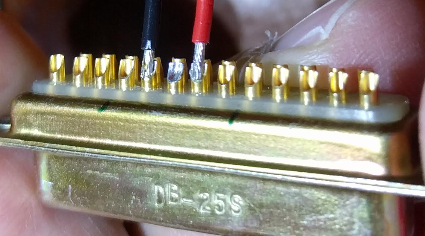

With both soldered, I have connections that please me very much. They are mechanically solid, which gives me confidence that these will last the life of my airplane. (They actually look better in real life than in this photo, which has some terrible reflections.)
[img]cid:ii_ithlos7l3_1575db61140ca845[/img]
Reinforcing my confidence in these connections, they were very quick. Since the wire set neatly and securely into the cups, total time to strip the wire, set it into the cup, and apply solder was well under 60 seconds. Previously, I had been fighting the wire and fighting with clamps to get everything to stay in position so that I could solder; it was taking me 5-10 minutes per pin with lots of do-overs.
Hat tip again to all of you who helped me. Thank you!
    -- Art Z.

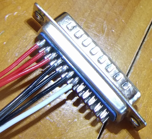

One more photo. I disassembled and reassembled the first connector that I did (more than a week ago). I am much happier with this iteration:
[img]cid:ii_iths7mqz0_1575e5d42f606419[/img]
These wires are for the pitot tube heater. It draws 12 amps so I am using three pins each for power, plus one pin for the status lamp. These three 20 AWG pigtails join to 12 AWG wire which runs the length of the wing.

You're gaining on it! My only impression now is that
I would strive for better wetting/flow in the
finished joints. Your iron temp may to too low.
It could be a solder issue too. You said 60/40 . . .
normally that alloy is quite satisfactory. Used it
the first few decades of my solder slinging career.
But I've had some 63/37 of some brands that did
not behave optimally. What brand of solder are you
using?
I'll send you some solder Monday. What kind of
iron are you using?

These joints look good. I would use 22AWG "ballast
resistor" pigtails. Here you are actually using
the wire as a resistor . . . the larger the better
from the standpoint of sharing loads across an
array of pins. Also, be aware that the legacy
heated pitot tubes have a strong temperature
coefficient. A typical pitot heater for a Beechejt
is 1.5 ohms at 0C . . . a time when the tube is
likely to be turned on. 28V/1.5 ohms is 18A start
up current. When the heater gets to 100C (typical
high altitude condition) it goes to 2.2 ohms
for 12.7A running current. 14v probes behave similarly
at about 2x the current.
What kind of probe are we talking about?
If you've lots of unused pins in this connector,
it wouldn't hurt to use 5 or 6 pins per path
and I'd certainly drop to 22AWG ballast wires.
Another thing to consider for the solder-cup
connector is the form of the female pins in
the connector . . . not quite as robust and
uniform their crimp style cousins . . . so
extra pins if available wouldn't hurt a thing.
The work we did at Beech was entirely with
crimped pins. I'm not suggesting that your
design goals cannot be met with this connector,
just that I have no experience with the parallel
pins in the commercial connectors so if there
are unused pins in the connector, bringing
them into harness with the three already in
service is not a bad thing to consider.
The extra wire is a 'sense' wire? What does
it do for you?
