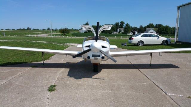

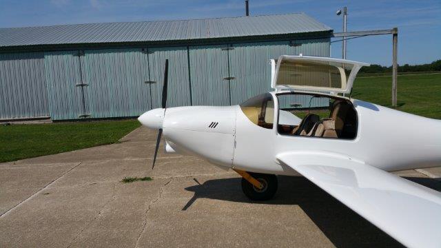

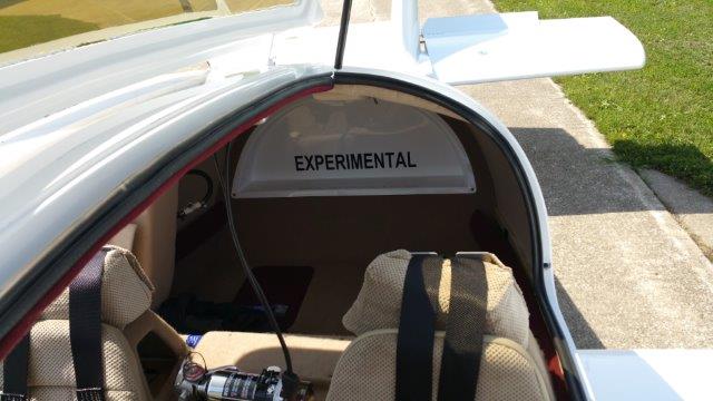

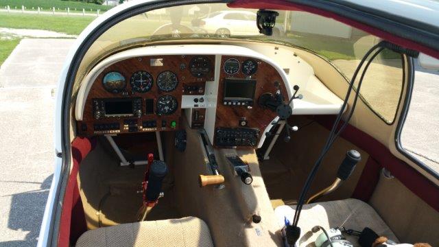

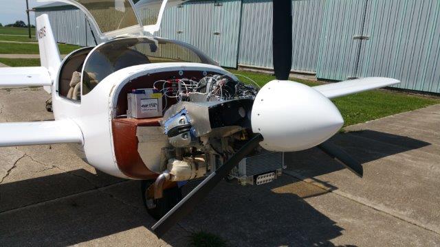

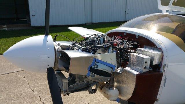

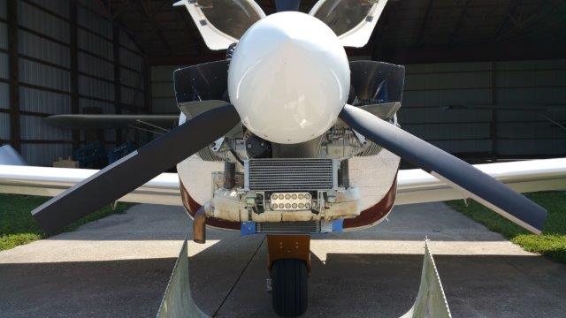

N69XS took to the skies July 4th 2015.  Overly high oil temperatures allowed only four very brief flights before I decided I needed to remake the cowling. Last winter/spring was spent doing just that.
Forward to this summer I have just recently resolved the oil temperature issue to my satisfaction, after much modification and testing.
A069 was the first XS sold. It was on display at Oshkosh. I purchased it there and trailered it home. A very, very, long time later, three moves to three different states, new homes and jobs; I finally stayed in one place long enough to finish it. I’m 11 hours into the FAA required 40 hour testing period.
The details:
Weight:   902 lbs
Engine:   BMW R1100RS 90 Hp Fuel injected, Computer controlled, Altitude compensating.
Reduction: 2.5:1 from Take Off of Germany
Propeller: Warp drive three blade ground adjustable.
