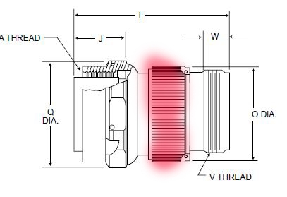

I've not encountered that particular product
before. It APPEARS to be a plastic clone of
the Mil-C-5015 connectors with roots dating
back to WWII. If so, check as follows:
[img]cid:7.1.0.9.0.20170215034727.0539fdd8(at)aeroelectric.com.0[/img]
See if there is a threaded joint under
the shaded area. Unscrew the back-shell
from the connector body. The Threaded
ring that engages the mating connector
simply floats on the housing held in
place by the back-shell.
[img]cid:7.1.0.9.0.20170215035930.05528b88(at)aeroelectric.com.1[/img]
mating
-I STAND CORRECTED -
Found a whole line of products from CNBTR that
includes some solder-cup, emulations (if not
exact clones) of a Mil-spec connector line.
I've ordered one in to take a peek
http://tinyurl.com/jdgnmtt
These are an interesting product with an
attractive price. I'm looking forward
to a closer look.

Thank you Bob,
You're right for the threaded joint under the shaded area. To unscrew the back-shell from the connector body, we must let the male part in place in the female part. You place the male part in a vise and use a vise grip to unscrew the back-shell. A particularity you unscrew counter clockwise.
Daniel
