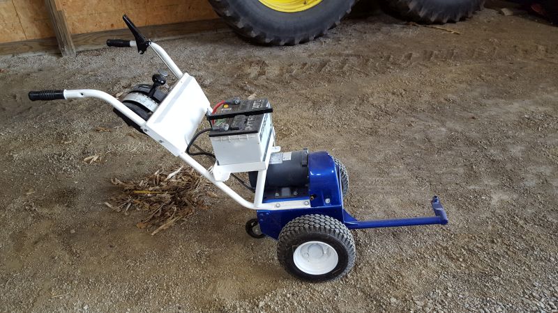

PostPosted: Sat Apr 18, 2020 7:35 am    Post subject: Aircraft Tug Reply with quote
Attached is a photo of an aircraft tug a friend built from a walk behind snow blower with a failed engine. The transmission allows speed control going forward plus reverse.
Works very well on his RV-6.
Tom Barter

PostPosted: Sat Apr 18, 2020 11:14 am    Post subject: Aircraft Tug Reply with quote
Tom,
What DC motor did he use to replace the gasoline motor?
Bill
Tom Barter
