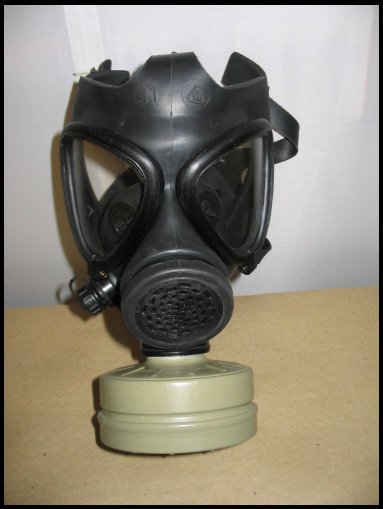

PostPosted: Sun Feb 04, 2007 5:06 pm    Post subject: epoxys Reply with quote
The best respirator I have found lies in an Israeli M-15 gas mask. You can find good deals on them and the filters on E-Bay. They are full face, comfortable, and they have a generous field of vision. I can also attach a fresh air hose to the canister area as it came with an adaptor. Just a thought.
My 2 cents on wearing protection...when in doubt...do it.
Dan,
KF-IV Building
Mesa, AZ
