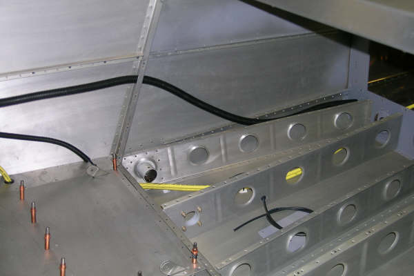

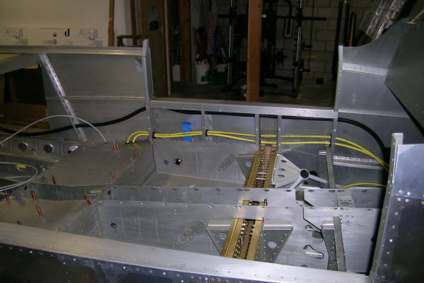

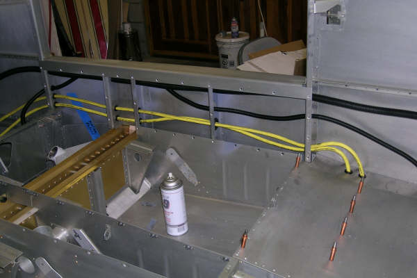

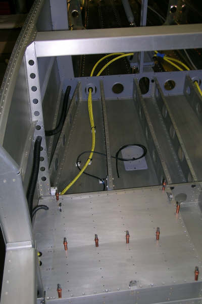

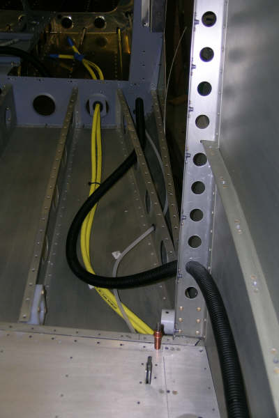

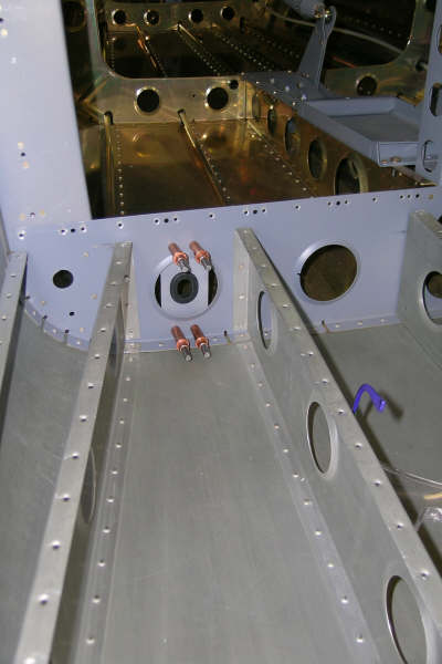

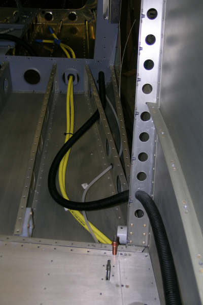

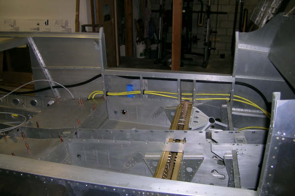

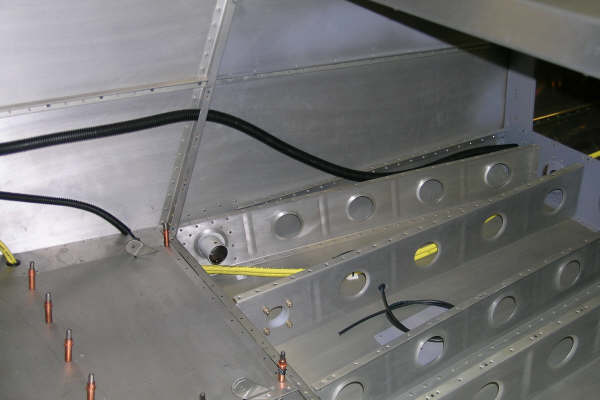

Here are some cable routing pics showing all the support to the cable. Huge
rubber grommet are used in stead of nylon snap bushings. Concern for
chaffing was very much considered.
