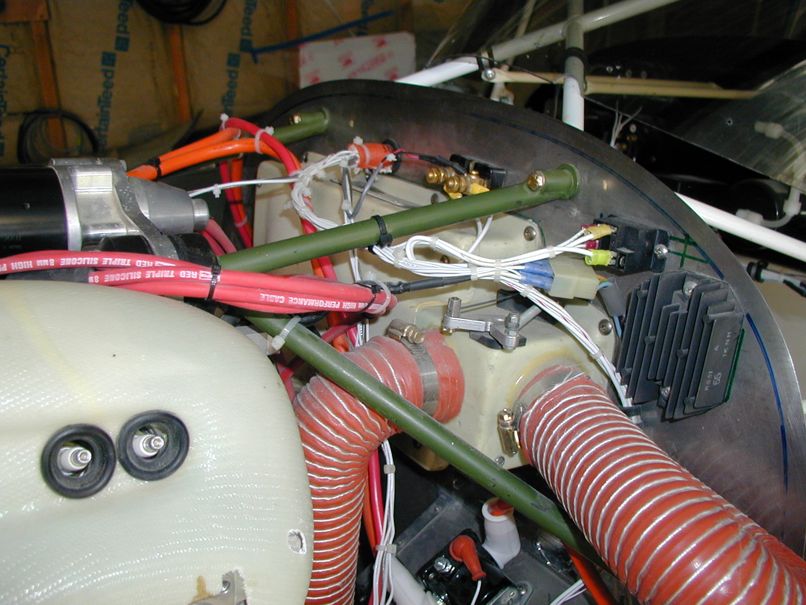

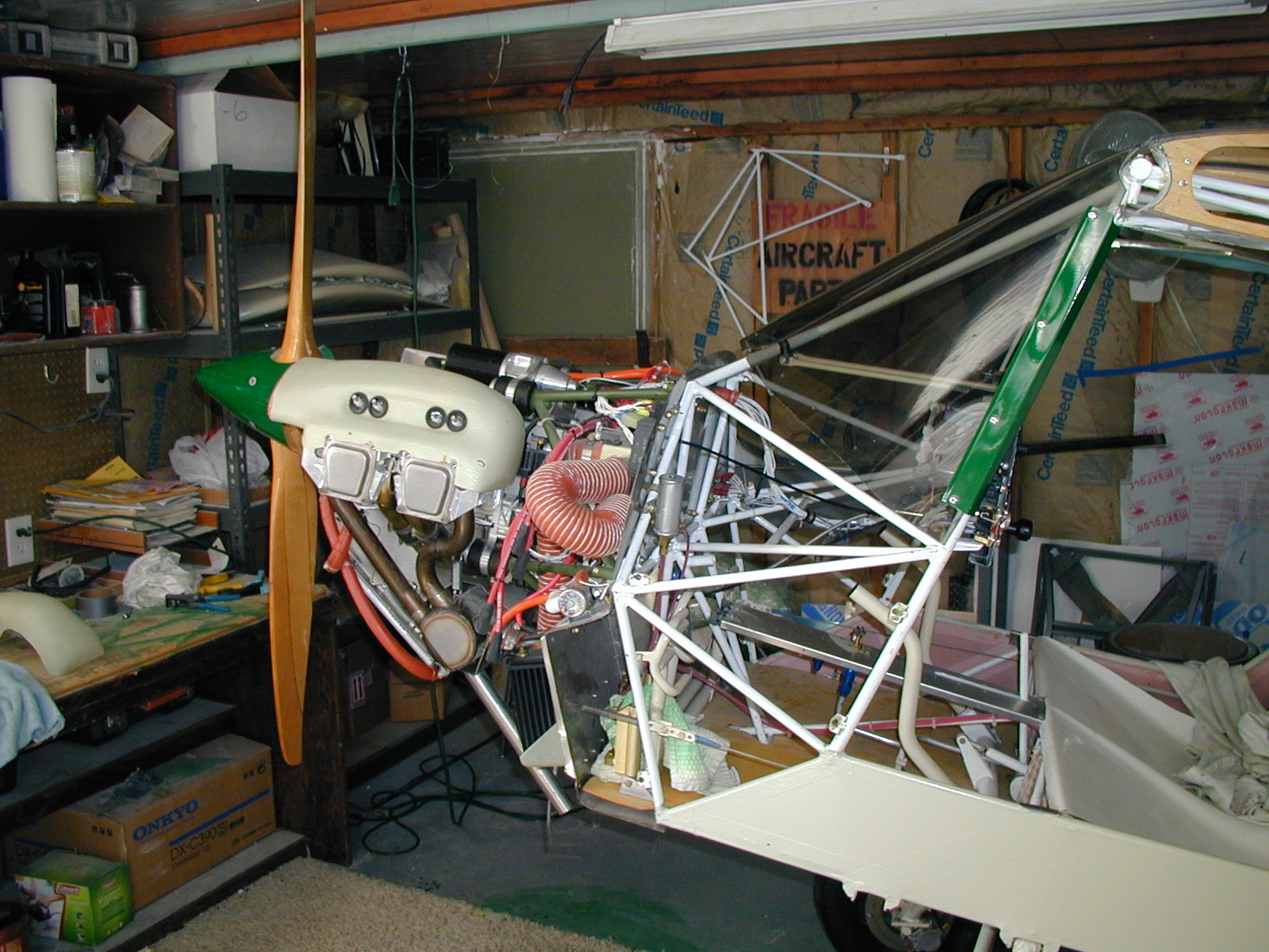

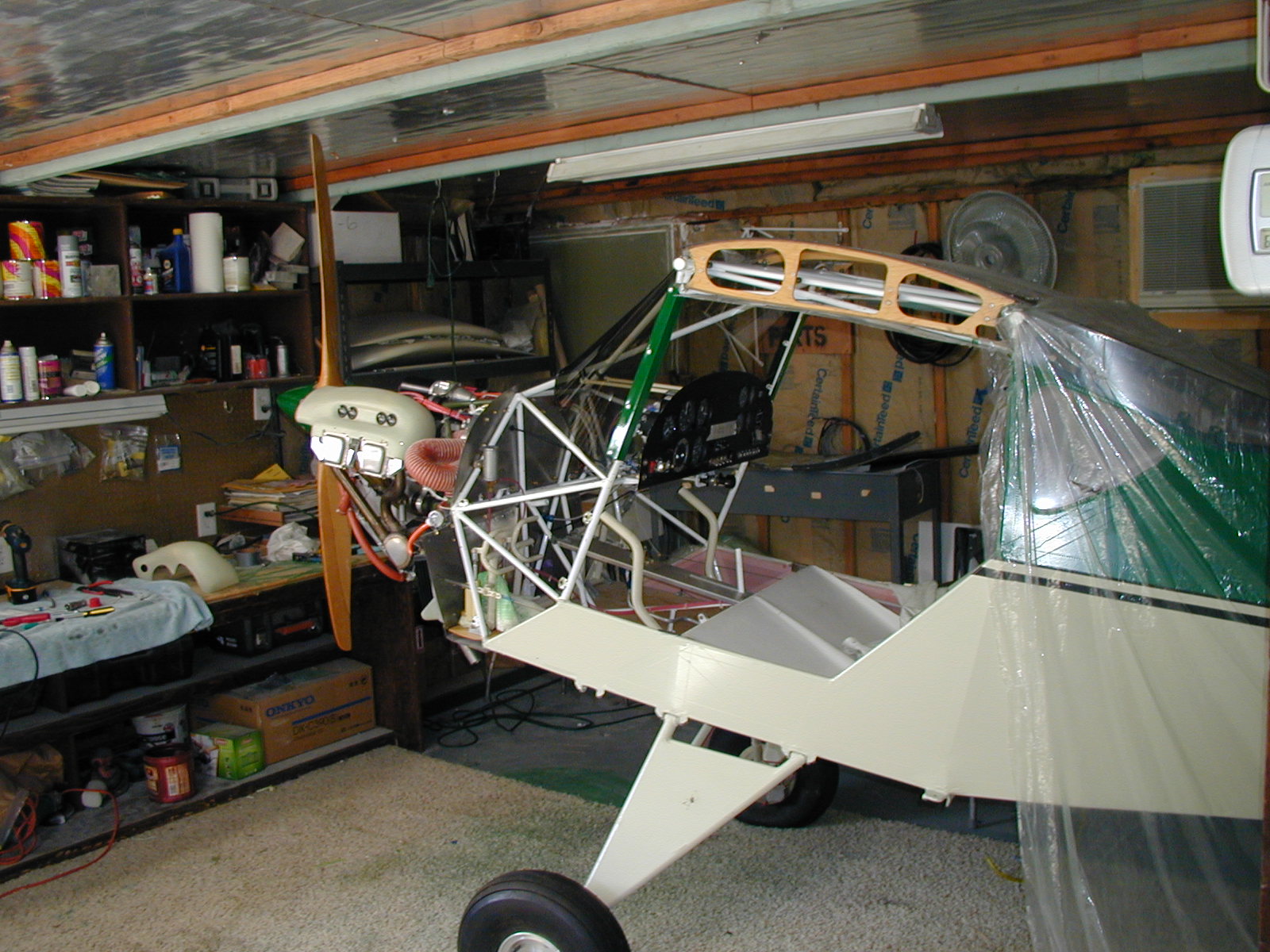

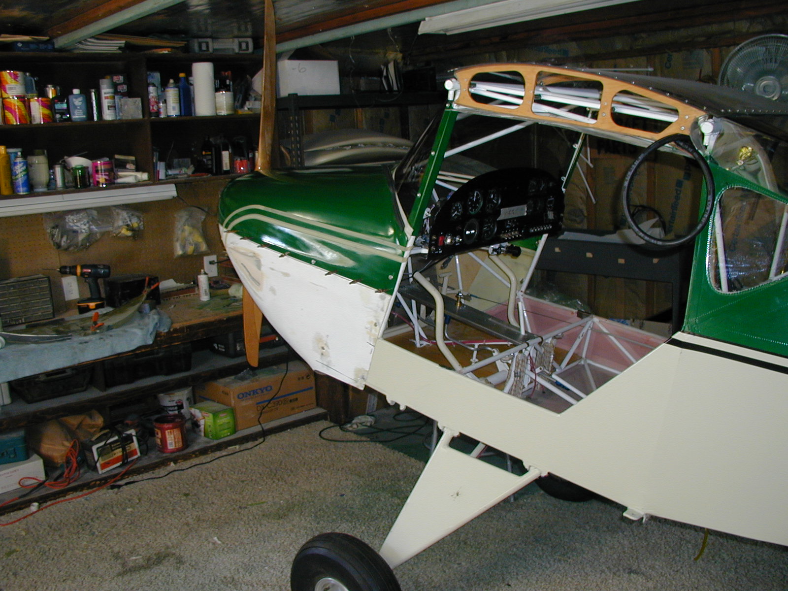

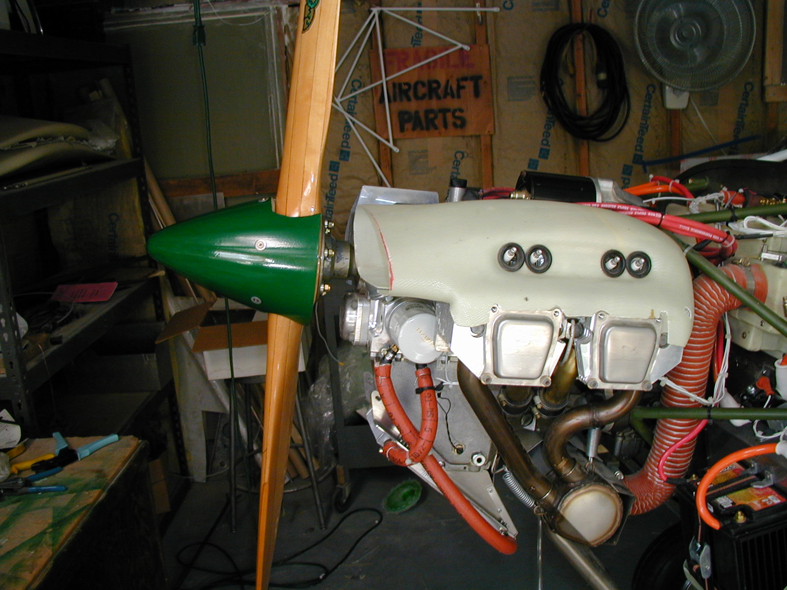

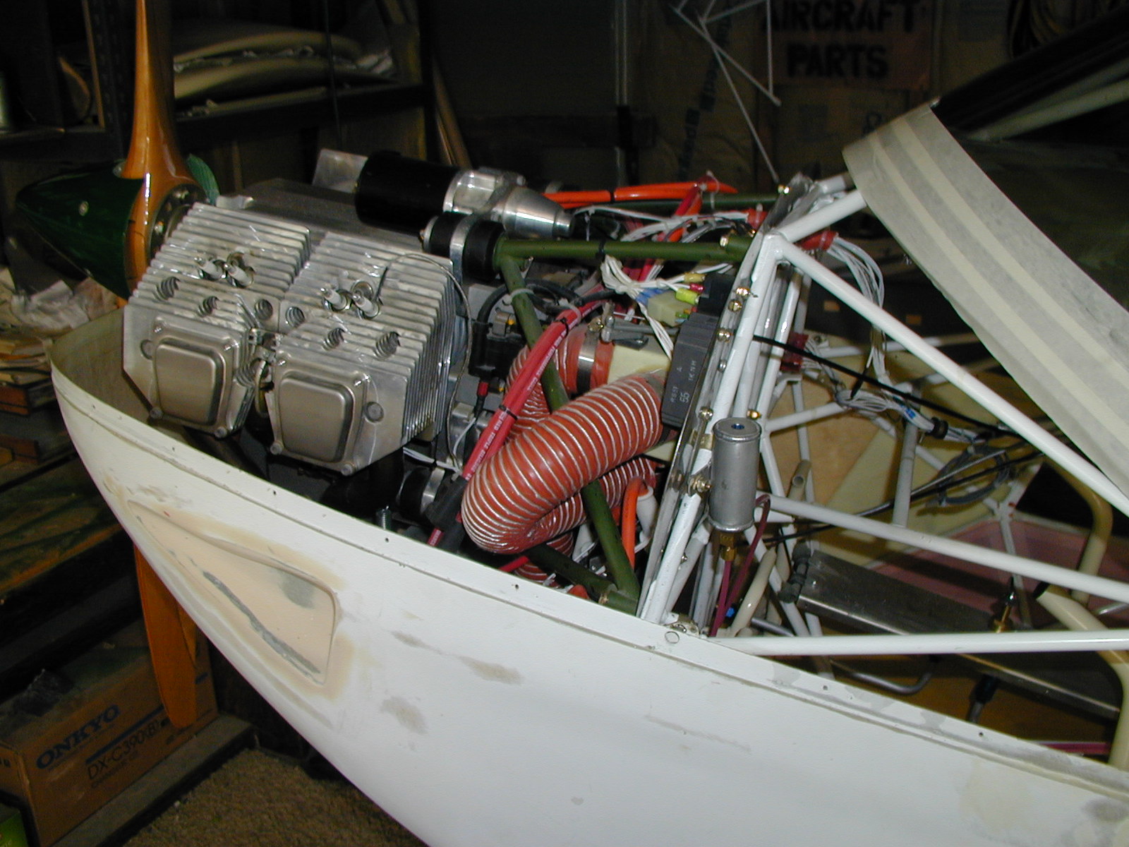

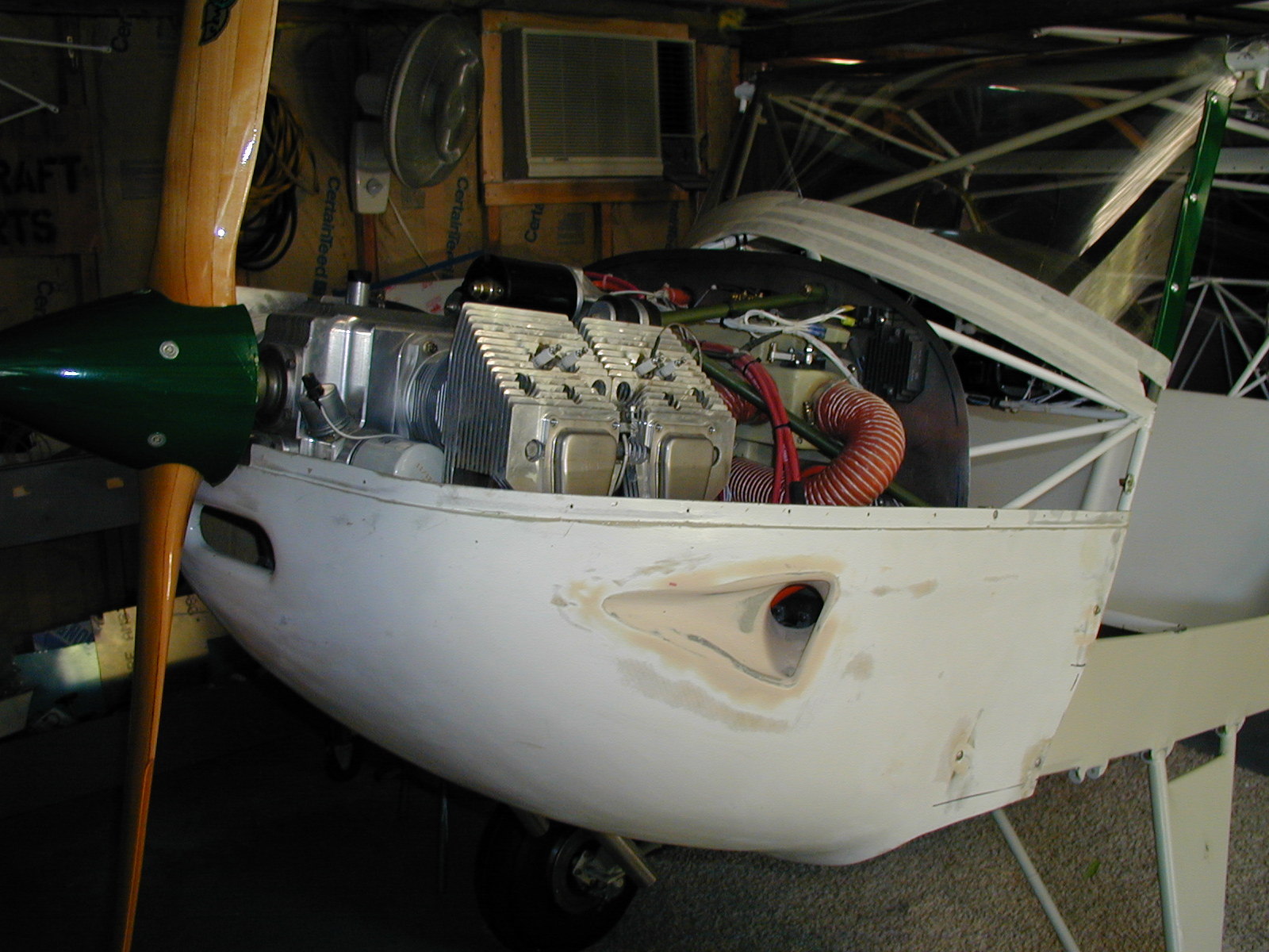

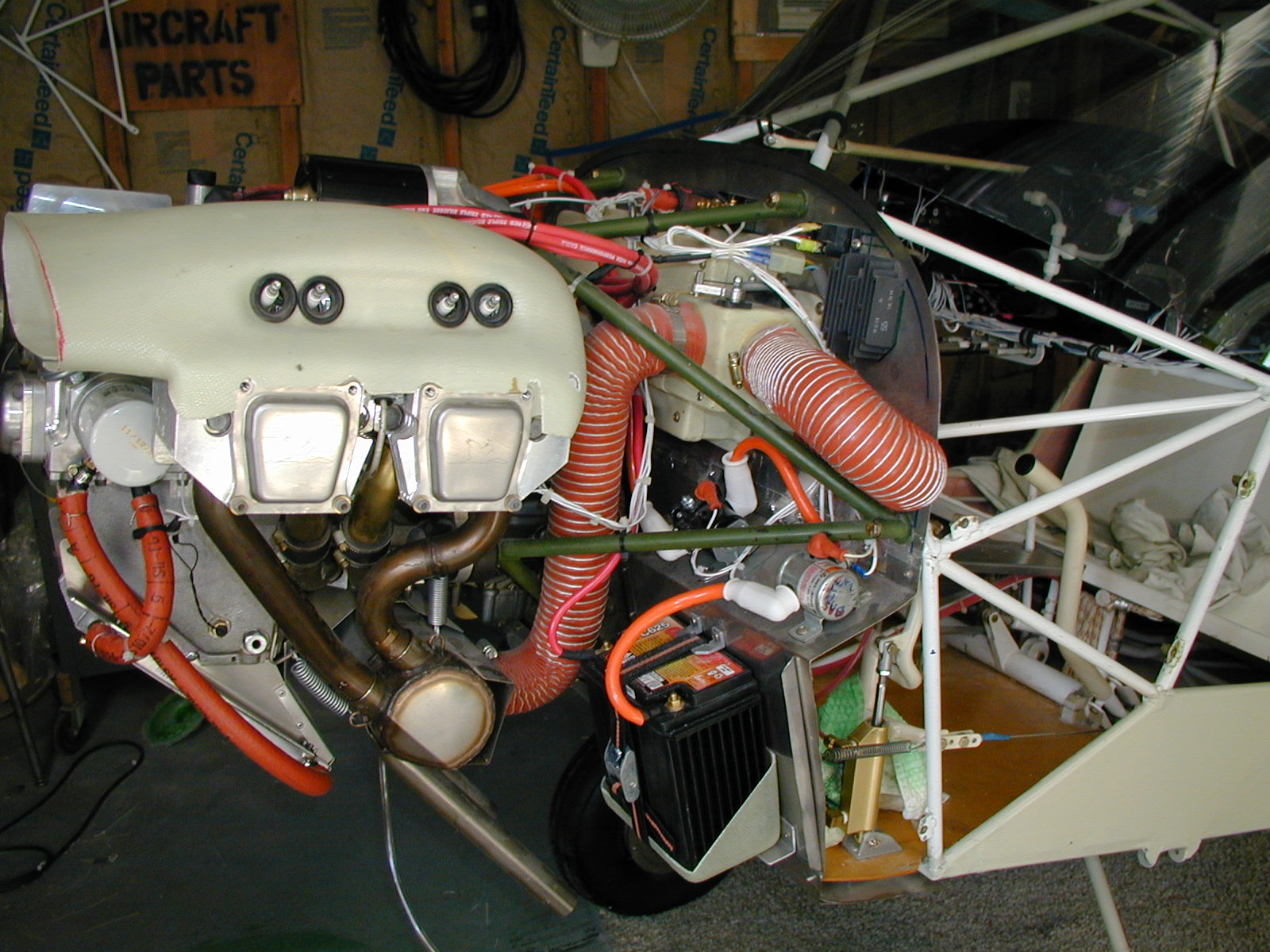

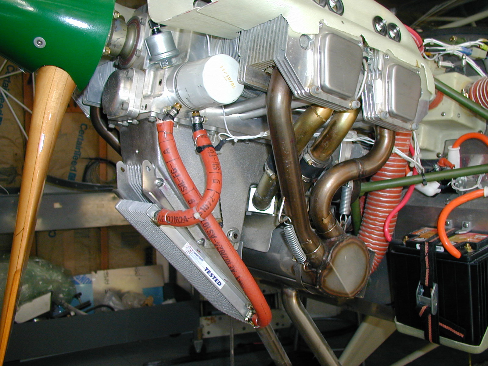

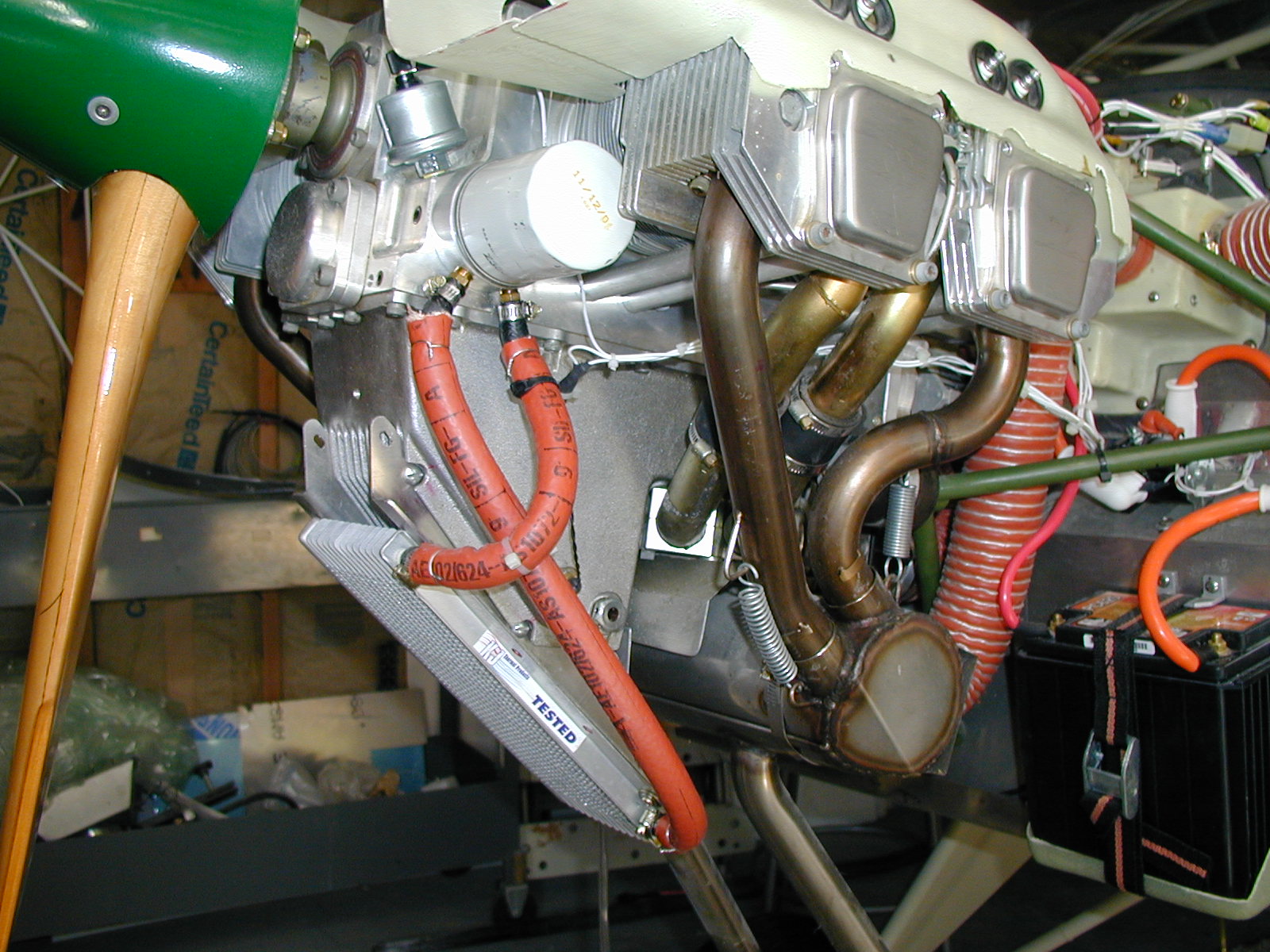

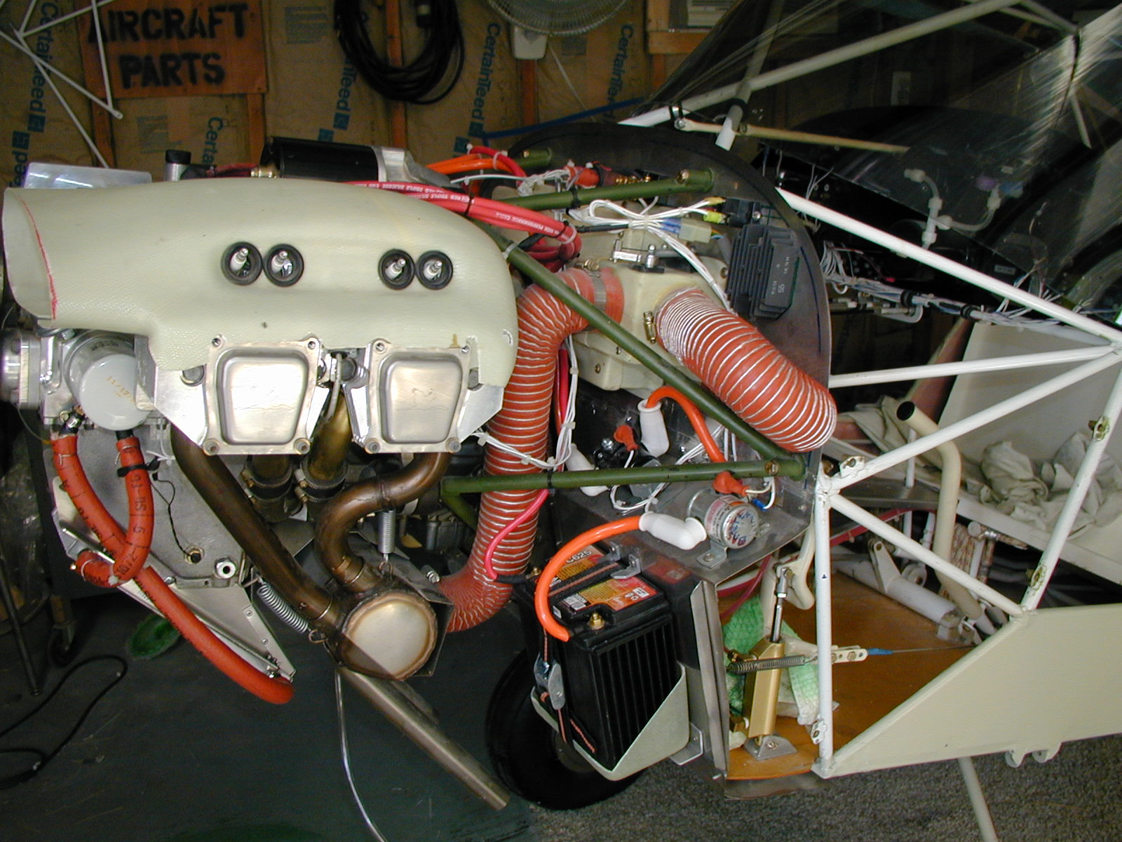

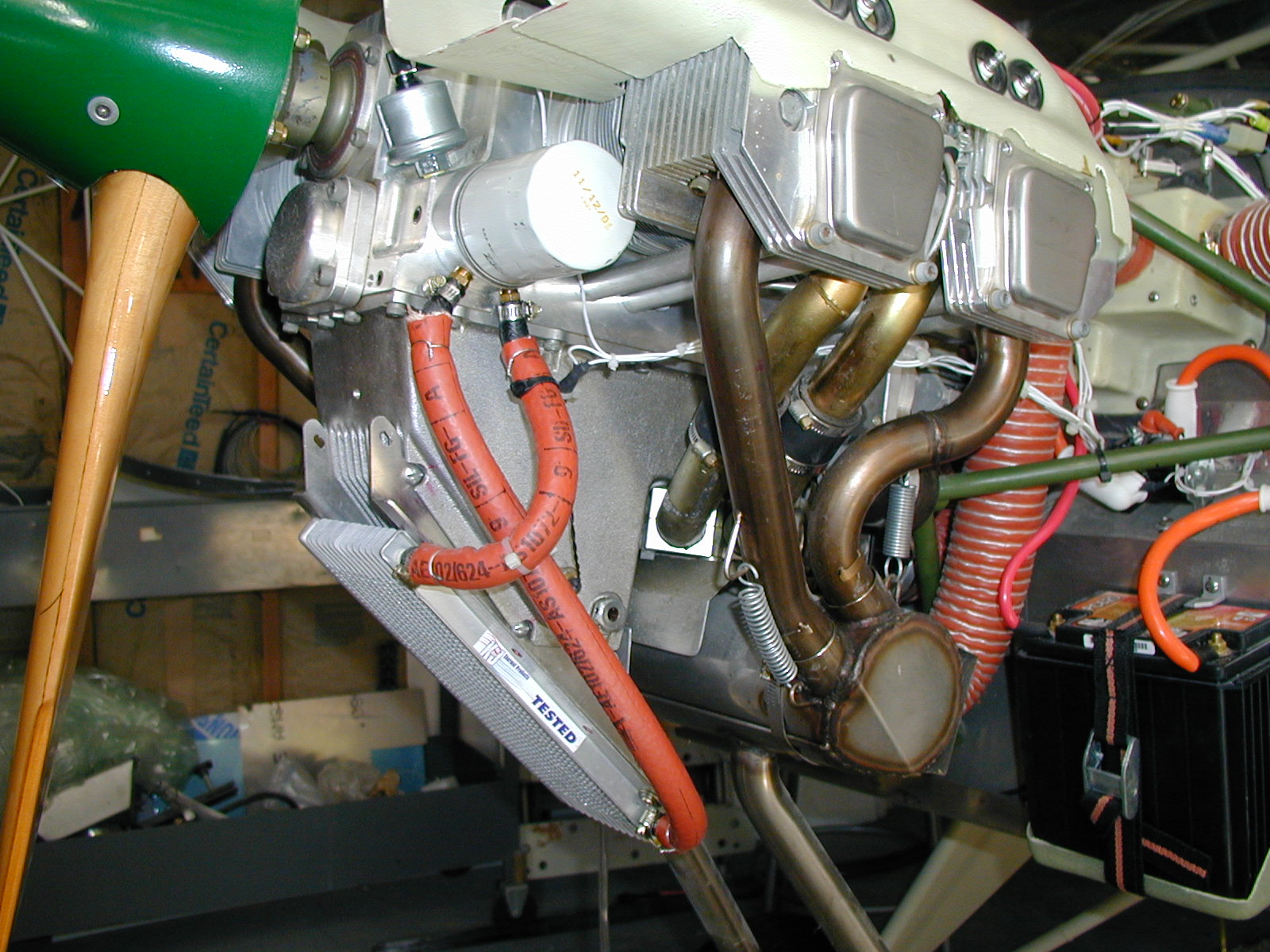

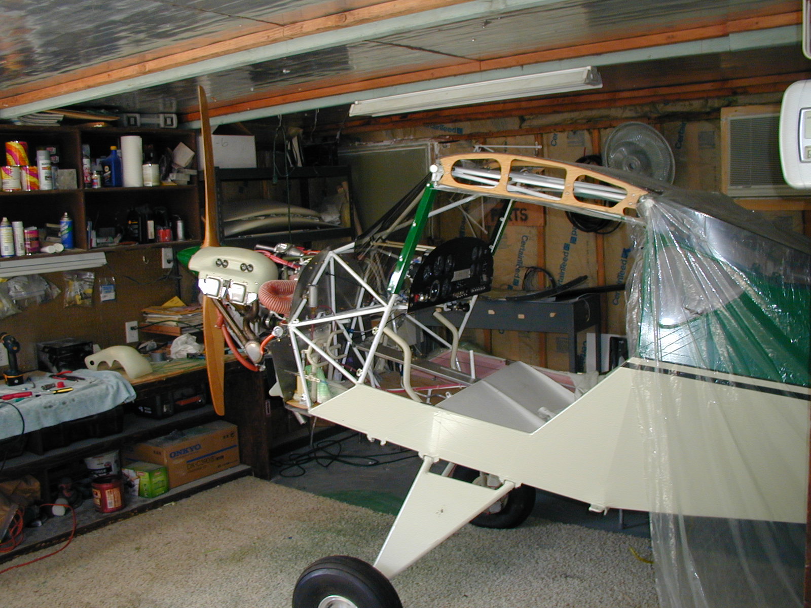

Jabiru 2200 engine install , Model IV Kitfox. Can't seem to get them on the Kitfox List Photos or the Sportflight web site, so here they are:

PostPosted: Tue Jun 12, 2007 12:22 pm    Post subject: Jabiru 2200 Install Photos (again) Reply with quote
Dan:
Thanks for the pictures! Do you have pictures of the cowling?
Jose

Yes Jose, but the cowling is not complete yet, I'll post what I have

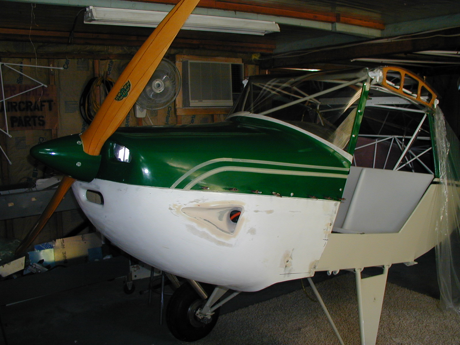

PostPosted: Mon Jun 18, 2007 8:02 am    Post subject: Re: Jabiru 2200 Install Photos (again) Reply with quote

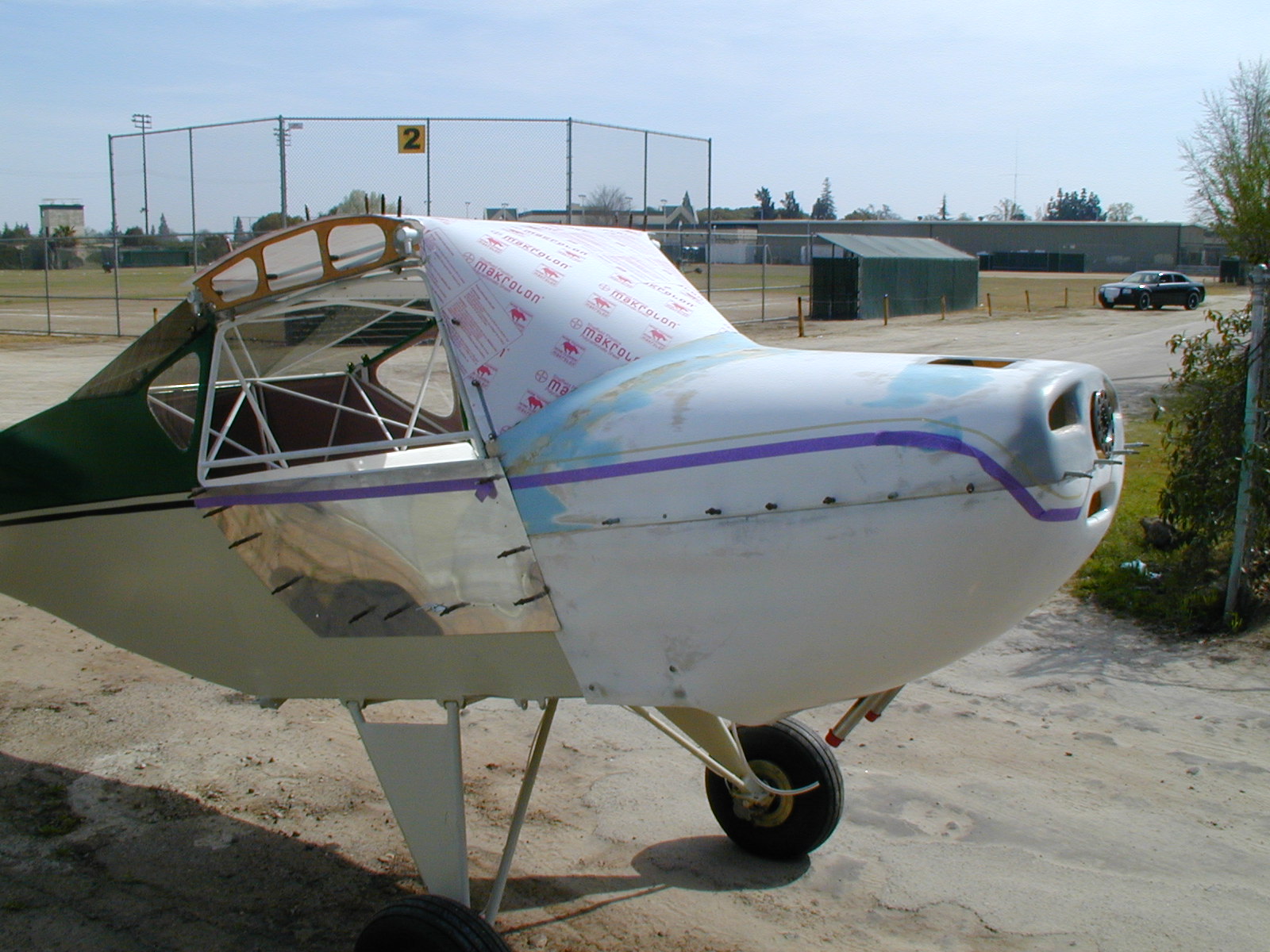

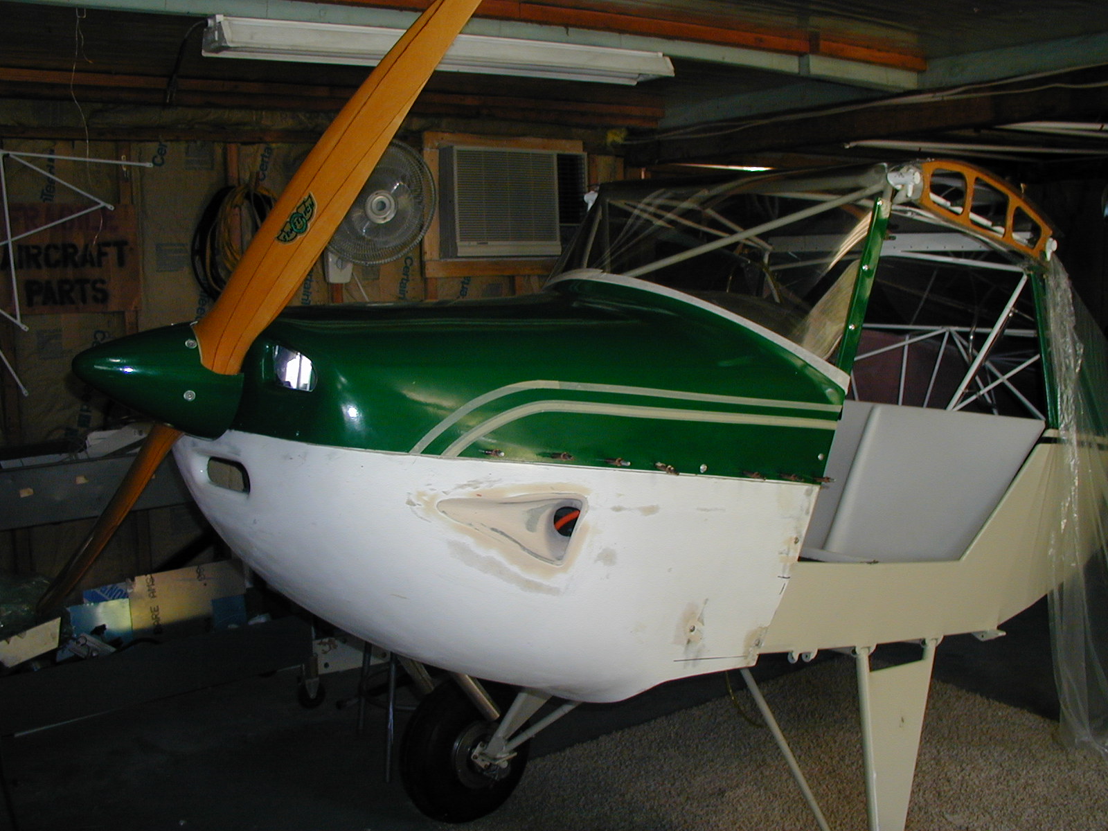

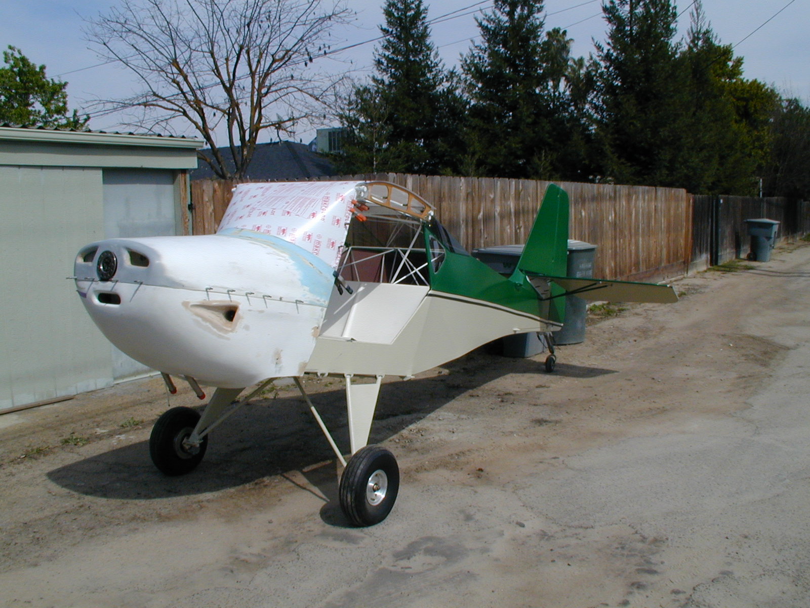

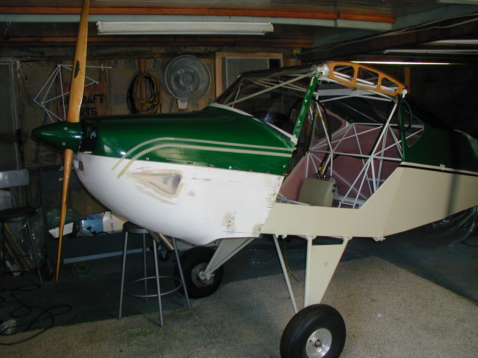

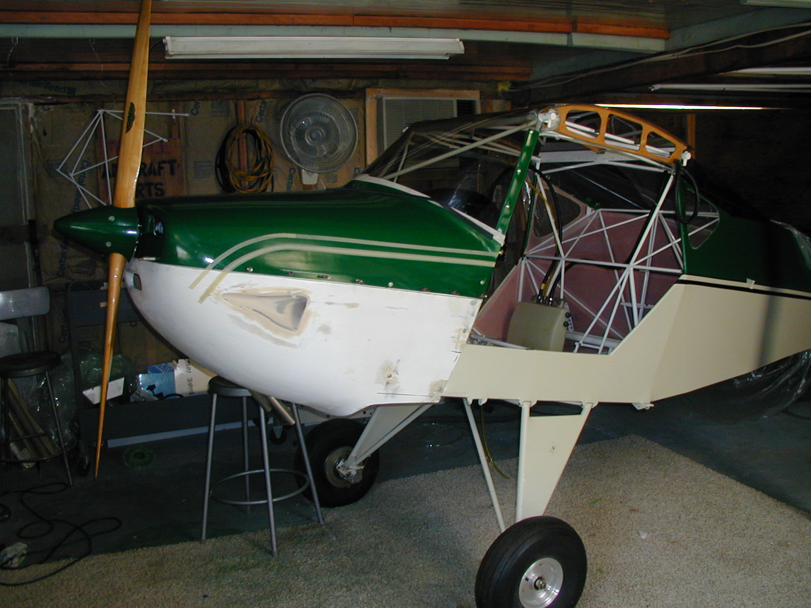

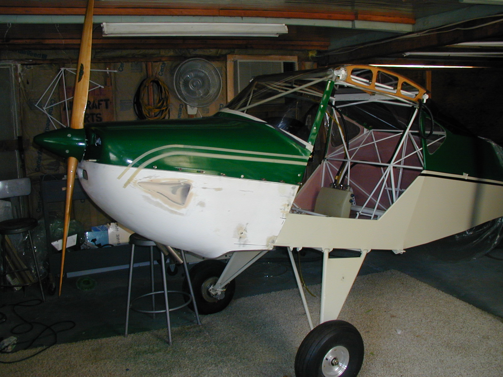

Here's some requested photos of my cowling with the Jabiru 2200, Model IV Kitfox

PostPosted: Mon Jun 18, 2007 8:29 am    Post subject: Re: Jabiru 2200 Install Photos (again) Reply with quote
Beautiful cowling. Did you make it from scratch? Is that a big job? I've never been a big fan of the round cowl but I'm reluctant to spend much time or money on a cosmetic mods.

PostPosted: Mon Jun 18, 2007 10:56 am    Post subject: Re: Jabiru 2200 Install Photos (again) Reply with quote
Luis, the cowling was supplied by Jabiru with the ffw kit that I purchased with the engine. The bottom cowl fits fine, but the upper cowl needed some modifications because it would not fit against the windshield. I had to remake the lip to match my configuration. I also lowered the instrument panel down and had to modifiy the panel dash. A lot of work but worth it in my opinion. I recieved lot of help from Dave Jalanti, who had already done the same thing. He can be contacted thru Jabiru USA web site.
I like the cowl and your installation. I have a recommendation,
though. (Meaning, I wish I had done it.) If you haven't finished the
cowl I'd replace the fasteners along the sides and front with piano
hinge the way the RV guys do. Very clean, and very easy to remove the
cowl for inspection.

PostPosted: Tue Jun 19, 2007 4:42 am    Post subject: Re: Jabiru 2200 Install Photos (again) Reply with quote
Thanks Guy for the recommendation, I will check the rv site so I see how they do it.
