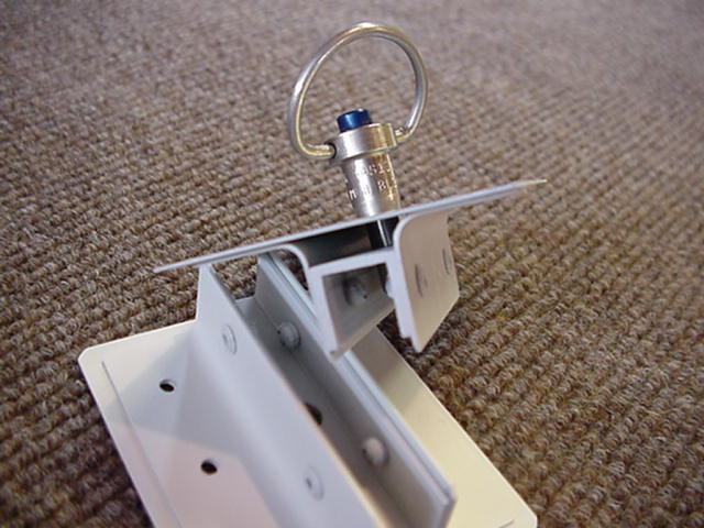

Ladies and Gents;
I just attended a seminar on how to crash your aircraft and survive. I would
recommend it to all. It did bring up some questions, i.e., Has anyone
addressed the best way to tie down cargo in the baggage area of the 601? The
rear area of the baggage compartment is hard to reach -- so the webbing
would have to be permanently attached to the tie downs??? What is the best
way to secure these tie-downs so they don't pull out of their holes upon
impact? Are there any recommended nets?

<?xml:namespace prefix="v" /><?xml:namespace prefix="o" /><![endif]--> Mack,
>What is the best way to secure these
| Quote: | impact? Are there any recommended nets?
This certainly doesn't address all your questions but here are some forward tiedowns I made on-the-cheap from rings purchased in the Osh flymart. In the rear of the compartment I have the Van's tiedowns. Both are removable but the forward ones leave a flat floor.
http://www.vansaircraft.com/cgi-bin/catalog.cgi?ident=1195078564-350-492&browse=airframe&product=tie-down
tailwinds jeff

Good question Mack. You need a net or canvas anchored into something more than sheet metal. Such as the longerons. Around the Pensacola, FL area we are able to go to any of the sail makers, etc around here and they can whip up a net that would work well. This restraint must be good for 26 G's at 40 lbs to keep a laptop or six pack from whacking you. Do you remember the "Mythbusters" episode on this? I was trained and served in this field in the military. Many civil and military aircraft have tie down rings that are 1.75 inch dia made of 1/4 inch seamless stock anchored with eye bolts. I have a dozen rings on hand, but without the eye bolts and clevis pin that makes up the assembly. They are rated for 750 lbs each, and will pull out of a sheet metal floor at about that loading if not anchored with a good backing. These are yours if they can help. I will search West Marine in town for even better hardware for my project.
Another important factor is that the shoulder harness passes through the area of the cargo restraint and would interfere. If the harness is attached behind and below the level of the shoulders, that would be bad. It must go over the shoulder, then upward at 15 to 20 degrees before attaching in the rear. This is to prevent injury in a head on. I have seen cadaver tests (leaving your body to science, are you?) that clearly demonstrate this in head on crash tests. The test subject was strapped into a pilot's seat with a 4 point restraint. Xrays showed two broken collar bones. If you can find a picture of an RV-8 pilot seat, examine this aspect for yourself.
I have some ideas for a simple anchor system, but I need to study the cockpit area when its clecoed together. Its sort of jumping of the drawings at me now but not that well yet. Know what I mean?
