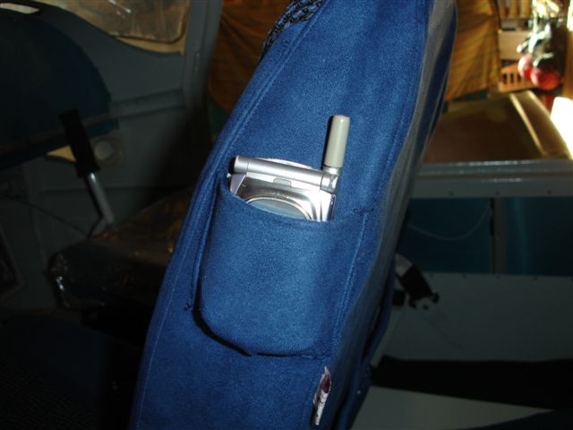

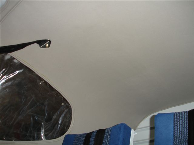

zackrv8
Joined: 14 Jan 2006
Posts: 133
PostPosted: Sat Feb 25, 2006 6:52 am    Post subject: Re: Headliner rework Reply with quote
[quote="LarryRosen"]Ahn used a molding around the windshield and windows as you can see on
his web site <http://www.geocities.com/anhvu_rv10/Fuselage3.html>
Ahn, do you have any details?
Larry Rosen
I visited Anh's Rv10 a couple of months ago. He has a very nice fabric on his headliner (I forgot the name). I think he also has a closed cell foam behind it. Not sure of the thinkness.
Anh did all of his sewing on the interior. He even did his seats. Beautiful work. He even made a cell phone pocket on the side of his seats! Pretty cool.
Zack
See photos below.

jwt(at)roadmapscoaching.c
PostPosted: Wed Mar 01, 2006 6:09 am    Post subject: Headliner rework Reply with quote
Ahn,
How did you do your headliner - looks great! How did you trim the edges?
What foam/sound insulation did you use under the fabric, if any?
John Testement
jwt(at)roadmapscoaching.com
40321
Richmond, VA
QB canopy and windshield trim
