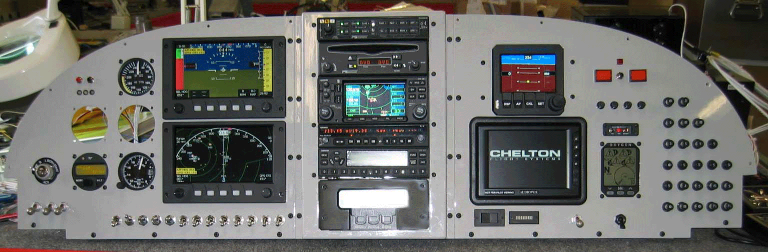

Rob, here is how I did it….
First, Stein built my panel and he used his alternate, 3 section one. (picture attached)
I did not rivet the forward section onto the fuselage and thus was able to mount the panel in the forward section on the work bench. From there I decided what had to be cut out and where to place everything. It was easy to mark locations and do the cutouts and then test fit…..many times. I attached everything on the sub-panel with screws and nutplates so that it would be easier to install in the airplane. I also installed a shelf, using nut plates, between the sub-panel and the firewall to hold the AHRS and in the end I mounted on more item to the bottom (dimmers). I found it hard to fit everything in a convenient place and thus had to make another shelf type extension for the relays, terminal board and manifold pressure sender. In the end it is not to much of a maintenance nightmare, I had to test that theory twice so far. Test number three is coming up next week………..going to change some wiring in the GRT and 430.
