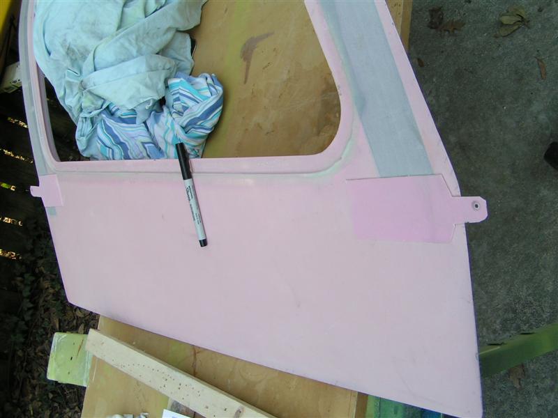

indigoonlatigo(at)msn.com
PostPosted: Tue May 06, 2008 7:50 am    Post subject: Missing index holes in doors Reply with quote
The four inch hand spring clamps work great too rather than making holes in the canopy top...that is provided you still don't have either the windscreen or the rear windows in. A helpful hint also is to cut strips of 1/16 or 1/8" ply to distribute the force of the clamps. The clamps can be placed about 3-4 inches apart from one another.
As per indexing holes on the halves, only two of mine lined up anyway on each door. They were pretty worthless. Vans fiberglass???
Here is something no one else has mentioned. In addition to the dog ears on the lower half of the doors which index the door to the fuselage opening, I also made an aluminum jig from 1/8" aluminum. It was held onto the door with two clecoes and one hole into the existing open holes in the fuse(Total three clecoes each jig). Each door has a fore and a aft jig.These serves to keep the alignment after the dog ears are removed and can be used for all types of things. Makes sure that any subsequent fitting or sealing or pin adjusting, etc is done in exactly the same door position. KEY!
JG
JG

PostPosted: Tue May 06, 2008 6:32 pm    Post subject: Missing index holes in doors Reply with quote
I mentioned the tabs (dog ears) about a month ago. :>)
-Chris Lucas
#40072
