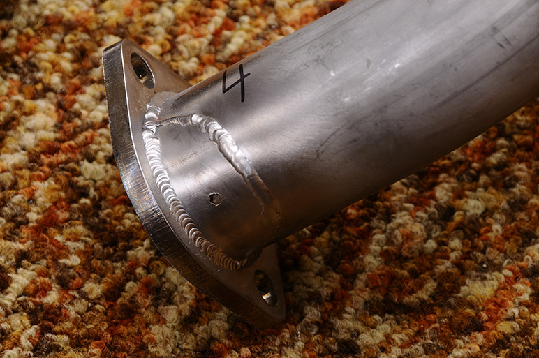

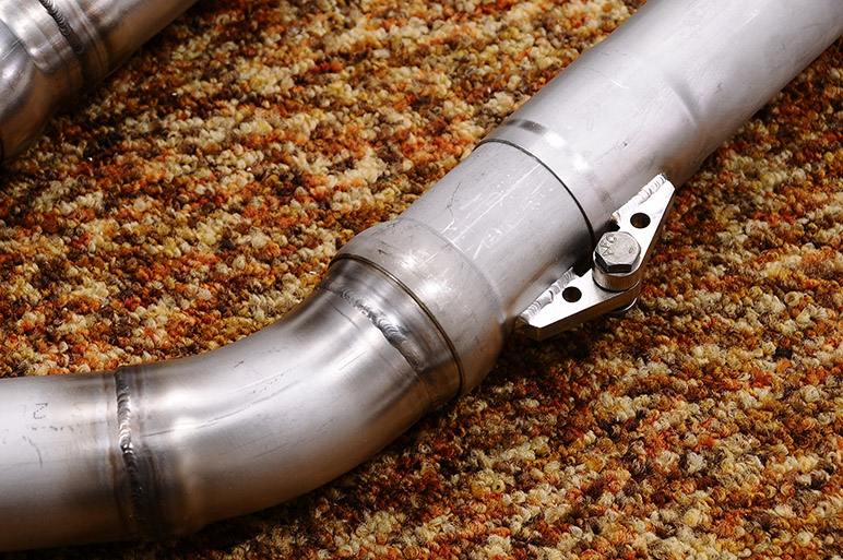

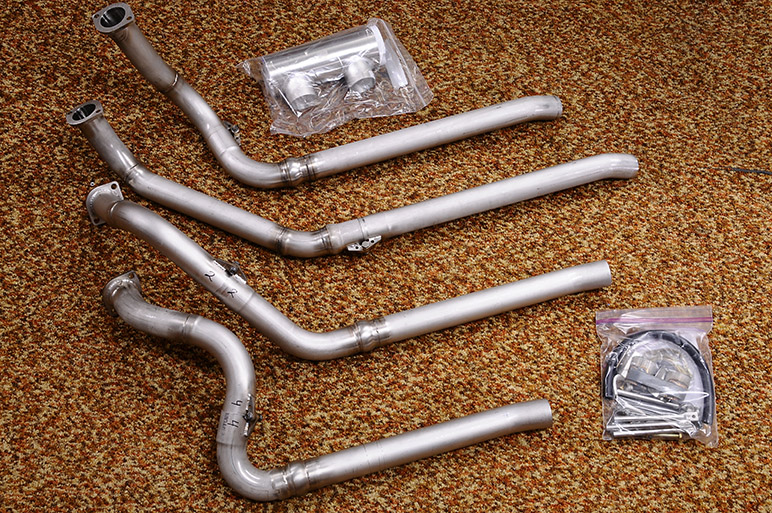

I ordered the new Vetterman 4 into 4 system for my RV-8 with an Lycoming IO-390. Haven't tried it yet, but its another option to consider. Larry claims the maximum HP output with the 4 into 4 setup. I've attached a couple of pictures of it.

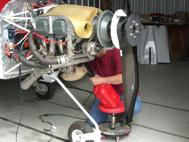

I used a Sky Dynamics' 4 into with which I am very happy. On the down side it take a lot of glass work on the bottom cowl to accommodate the collector. photo of the header attached and you can see it in this shot from the ground as well.
