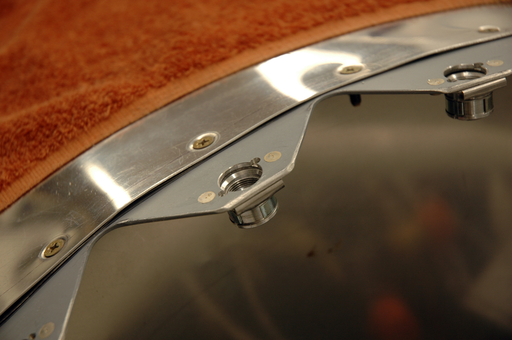

Take a peek at Randy Lervold's site, he is using the SKybolt C-loks. I am leaning this way although not flying yet. He specs out the correct PN's of the recepticles, studs etc. I think they are a better but albeit a tad more expensive than the hinge route.
Heres a link:
http://www.romeolima.com/RV3works/Airframe/airframe.htm
I really like the way they look and should outlast the hinges without any problem.
