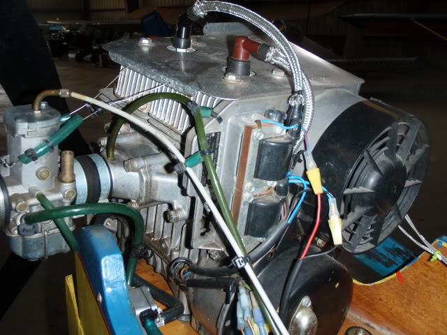

How can I tell if I am looking at a point breaker 447 or a SDI 447 engine. Pete

Points ignition has ignition coils stacked at the pull start end of the engine...Herb

The points 447 has two separate external ignition coils mounted on the side of the engine and also has an ignition damping box mounted onto the pull start assembly housing. The CDI Ducati ignition 447 only has one external ignition coil feeding both plugs.

Attached is a photo of my thundering 447 w/ Ducatti electrics...

Compared to a single ign coil with both wires coming out that is below the carb area ...Herb

Your picture is a CDI (SDI) ignition system. Here is what a point ignition system looks like
