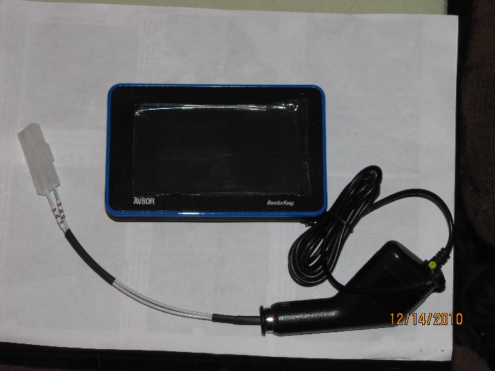

I want to install my AV80R GPS in my panel and wire the power lead to the bus without installing a clunky cigarette power socket on my panel. The GPS input voltage is 5V and it draws 1.5A (at least that's what the cigarette power lead says on it). My buss voltage is 13.5V, so how do I compute the resistor ohm's and watts needed for my power lead? I know enough about Ohm's law to be dangerous.
Thanks.

If so, then there are dozens of "USB power adapters" designed
to accept 14 volts from a vehicular power system
and deliver the smooth, regulated 5v dc necessary
for safe operation of the GPS. But accommodating the King
automotive adapter cable in the airplane is THE
100% way to go.

Thanks for the advice everyone. I learned a lot with this thread. I guess I'll stick with the cigarette adapter and mount the socket behind the panel where I can't see the ugly thing.
Al Rice

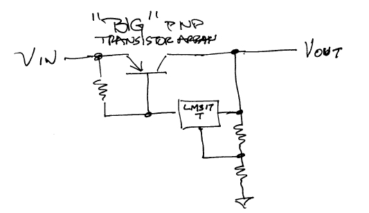

There are options:
1. Like everyone is saying, using a resistor by itself is a bad idea.
2. A resistor and a 5 volt zener diode. Without knowing the current requirements of the GPS, it will be trial and error. 7 ohms, 10W would be a starting point.
3. You could build the 5v regulator circuit suggested by Mike Welch. A 7805 in a TO-220 case bolted to the airframe and using thermal conductive paste.
4. Take apart the OEM adaptor and solder wires to it and connect to the aircraft power.
5. Buy one of these: http://www.mouser.com/ProductDetail/Murata-Power-Solutions/78SRH-5-2-C/?qs=35WhQNrE6p2lJ6BniHrImQ%3d%3d Probably generates less heat than other options.
Joe

7805 and LM350 for higher current come to mind.
Ken

Sure . . . or go to a bigger device. The 3-terminal regulators come
in a range of sizes. The smallest are
[img]cid:.0[/img]
6 x 4 mm on a side, solder right to the board, and as you
might expect, cannot dissipate much power. They're good
for 100-500 mA max . . . but if your needs are small . . .
At the other end of the spectrum, you can buy these guys
[img]cid:.1[/img]
Rated for 5A and MUST be on a hefty heatsink. Furhter,
one can built arrays of transistors on even heftier
heatsinks perhaps cooled with fans.
[img]cid:.2[/img]
I think the last time I built up something like this
it was to craft a finely adjustable 50A, 28v load bank.
There were 10 fat transistors on a big chunk of aluminum
cooled with a fan. This rig was good for 1400 watts
of room warming dissipation all controlled by a little
piece of plastic
[img]cid:.3[/img]
and a 1/2" diameter potentiometer.
The point to be made here is that the series-pass,
smart regulator can be crafted in just about any size
and output voltage within ratings limits for the
devices.

So, like I said, I chickened out and decided to use the car charger unit that came with the AV80R. I was able to pry the case apart and inside was a 1"x1" 12v-5v DC to DC power converter. I cut off the leads to the outside contacts and soldered on longer leads. For a case for the power converter, I simply used the existing one and routed the leads out the nose to a Molex plug. I'll secure the case behind the panel with an Adel clamp. Here is what it looks like.
