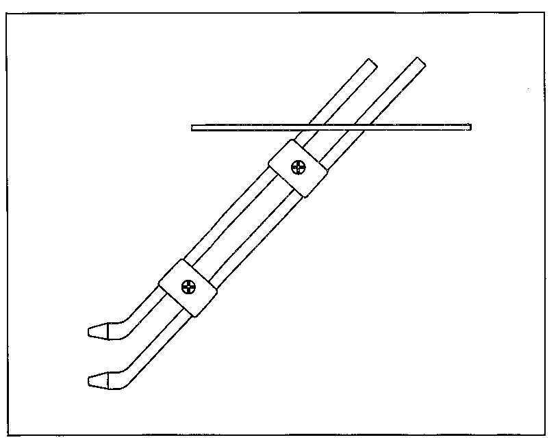

Just wondering if it is possible to make the LRI probe out of Aluminiun Tubing ? (Like the Pitot tube only 2 tubes strapped together at proper distances etc.)
Anyone , any ideas ?
Steve

Sorta like this ?

I suppose it would be possible to redesign the LRI probe, but I don't
know how you plan to make it work correctly. I looked at my probe
for a while and learned (I think) that the critical part of the probe
is the ridge formed by the leading corner of metal. It is this
structure that divides the airflow into two parts for sampling at the
two input holes.
The tube design would be OK for conducting the pressure to the gauge,
but you still need a way to get the differential pressure sample from
the airflow.
I don't think it is all that hard to drill the holes in the solid
aluminum as shown in the LRI drawing. I did it in an hour or two
with a drill press and hand held drill. I don't remember what kind
of drill bits I used, but it might have included some of those 6"
"Aircraft" drills.
Good luck,
Paul

Hi Paul,
I don't think it is all that hard to drill your design either, and if you are correct about the differential pressure bit, you are probably right about a lot of stuffing around to get something that works correctly.
However, I'm sure it can be made to work, and as I have an "Enigma" EFIS that has the LRI/AOA Gauge built in I'm gonna experiment a bit with it. ('Cos I'm like that! LOL!)
Steve

<?xml:namespace prefix="v" /><?xml:namespace prefix="o" /><![endif]--> Re the "sorta like this", illustration, I also made a lot of aluminum shavings, trying to properly drill the *&^%$ probe. I think, though, that the magic comes from the differential pressure generated by the square nose of the probe, with the inlets on upper and lower sides of the corner of the block of aluminum. I put mine on the shelf for a while, but I plan to make a probe equivalent to my longest drill's flutes, and then mount it with tubes held rigidly. May not work, but worth a try.

I am going to drill mine from each end, than weld one end closed. A

Yes, Bend the lower one 30 degrees down; top as normal pitot.
