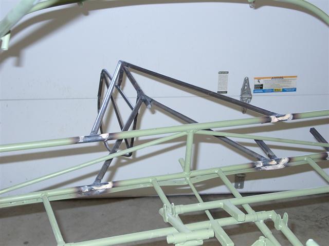

Attached are some pictures of my combination nose pull handle, tie down, and skid (yea, I know, a training wheel!).
I had to angle off the lower part of the front frame so the cone would fit.

Rex,
I haven't been following the list close enough to see your nose
bracket, but this seems to be a little extreme to weld an attachment
to the airframe. The new kolbs don't nose-over as bad as the older
ones. I would think that a clamped one would be sufficient. After a
few hours, it wouldn't be necessary. Keep the stick back all the time
when taxiing (it's a pusher with enough power to overcome any
tailwind on the elevator). This is going to affect your weight and
balance up front like that.

It's just 1/2 of the garage. The boss parks her car outside on the weekends to give me a little more room!
Ralph,
The attachment is beefy so I can use it as a pull/push handle and an extra tie down if needed. Hopefully it will never be tested as a nose skid.
Rex Rodebush

Rex
I almost didn't comment on your Nose Bracket because I really don't want to
offend you but I have a more over riding concern that people will think
there is a need to build these things. There IS NOT a nosing over problem
with the MKIII. You even have the optional(longer and forward bent) gear
legs which transfers even more weight to the tail.
John H recently commented that he can do a full 100 HP run up without nosing
over and his main gear is configured very close to the way the optional gear
legs are configured.
I have been flying my VW powered MKIIIc in allot of configurations over the
years and only came close once. This was on my first flight with my redrive
VW. This was a extreme case where I had a very high thrust line (7 inches of
clearance with a 72 inch prop) with the stock gear legs and I wasn't used to
the thrust of my new redrive VW engine. I may even had run through a puddle
of water. With my direct drive engine I had gotten used to raising the tail
during my takeoff roll and going to full power fairly quick. I don't do that
any more.
Again I don't want to offend. Sorry!
Rick Neilsen
redrive VW powered MKIIIc
| Back to top |
Rex Rodebush
Joined: 10 Jan 2006 Posts: 209 Location: Branson West area, Missouri
Posted: Wed Mar 21, 2007 4:26 am Post subject: Re: Nose bracket |
Hi Rick,
No offense taken. I don't disagree with anything you said.
I feel it is worthwhile for me to have a nose push/pull handle, an extra tie down location and a skid as a bonus (three birds with one stone!). Others may think it's a waste of time and money and just extra weight; and that's fine.

Posted: Wed Mar 21, 2007 6:58 am Post subject: Nose bracket |
I asked this a while ago and appreciate your info and the pics of the nose bracket, It can't hurt and it's well done. Can't be any heavier than Johns sleeping bag. Don't forget some of us (me) can't fly anything. If after what seems like decades getting this Kolb in the air I could put training wheels on the wingtips and land on a mattress I would.
Spose I'm getting a little paranoid the closer to lift off I get?
"What I'd like to know is how to attach a skid under them to insure us complete beginers against an expensive and time consuming repair from even the slightest nose dinging.
Maybe a vertical partition inside front to back. Maybe Uncle C. would know how to do that and if it would work."

NeilsenRM(at)comcast.net Guest
Posted: Wed Mar 21, 2007 8:01 am Post subject: Nose bracket |
Vic/all
Do yourself a major favor and get some training in a similar Kolb before you fly. The time and money you save by not building all those things that non flyers tell you are important will pay for the most expensive of training. You can't build a plane that it is 100% safe, no way. Well maybe you can by making it so heavy it will not fly. A light plane flies better.
The cardinal rule is follow the plans. It is easy for make a plane less safe when the intent is to make it safer. Talk to the factory or people that have hundreds if not thousands of hours on non factory changes. Ignore the rest.
Sorry I'm on kind of a rant on this.
Rick Neilsen
Redrive VW powered MKIIIc
| Back to top |

Posted: Wed Mar 21, 2007 8:38 am Post subject: Nose bracket |
Rick Neilsen
Rick:
Dad burn it! You took the words right out of my mouth.
This nose skid thing is very similar to the landing gear thing we go
through here periodically. There is nothing wrong with the Kolb
design. We all start out with the first flight in a Kolb. Any
"normal" pilot can fly and feel very comfortable in a Kolb in a matter
of a few hours.
I agree with you Rick, a lot of recommendations are coming from folks
that have zero or near zero time and experience flying Kolbs. Don't
think I will base any design changes on that category recommendation,
even though I did see Homer Kolb and a passenger in the factory mkIII
put it on its nose when Homer swung the tail around in a stiff breeze,
1991, on Homer's airstrip. The factory put a skid in the plans for
those that wanted it.
I did the same thing with a "heavy" passenger a year or two later in
the factory mkIII at Lakeland. Tailwind, heavy passenger, and a brish
tailwind. No damage, just pride.
The beauty of experimental/UL aviation is the choice of how you build
your airplane. If you want a skid, go for it. After all, didn't the
Jenny have axe handle skids on the outboard end of each bottom wing?
PS: Busy fabricating new center section. Did not realize how many
individual parts and rivet holes were involved in this project.
Gonna go all sheet metal this time, since I was able to use the old
lexan cover for a pattern. Looks like it is going to work out.
