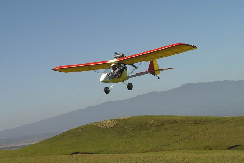

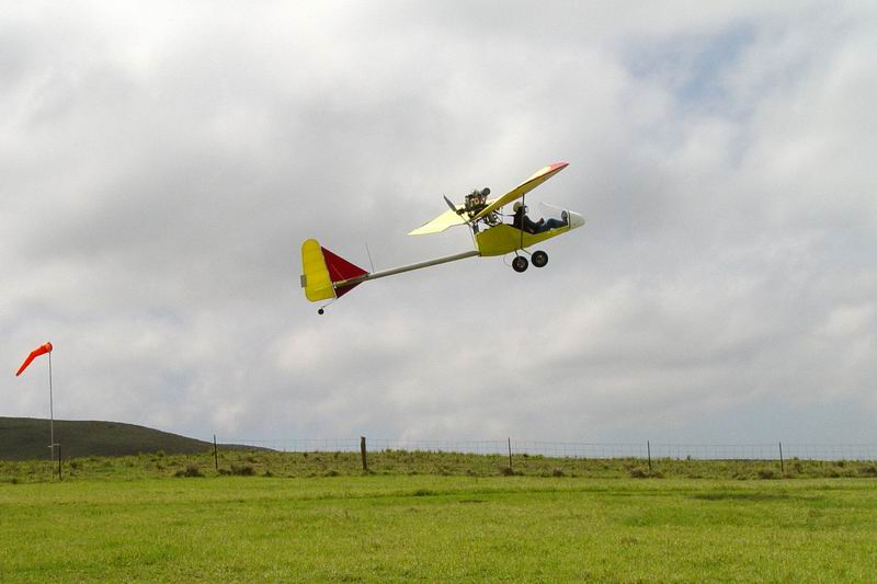

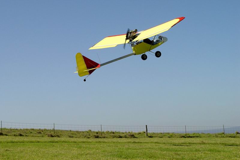

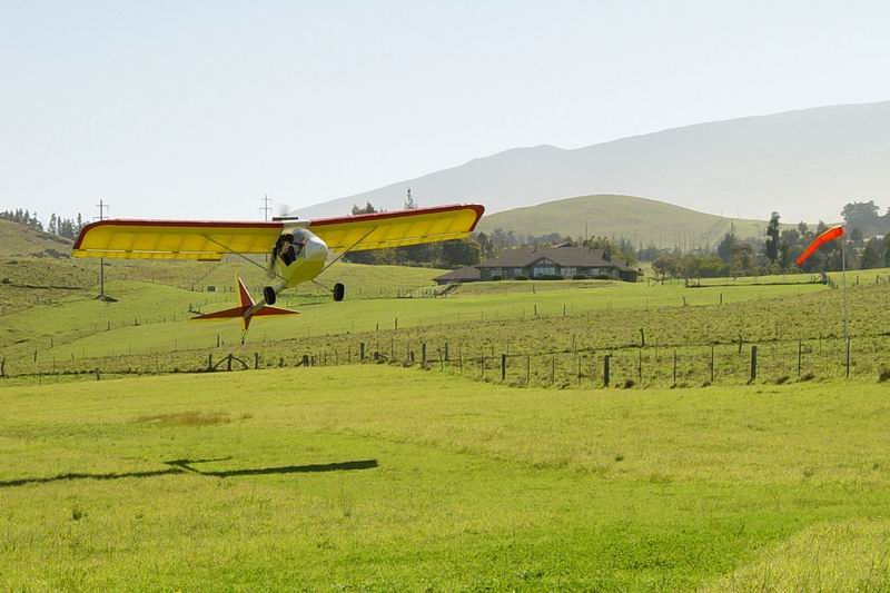

Flew the HKS Firestar again this morning. This time, I went down to the coast and did some whale watching and buzzed some outrigger canoe paddlers. The engine is running great, and is a real performer at 1,000 feet density altitude. When I returned home, I did some landings and take offs at my home strip for the camera.
I’m not doing too well keeping the oil temperature in the optimum operating range because of the wide range of altitudes and temperatures I operate in here on the “Big Island”. I am going to install a thermostat in the oil system when I do the first oil change.
John Hauck is right about operating experience with this engine/airframe combo being needed before making a final judgment. I’ll periodically update this thread as I get more time on the engine. I highly recommend that anyone who decides to do the conversion contact Jerry Olenick of GreenSky Adventures for the mounting kit he is going to produce. He’s a great guy, and has been available for help during every step of the project.
The whole conversion was done without cutting or drilling a single part of the Firestar frame. It’s a bolt-on conversion.

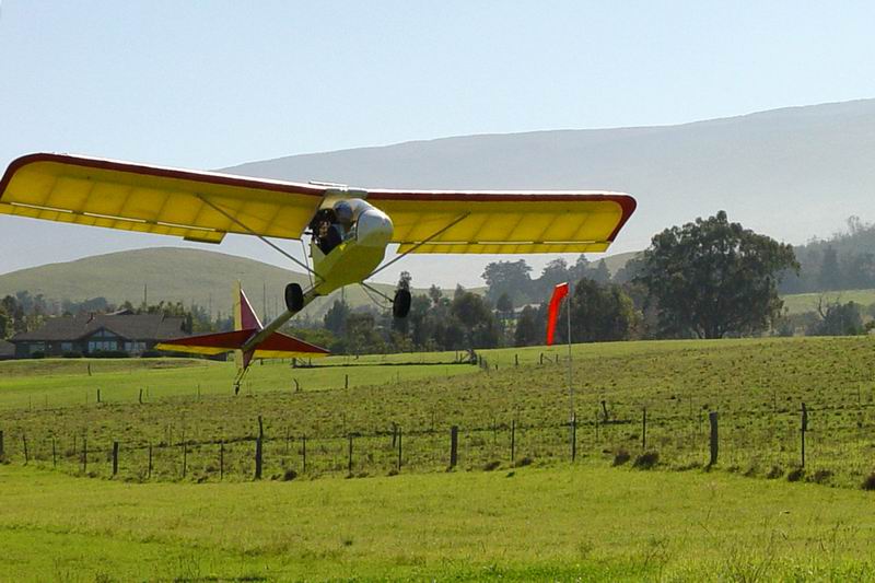

Landing on 600 foot pasture strip at 4,000 level of west slope of Mauna Kea on Hawaii Island
 Filesize:  43.4 KB
 Viewed:  497 Time(s)

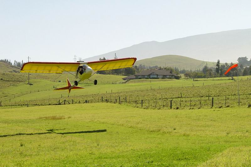

 Filesize:  34.38 KB
 Viewed:  514 Time(s)

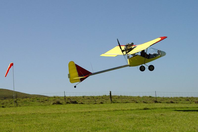

Take off from 600 foot pasture strip at 4,000 level of west slope of Mauna Kea on Hawaii Island
 Filesize:  40.9 KB
 Viewed:  470 Time(s)
 Filesize:  67.54 KB
 Viewed:  483 Time(s)

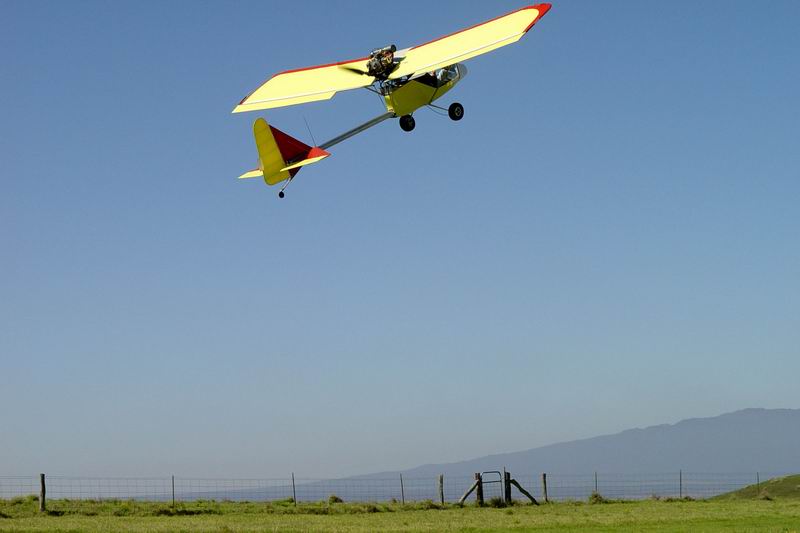

 Filesize:  25.32 KB
 Viewed:  497 Time(s)
 Filesize:  36.43 KB
 Viewed:  471 Time(s)

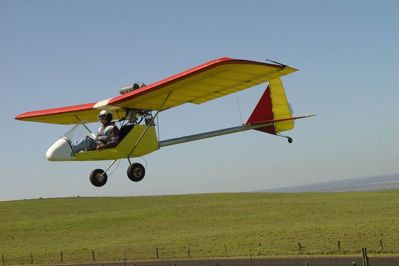

 Filesize:  45.82 KB
 Viewed:  506 Time(s)

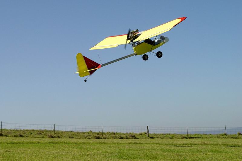

 Filesize:  67.25 KB
 Viewed:  1323 Time(s)
