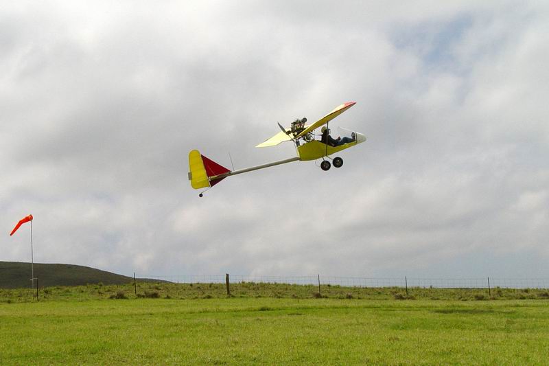

Flew the HKS Firestar again this morning. This time, I went down to the coast and did some whale watching and buzzed some outrigger canoe paddlers. The engine is running great, and is a real performer at 1,000 feet density altitude. When I returned home, I did some landings and take offs at my home strip for the camera.
I’m not doing too well keeping the oil temperature in the optimum operating range because of the wide range of altitudes and temperatures I operate in here on the “Big Island”. I am going to install a thermostat in the oil system when I do the first oil change.
John Hauck is right about operating experience with this engine/airframe combo being needed before making a final judgment. I’ll periodically update this thread as I get more time on the engine. I highly recommend that anyone who decides to do the conversion contact Jerry Olenick of GreenSky Adventures for the mounting kit he is going to produce. He’s a great guy, and has been available for help during every step of the project.
The whole conversion was done without cutting or drilling a single part of the Firestar frame. It’s a bolt-on conversion.
http://www.greenskyadventures.com/EnginePricing/HKS/home.htm

This is an update on the HKS powered Firestar. I’ve been flying it regularly, and nothing to report but good. It’s smooth, powerful, starts immediately, and hasn’t missed a beat. I’ve been going over it very carefully after every flight, and everything is solid, with no sign of anything wanting to shake off or come loose.
Fuel consumption is between 2.4 and 2.5 gallons per hour over the broad range of flying. You could probably do a bit better than that in steady cruise.
The only thing I am going to change is to add an oil thermostat. I fly over such a broad range of altitude and temperature that it is difficult to regulate oil temperature by partially blocking the cooler airflow.
