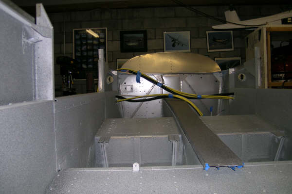

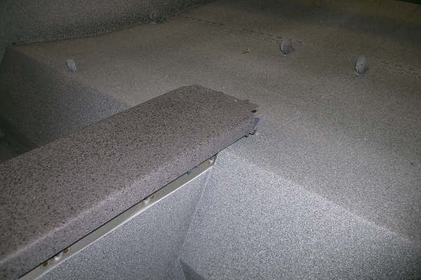

As for painting the interior, just want to let you all know that I painted
my interior with Zolatone using two different colors and the results were
quite nice. The tunnel cover, the aft wall and the roof will be a different
color than the rest.
My plane will be a fairly bare bones transport tool, but the results with
the paint are really clean and it should be very durable and stain proof.
Only cloth will be on the seats and the armrests.
John G. 409 Do Not Archive

HERE ARE SOME PHOTOS OF INTERIOR PAINT...ZOLATONE

Vern(at)teclabsinc.com Guest
Posted: Thu Mar 29, 2007 7:34 am Post subject: Interior paint! |
John,
Very nice results and much lighter than upholstered panels. A few
questions about the process.
1. What primer did you use under the Zolatone?
2. Did you over coat the Zolatone with clear polyurethane?
3. Have you pre-fitted the cabin top or does that come later?
4. Are you installing a headliner or using Zolatone on the cabin roof?
Vern Smith (#324 riveting fuselage skins)
| Back to top |
indigoonlatigo(at)msn.com Guest
Posted: Thu Mar 29, 2007 8:06 am Post subject: Interior paint! |
I used the primer that Aircraft spruce sells, but there is some confusion on
the directions on the Zolatone web site as far as what primer is used on
aluminum versus ferious metals. There are conflicting statements regarding
aluminum. Mine was a quick build fuselage and it appears that the Shermin
Williams primer was compartible with the zolatone because the Zolatone
overspray appears to have adherred quite well. I would test it without a
primer if you have been using the Sherwin William's product or have a Quick
build. Go to their web site for more information.
No overcoat is necessary, it will also make any future repairs very easy.
As you can see from the picture I did a real nice job of masking off the
areas that interact with the cabin top. It will be easy to spot shoot and
lapse in coverage. The cabin top has not been fitted.
The cabin top will be the same black color as the aft wall and tunnel cover.
It is cool because it looks like fabric in that it is textured.
Hope it give some people some options to think about.
John G.
