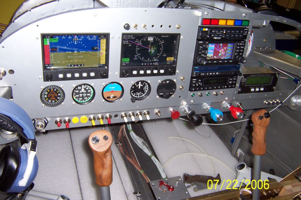

I have two GRT screens and a CMX 200 (picture attached with MX 20 before
trade in). The top screen is a GRT (PFD) and the left bottom screen is a
GRT screen. Under the top GRT screen is the MX 20. The lower screens (GRT
screen and CMX 200) are not all that easy to see. I'm 6' and find myself
looking down at the lower screens at an angle that seems to wash out the
screens (not all that bad but when I lower the viewing angle the screens
look much better. Laying out the panel my thought was to keep the screens
in front of the left seat as much as possible. May not have been such a
good idea. When I redo the panel with the new GRT hi res screens I'm
thinking I may go with a horizontal layout that gets the screens higher.
Mark

Gary, mine is a 7 panel so it is smaller than the 10 but you can see how
they fit in this picture. If I had a third panel, I would dump the EIS
display and put it on a hidden sub panel. This is an Affordable Modular
Panel. I "might" put one of the Garmin docking panels in the right side but
am thinking of just putting one of the bigger panel GPS units (AVMAP EKP-4)
on the right to entertain the passenger
I like the radio stack high and easy to get to so because that is typically
what pulls the eye from the EFIS unless you have the higher end units where
you do it all from the EFIS itself. Not sure vert or hor makes me a lot of
difference. How does it flow to the hand and eye would be my consideration.
Hope this helps
Bill S

The horizontal layout allowed me to pack it all into the panel, keep
every major piece of equipment as high as possible along the
horizontal scan, and keep your eyes as minimally directed downward
as possible.
I hesitated to even reply to the thread on positioning because although
I am now very set in my ways as to how I like the layout, I'm also not
a "my way or the highway" (in the sky... ) kind of guy. I believe
that if you have a reason why some arrangement fits your needs better,
that's your decision and who am I to argue. People have different
needs. That said, very few people would realistically want to do
anything that would damage an effective scan, so I'd advise taking
the time to plan out as efficient an arrangement as possible. Mock
it up, and, one thing I did a lot of was asking others more
knowledgeable than myself for their opinion. I'm very happy with
the layout now, and about the only thing I'd change if I were cutting
aluminum again is to not have put an elevator trim switch on the panel
at all, because the sticks are good enough for me.
You're doing a great thing by asking, and thinking about critically, but
at the same time, don't expect anyone to be able to tell you exactly
what to do...in the end, you're the builder. Feel free to send the
list a panel layout as you get ones you want to bounce off people, and
I'm sure you'll get critiques that will help.
