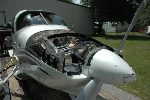

PostPosted: Fri Oct 05, 2007 1:53 pm    Post subject: Alternatives for Weld On 10? Reply with quote
Jesse – thanks and any photos (when you return north) would help clarify the process. Mark are you game on your experience. Our goal is long-term and solid adhesion of the window material to the composite canopy through all types of flying experiences.
I guess too many builders are suffering from Acetone addiction for a Friday.
The attached photo was NOT acetone induced.
John

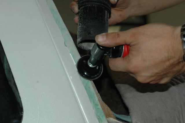

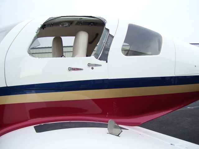

PostPosted: Fri Oct 05, 2007 3:58 pm    Post subject: Alternatives for Weld On 10? Reply with quote
This is the best of what I have. Sorry for the mugshot, but it’s a little better than the alternative.

PostPosted: Sun Oct 07, 2007 2:21 pm    Post subject: Alternatives for Weld On 10? Reply with quote
My front window came out surprisingly easy. Almost to easy. It came out in fairly large pieces. I had used a glue recommended by a Lancair builder. On the second window I used the Weld-0n 10.
