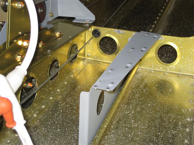

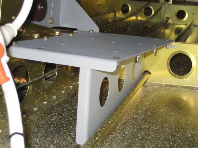

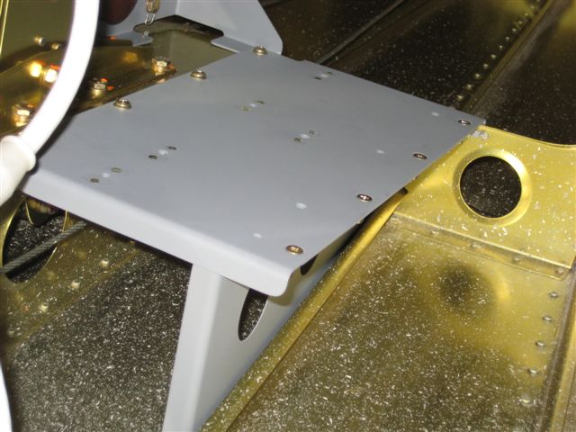

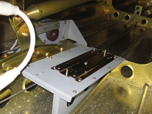

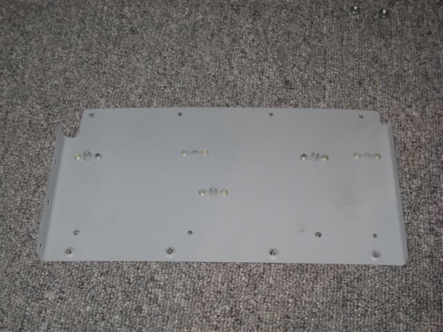

PostPosted: Mon Nov 12, 2007 6:08 am    Post subject: Vans RV-10 AHRS Mounting Kit Reply with quote

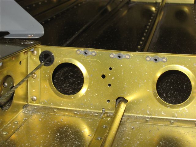

<<IMG_0911.JPG>> <<IMG_0912.JPG>> <<IMG_0913.JPG>>
<<IMG_0922.JPG>> <<IMG_0923.JPG>> <<IMG_0907.JPG>>
<<IMG_0908.JPG>> <<IMG_0909.JPG>> <<IMG_0910.JPG>>

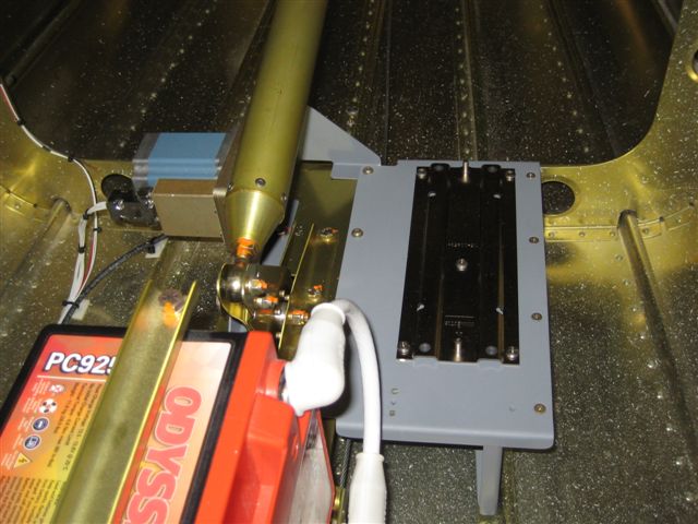

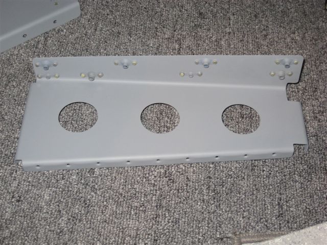

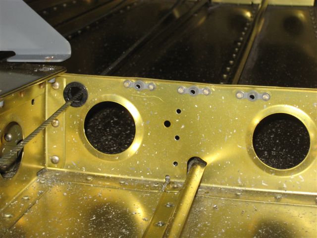

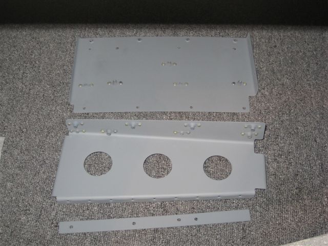

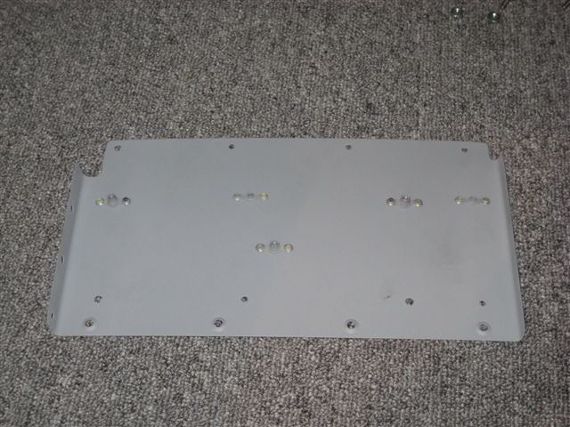

I was working with Garmin here in Olathe on this bracket and
testing it using my RV-10. Here are all the pictures I provided to
Garmin during this process. Van's actually created the bracket with the
feedback that was provided my Scott (Garmin) and myself.
By the way, I don't have either AHRS, but this bracket still
makes an excellent support for a 1" x 8" board when you need to crawl
back into the tail. We are still working on the bracket for the
Magnometer, problem is finding a good location that is free of magnetic
interference to the standards which Garmin has set for the Certified
installations.
Thank You
Ray Doerr
40250
N519RV

PostPosted: Mon Nov 12, 2007 6:29 am    Post subject: Vans RV-10 AHRS Mounting Kit Reply with quote
With the plans that come with it, how far away from the battery and
any servos does it place the AHRS. You'd want to put as much
distance between as possible, trying to get at least
20". Just wondered what the plans spec.
Eric_Kallio wrote:
I just bought one last week to see how it worked myself. It is a
simple shelf that looks to be plenty sturdy. It comes with a rib that
mounts to one of the floor stiffeners meaning you have to drill out 9
rivets. The tray then mounts to that rib and the bell crank platform
aft of the battery. It has match drilled nutplate attach holes for
the GRT and Garmin AHRS, but it can easily be modified to fit others.
I hope to get some time in the shop this week and get it installed.
When I get it done I will post a picture for you and see if I can get
the instructions scanned.
Eric Kallio 40518 Floors and fuel system
http://forums.matronics.com/viewtopic.php?p=145336#145336
Tim Olson
Joined: 25 Jan 2007
Posts: 2882
PostPosted: Mon Nov 12, 2007 6:53 am    Post subject: Vans RV-10 AHRS Mounting Kit Reply with quote
Ah, you answered my question....so, this bracket is truly an AHRS
bracket, not intended for use with magnetometers, so for some
AHRS such as the Crossbow, this would not necessarily be in a
good area, but if you use a pinpoint, or a GRT, or G900, it would
probably work fine for the AHRS itself. That makes sense. It seemed
too close to magnetics for a magnetometer.

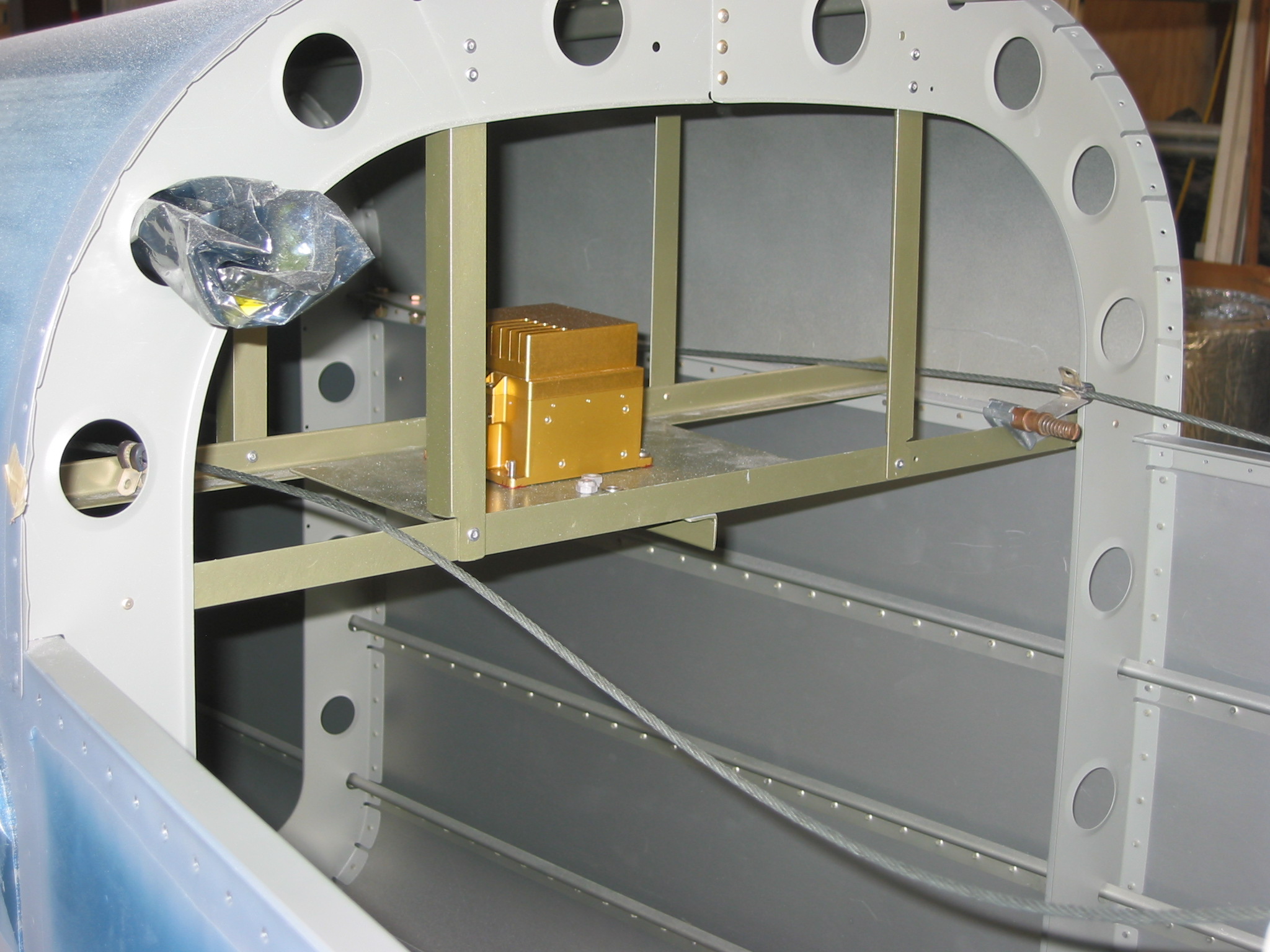

Ray.R.Doerr(at)sprint.com
PostPosted: Mon Nov 12, 2007 8:10 am    Post subject: Vans RV-10 AHRS Mounting Kit Reply with quote

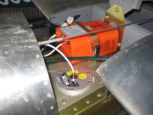

Yes, I am still working with Garmin on the Magnometer mounting
bracket, but this is one which Garmin will be producing. He had on made
for the aft deck, but with the cables for the elevator trim in there and
my ELT and was OK for Static Error but the Dynamic error (moving things
like Elevator, Trim, Lights on, etc) is where it was out of tolerance.
We are still working on it.
Attached is a picture of one location we tested, but will not
work. The round piece is the Garmin Compass module.
Thank You
Ray Doerr
40250
N519RV

PostPosted: Mon Nov 12, 2007 4:43 pm    Post subject: Vans RV-10 AHRS Mounting Kit Reply with quote
GPS ant on the glare shield has worked flawlessly for my 430.
kearney(at)shaw.ca
PostPosted: Mon Nov 12, 2007 5:01 pm    Post subject: Vans RV-10 AHRS Mounting Kit Reply with quote
Tim et al
Reading my post I realized I left out one key point. When mounting on the
bulkhead, I was wondering if it should be mounted high on the bulkhead near
the top skin (as opposed to on the floor).
Cheers
Les

poneill(at)irealms.com
PostPosted: Tue Nov 13, 2007 11:11 pm    Post subject: Vans RV-10 AHRS Mounting Kit Reply with quote
Thanks much for the pictures Ray! That helps a lot.
Unfortunately, I don't think I can use that as the AHRS station. The xbow
NAV 420 has an integrated 3-axis magnetometer. I can imagine the grief
trying to situate it 6 inches from a main battery wire. So it's back to the
shelf plan for me.
But that might be another useful station for something else. I'll have to
keep that bracket in mind for the future.
By the way, how are you prepping the inside of the tail cone surfaces? Is
that all just alodine? Looks great!
Anyone else currently flying with OP EFIS? Any location success stories or
problems with the NAV 420 AHRS?
Best Regards,
Patrick #40715
PostPosted: Wed Nov 14, 2007 6:36 am    Post subject: Vans RV-10 AHRS Mounting Kit Reply with quote
That nice gold finish is PPG Armor Grip. I think it is 900 and
901.
Thank You
Ray Doerr
PostPosted: Wed Nov 14, 2007 6:39 am    Post subject: Vans RV-10 AHRS Mounting Kit Reply with quote
This is the exact same position that we found was the best
location for the Garmin unit when installed in the Tail area.
Thank You
Ray Doerr
jump2(at)sbcglobal.net
PostPosted: Wed Nov 14, 2007 11:03 am    Post subject: Vans RV-10 AHRS Mounting Kit Reply with quote
Here is my mount for the 420 ahrs.
I can build a shelf on the four posts if I need to get it 6 inchs higher away from battery and servo. I'm a good 20 " away now. Will try to demag the cable if not see about stainless.
Pat Thyssen
