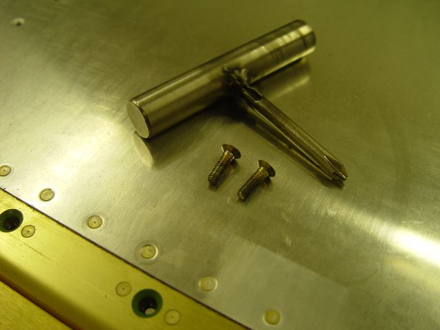

What brand and model do you use? Didn't even know they existed
(Googling now).
I use a driver with a T-handle to do this - much slower but it works.
Very useful in removing QB tanks. Pic attached.
Thanks!

Bill, Nice tool, but you won't believe how these power drivers will change your life!
Here's a quick shot of the Ryobi on Ebay: http://cgi.ebay.com/Ryobi-18-Volt-Impact-Driver-New-P231_W0QQitemZ280189857137QQihZ018QQcategoryZ71297QQssPageNameZWDVWQQrdZ1QQcmdZViewItem
Here's the DeWalt like mine: http://cgi.ebay.com/DeWalt-DW056-18V-Cordless-Impact-Driver-NEW_W0QQitemZ280187210049QQihZ018QQcategoryZ42272QQssPageNameZWDVWQQrdZ1QQcmdZViewItem
They're both similar (both probably made at same place in China) -- and the techno freaks can tell you about torq specs and blows per minute -- just get one or borrow one, you'll like it!
