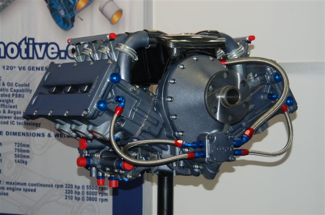

I have been reading the engine debate with some interest. There are pros and cons to all types.
Just to stir the pot a little more!!!! have a look at this South African development.
http://www.adeptairmotive.com/site/default.asp
It hasn't even flown yet, but it is running. It has been designed from the ground up as a GA engine.
Turbocharged, 320hp at 5500 rpm, 70% 210hp at 2300 rpm, Integrated PSRU, Liquid cooled, Compatible with Avgas OR Mogas, FADEC, 130kg (287lb).
Targeted TBO is in excess of 2000 hours. The engine has a fairly oversquare bore/stroke ratio (98mm x 70mm) in order to keep piston speed low, as well as fairly short con rods Now before anybody has a go at the revs, the average piston speed is actually lower than conventional GA engines because of the oversquare setup.
It is a 120 degree V6 of 3.2 litre capacity. Real smooth.
Just for those with a little experimentation in their blood. Attached is a picture.

In a message dated 1/7/2008 3:24:40 AM Central Standard Time, simon(at)sertech.com.au writes:
| Quote: | | Just to stir the pot a little more!!!! have a look at this South African development. | Their strategy is to price this experimental engine...unproven ...at Lycoming and Continental's current prices, because they say it will weight less than current engines. Apparently they do not intend to have it certified.
So let me understand...they want what the current certified guys want for engines, they want the experimental builders pay extra for a weight difference and the experimenal operators, take all the risk; plus they are based in a country where you can't take any legal action if this engine poops out and kills you...sounds like a deal to me...

I want Les to succeed. I want Jan, even though I have reservations
about the person, to succeed. I want the folks from South Africa to
build the best darn engine that has come along in a long long time.
