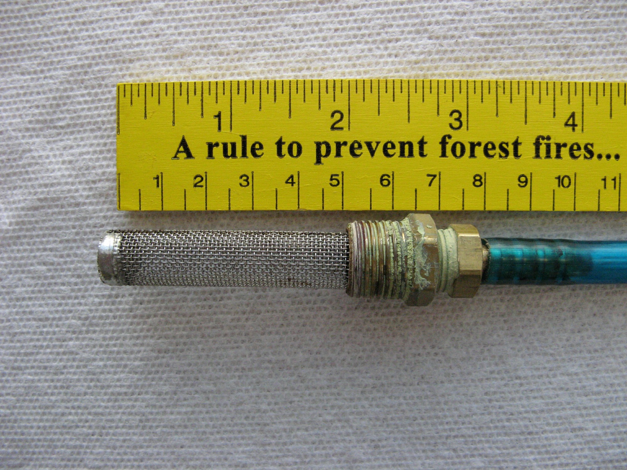

My Kitfox was originally built in 1994. So, I think it is about time to remove and check the finger strainers in the wing tanks. Has anyone on the list removed their finger strainers from the fiberglass wing tanks and if so are there any issues of concern getting the strainers out without damaging the tank threads?

I removed mine when I did the flush and re-kreeme job, Jimmie. I
didn't have any problem. I reinserted the finger strainers, using a
Permatex Aviation product...just can't recall the proper name of
it...some kind of gasket maker stuff.

Jimmie,
I did it repeatedly during the first 40 hours and a few more
times after trying to find a sealant that would work. You're right
about the threads and that concern prompted me to leave them in at
the last annual. The answer obviously depends on what sealant was
used to install them. If they were epoxied in, you're probably stuck
with them. (Bad pun intended.) (It's possible the brass will release
from the epoxy, but unlikely. More likely the epoxy will ball-up,
distorting the hole significantly. Nearly any other sealant should
shear before the glass and brass so you should be able to remove them
without trouble. Don't heat the tank to soften the sealant, not just
because of the gas inside, but because the vinyl-ester resin used to
make them is not intended for high temperatures.
By the way, the only sealant I've gotten to work with 100LL
is two-part polysulfide:
(http://www.aircraftspruce.com/catalog/cspages/proseal.php)
Guy Buchanan

Jimmie:
My '94 strainers were installed with Permaseal (Permatex?) aviation gasket
goo. I gently heated up the strainers and tank area around them with a heat
gun (no fuel in the tanks, caps off, it takes a bit of time) and the
strainers very easily came right out. Before heating they were rock solid
and I was afraid of damaging the threads. Heating would work with most
sealants I would suspect.
Hope this helps.

While on the subject; I have no reason to believe I have problems with my finger strainers but ... it could be nice to check that are not halv cloted, right? But I don't really want to remove them. Isn't it possible to suck fuel from the refueling cap side and hold a hose close to the strainer to see if some dirty stuff of particles is being sucked? Has anyone tried that?

The mesh in those strainers is pretty big. It's a bit like they're designed to keep mice from clogging your fuel system. If fuel is flowing freely and you're not finding smaller stuff in downstream filters/traps, it's a solid bet finger strainers are clean.
I remove and inspect mine annually with no problem. I wouldn't if it meant cutting tho. Have never found anything in them. I burn 93 octane auto.

Marco, can you give me the approximate size of the mesh, please? I have
never seen one open.
Michel, here's a finger strainer picture attached.
Thank you, Tom. From your ruler, I make it about 1 mm mesh. Somewhat
oarser than my gascolator.
