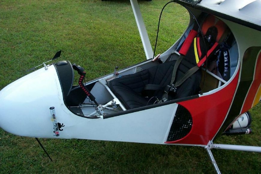

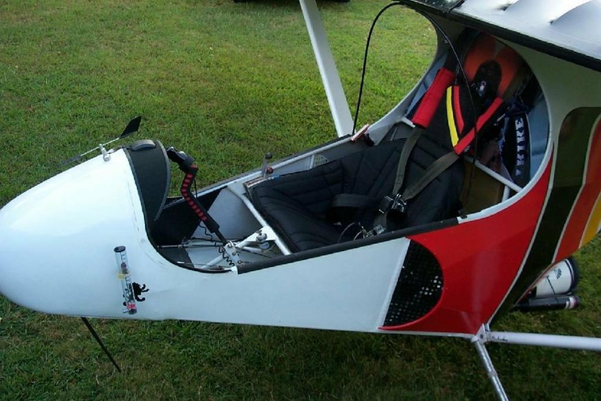

PostPosted: Sun Feb 17, 2008 5:41 pm    Post subject: Finally flying my MK III!!! Reply with quote
At 09:50 AM 2/17/2008, you wrote:
Anybody know how accurate the old Hall (floating disk) airspeed
indicators are? I borrowed one from a friend to check my ASI, but
cold weather has kept me from getting a chance to mount it yet.
-Dana
I've got one on mine - it's more accurate than the one inside at low speeds.
Especially with the windshield off, but I think even with the windshield on
the Hall ASI is the most consistent.
 Filesize:  104.46 KB
 Viewed:  408 Time(s)
Possum

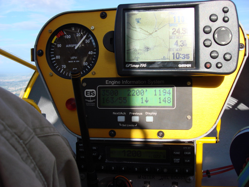

At 10:24 AM 2/17/2008, you wrote:
I have had an outside static source on my Kolb from the beginning,
so there are no pressure errors in my system. I have also checked
my airspeed readings with the GPS you see in the picture under no
wind conditions, and again everything is accurate.
Precise placement of the VG's has been determined by the
manufacturer, they are not airplane specific, but its about the same
for most general aviation airfoils. The angles of the VG's into the
wind are especially critical as is thier design. I put them on
exactly per the instructions, and the result was an incredible
difference. You can get the VG's at:
http://www.landshorter.com/
There is another Kolb MK III with a 912 based at my field, its "Fat
Albert" as some of you remember that plane. The difference between
landing that plane and landing my plane is huge, the other MK III
has to be landed very fast, and with power to keep it from dropping
hard onto the runway much the same as described by Grant. My MK
III can be landed engine off, approaching at 50 MPH and result in a
soft landing. The "Fat Albert" pilot could not believe the
difference between the two MK III's.
In a nutshell, the VG's eliminate the "Kolb Quit" where the plane
just drops into the runway if you get it to slow. I generally do
three point landings, but many times I touch the tailwheel first at
less than 30 MPH indicated, no problem, the mains just come down
very nicely. I will take some videos of this and post them on You Tube.
Mike

PostPosted: Sun Feb 17, 2008 10:56 pm    Post subject: Re: Finally flying my MK III!!! Reply with quote
NeilsenRM(at)comcast.net wrote:
Grant
VGs likely help but don't help as much as you are being led to believe. In a
recent side by side fly off the difference wasn't real noticeable.
The pilot flying with the VG's was distracted, and did not fly the plane well, which he admitted here on the list. You statement here is nothing short of misleading and bordering on dishonest. Also, not all VG's installations are equal. VG's made out of alumimum with the " That looks about right" technique might not work as well. Placement and angles are VERY critical, if VG's were not installed in a very precise and accurate manner, their effects will be drastically reduced.
John H correctly made a point that airspeed indicators in Kolbs can be
inaccurate and at higher angles of attack they get even more so.
Did you not read my post, I have a separate static source and back up the airspeed with GPS as can be seen in my picture, again your statement is nothing short of misrepresenting the facts to make your point. Look at the attached picture and try to explain the GPS speed as instrument error.
The term I hear "kolb quit" is plain and simple a stall no matter how much
these newbies want to believe otherwise.
No I don't have VGs. Three point landings are easer
for me and I land slower so....
As usual the advice is worth what you paid for it.
Rick Neilsen
Redrive VW powered MKIIIC
Kolb quit is a very real fact, and it bends a lot of gear on landing. VG's practically eliminate this bad behavior. I dont care what theory may or not apply, I would rather have my Kolb land in a docile manner, and be forgiving of less than perfect technique. Pilots are human, from time to time you will have a bad landing, I dont want an airplane that will bite me and be easily damaged on a less than perfect landing.
There is a huge amount of evidence and testimonials on the positive effect VG's here on the list. I have not always had VG's, I have flown my plane with and without them, and I am giving my results backed up with pictures and numbers. I do not sell VG's, and I have no reason to mislead anyone here. I am posting information on VG's here because some Kolbers took the trouble to tell me about the benefits of VG's, so im passing it along to others that can benefit also.
Your catchy little one liner is nothing more than an attempt to distract readers from the facts here. All Rick has here is some very biased opinions, and has done nothing short of mislead and misrepresent the facts to make his point. Look at the pictures, look at the facts, and then make your choice.
Mike Bigelow

Mike B:
Rick Neilsen was on the ground at London observing the flyoff between
Richard Pike and me. His comments are not biased opinions, and he is not
trying to mislead and misrepresent the facts to make his point.
I flew as slow as Rev Pike with a mkIII that was "probably" much heavier
than his mkIII equipped with VG's. Was Richard distracted? Hell, I don't
know, or do I understand why that would have anything to do with his minimum
flight speed. The wings are going to fly until they quit, whether you are
having a good day or bad.
I am extremely happy you have a static source for your airspeed indicator.
All ASI's have them, although most are not calibrated. If they are not
calibrated, they are not very accurate. Takes very little static pressure
error to kick one +10 or -10 mph.
Your photo is very impressive. If, in fact, your mkIIIx will fly 25 mph
straight and level, I congratulate you, because it is probably the only one
in existence that will fly that slow.
Again, I am not saying VG's do not work. I am saying whatever improvement
there is is not justification for me to install them on my airplane.
