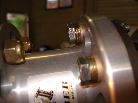

After reading all the helpful suggestions I now have a plan. I have ordered a propeller hub extension from Saber Mfg in TX. The prop will be moved back 3" to reduce tip noise.

Steve Boetto
Joined: 11 Jan 2006
Posts: 365
PostPosted: Thu Mar 06, 2008 4:26 am    Post subject: FireStar Cockpit Noise Reduction? Reply with quote
In a message dated 3/5/2008 9:55:56 P.M. Eastern Standard Time, grageda(at)innw.net writes:
Hi All,
Carlos,
Sounds like you bought #2 of 2 prototypes that Saber cut for me. I have not run mine yet but unless they re cut it you will have to make some custom washers. the clearance next to the inner hub is too tight for the bolt head. They could cut the inner spool to a smaller OD but they did not want to reduce it.
I bought some aluminum washers from ACS and knocked the edge off on the belt sander.
The reason for all the washers is because I used long enough metric bolts so as to have a grip long enough to all the way through the hub.
steve

PostPosted: Thu Mar 06, 2008 8:55 am    Post subject: FireStar Cockpit Noise Reduction? Reply with quote
