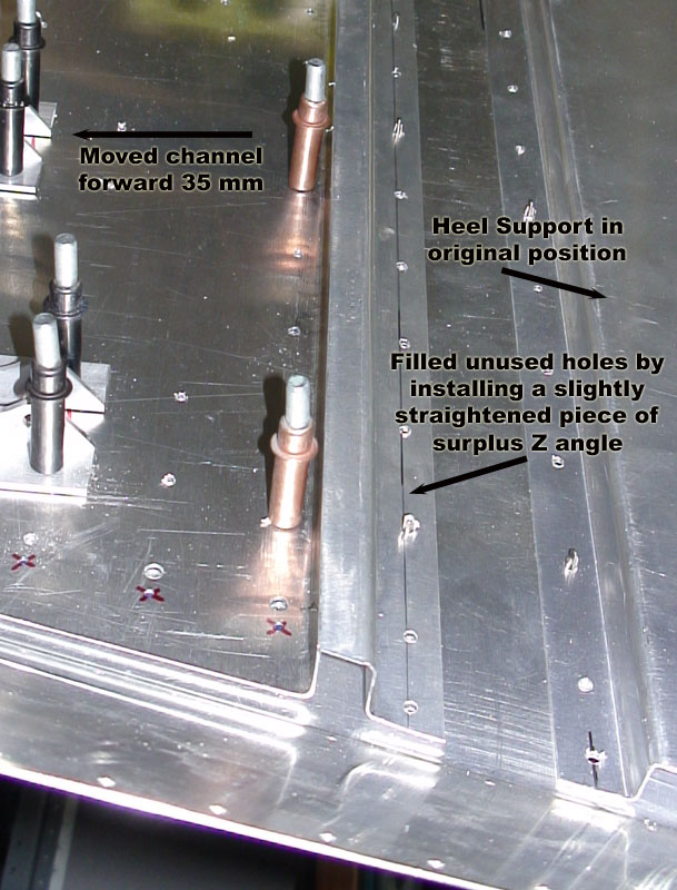

PostPosted: Sat Mar 29, 2008 5:12 pm    Post subject: Re: Moving rudder pedals forward Reply with quote
I have a pre-drilled cabin floor. I ended up moving the rudder pedal channel about 35 mm forward - that way I can take advantage of some of the existing holes (I filled the unused ones with A3 rivets.) When I moved the channel I left a row of unused rivet holes so I slightly straightened a piece of surplus Z angle and installed it. My reasoning is that I would (a) fill the holes and (b) add a little additional strength to the cabin floor. See pix.
Remember, you can also gain some room by adjusting the length of the steering rods and thus the angle of the rudder pedals.
Tim

differential braking easier to add, and taking less pedal movement
towards the firewall.
I didn't move the heel support and haven't noticed a problem with my
size 12s Wink ... your situation may vary .... Many HD/HDS builders
have added some strengthening along the baggage shelf edge because
that is a common place that was getting damaged from inadvertant
loads being placed there .. (i.e. it's a natural place to grab while
getting in and out...)
For XL builders I think all these mods are incorporated into that
aircraft...?
Grant Corriveau
C-GHTF 601HDS
CAM100

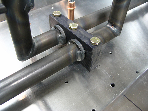

PostPosted: Sun Mar 30, 2008 8:53 am    Post subject: Re: Moving rudder pedals forward Reply with quote
Great responses!
Here was my solution. Because I wanted to retain the opportunity to re-rig the plane for a "normal sized" pilot, I remade my cabin floor and pedal bearing channel. I added 40mm to the front edge of the channel (195mm instead of 155mm) and added an additional 3/16" hole 33mm forward of the existing central pedal bearing holes to allow forward adjustment by 1.3 inches. Pictures attached. No change to the heel support.
Thanks to everyone for the helpful responses. This list really saved the day.
 Filesize:  121.88 KB
 Viewed:  515 Time(s)
 Filesize:  104.18 KB
 Viewed:  565 Time(s)
Larry Winger
