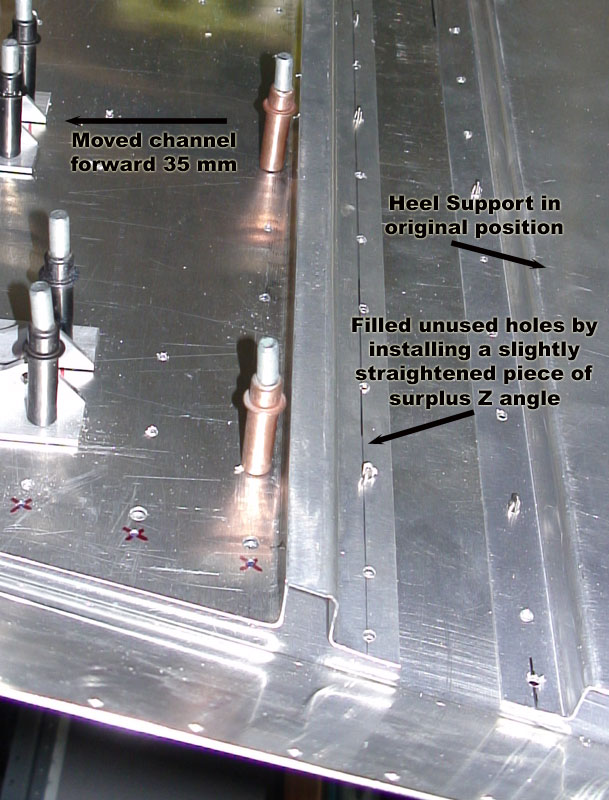

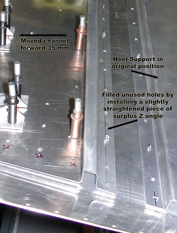

Tim Juhl
Joined: 21 Mar 2006 Posts: 488 Location: "Thumb" of Michigan
Posted: Sat Mar 29, 2008 5:12 pm Post subject: Re: Moving rudder pedals forward |
I have a pre-drilled cabin floor. I ended up moving the rudder pedal channel about 35 mm forward - that way I can take advantage of some of the existing holes (I filled the unused ones with A3 rivets.) When I moved the channel I left a row of unused rivet holes so I slightly straightened a piece of surplus Z angle and installed it. My reasoning is that I would (a) fill the holes and (b) add a little additional strength to the cabin floor. See pix.
Remember, you can also gain some room by adjusting the length of the steering rods and thus the angle of the rudder pedals.

lwinger
Joined: 21 Jun 2006 Posts: 229 Location: Tustin, CA
Posted: Sun Mar 30, 2008 8:53 am Post subject: Re: Moving rudder pedals forward |
Great responses!
Here was my solution. Because I wanted to retain the opportunity to re-rig the plane for a "normal sized" pilot, I remade my cabin floor and pedal bearing channel. I added 40mm to the front edge of the channel (195mm instead of 155mm) and added an additional 3/16" hole 33mm forward of the existing central pedal bearing holes to allow forward adjustment by 1.3 inches. Pictures attached. No change to the heel support.
Thanks to everyone for the helpful responses. This list really saved the day.
