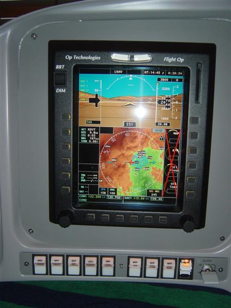

t's a bit pricey, but here's a link to Pacific Coast who has a 'paddle'
type flap switch..
http://www.pca.aero/OnlineCatalog/PCA_pg40-41.html
Right side of page 3/4 way down page.
Looks like this installed. (see attached)
Deems Davis # 406
'Its all done....Its just not put together'
http://deemsrv10.com/
