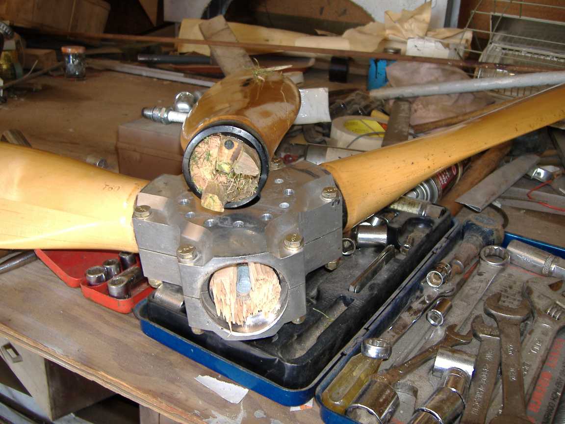

GSC blade departure.
This one happened a few miles from me 2 years ago. I ended up straightening and welding up the engine mount, fixing the cowl damage replacing the engine and gear box with a brand new unit. And of course a new prop. The owner went to a GSC again after having used GSC for over 20 year he was more than sold on them.
When this on departed he was not airboune but taxing back to shop and that blade departed just a few feet from hangar door. Owner was 84 years old at the time and still flies daily once snow melts. His snow drift almost gone this week and expect him out this week one day.
THis prop to my knowledge always had a good gap on aluminum blocks and was never over tightened, but it was over 5 years old.

PostPosted: Mon Apr 07, 2008 6:12 am    Post subject: CGS Prop blades Loose Reply with quote
There’s something that CAN be done if the blades of a GSC prop are loose because the hubs are touching.
I’ve owned my Model 1 with the GSC prop for 14 years and I never overtorqued the bolts, ever. (I’m the only one who’s ever worked on my Kitfox). I’ve always used the recommended 10 ft-lbs and always carefully “snuck up” on the final torque during the torquing process. Yet after about five years, the hubs nearly touched. I had a machinist plane off 0.010” from both inside hub faces on a milling machine. Since then, about 11 years now, they are nearly touching again, but re-torquing does not bring them any closer.
To insure the blades are secure, my annual inspection not only includes re-torquing the bolts but also involves putting a “wrench” on each blade to insure it doesn’t turn. I’ve found that as long as I have the proper torque on the bolts and the hubs aren’t touching, there’s no way to rotate a blade without breaking it.

PostPosted: Mon Apr 07, 2008 5:10 pm    Post subject: Re: CGS Prop blades Loose Reply with quote
Mike, you are playing with luck right now -- well past TBO and over torquiing. GSC calls for 8 foot lbs ( 100 inch /pounds. )
That last pic i sent had never been over tightened but it still failed.
