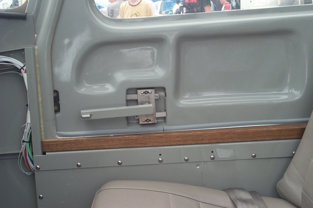

The plans are silent on this, but attached is a photo of 410RV. If you do not cut the hole in the back of the pocket, there is no way to achieve required full pin travel.
cheers,

Yes, holes on both sides for the gear bars to go in and out.
And, it's important to position the bars on just the right
teeth so you get maximum extension on the rods.
cheers,
