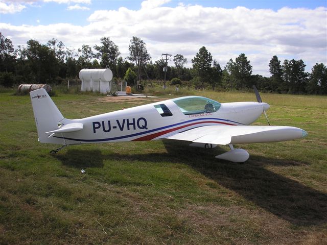

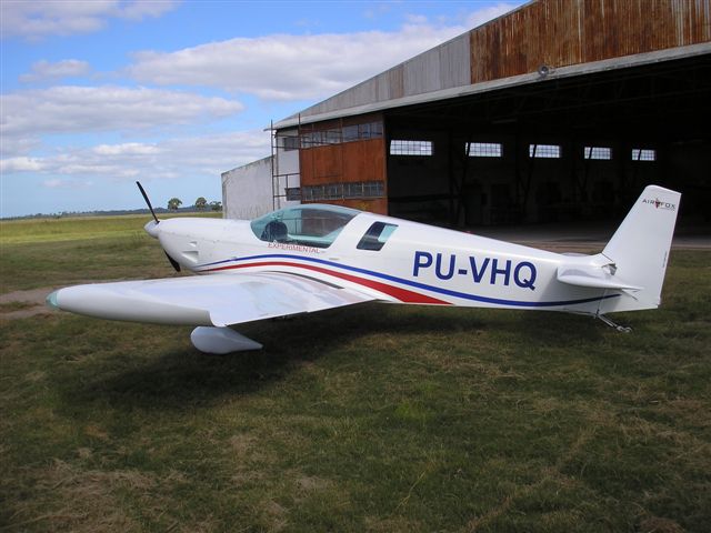

PostPosted: Tue May 06, 2008 10:45 am    Post subject: Another XL Down - Brazil Reply with quote
It may have been this plane and pilot. If so he certainly had lots of flying experience.
He sent a “first flight” announcement to the list on 4/26.
-- Craig
From: Roberto Ap. Rodrigues de Brito [mailto:lenabeto(at)uol.com.br]
Sent: Monday, March 24, 2008 6:49 PM
To: Undisclosed-Recipient:;
Subject: Fw: Enviando email: p3240001.jpg, p3240005.jpg
Hi guys.
How are you?
This is Ricardo Lopes's Zodiac TD by Airfox. (he's my friend)
For me it's beautifull Smile Smile
He flown it today afternoon and he said that the plane is great, nice.
He is an Agricultural Pilot and he has 18.500 hours as pilot.
Rgds.
Beto.
 Filesize:  71.7 KB
 Viewed:  1024 Time(s)
 Filesize:  58.49 KB
 Viewed:  1043 Time(s)

It was indeed Ricardo's airplane. The site of the accident is a few kilometres from Pelotas, the city where he lived (and where I lived for about a year back in the late sixties).
In this satellite image you can identify the hangar and tank that appear in the pictures that Craig posted.
http://tinyurl.com/6zl9tt
