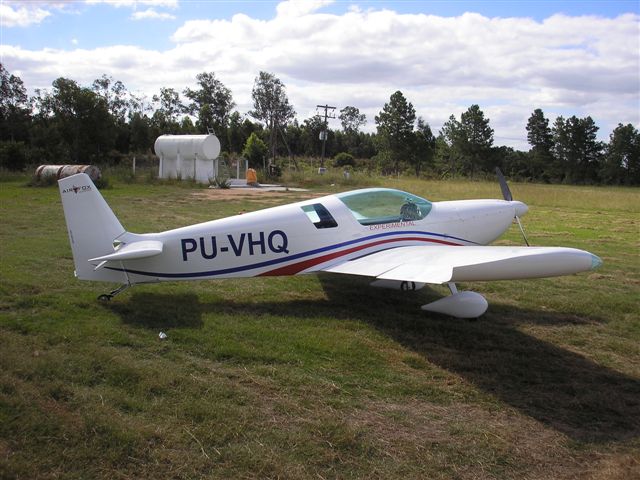

It may have been this plane and pilot. If so he certainly had lots of flying experience.
He sent a “first flight” announcement to the list on 4/26.
-- Craig
From: Roberto Ap. Rodrigues de Brito [mailto:lenabeto(at)uol.com.br]
Sent: Monday, March 24, 2008 6:49 PM
To: Undisclosed-Recipient:;
Subject: Fw: Enviando email: p3240001.jpg, p3240005.jpg
Hi guys.
How are you?
This is Ricardo Lopes's Zodiac TD by Airfox. (he's my friend)
For me it's beautifull
He flown it today afternoon and he said that the plane is great, nice.
He is an Agricultural Pilot and he has 18.500 hours as pilot.
Rgds.
Beto.

> I wonder why he didn't pull the chute. Maybe he though he could recover the plane on time or got incapacitated.
I thought that one report said that the pilot and mechanic died. The mechanic could have pulled the chute.
Also speaking of modifications, the plane linked to appears to have wet wing:
http://portal.ucpel.tche.br/py3vhq/home/Zodiac/fotos/24-03-2007/Partes%20do%20Zodiac%20429.jpg
-- Craig [quote] [b]

This aircraft had many mods that were intended to bring a light aircraft
into much faster operating speeds and weights than
the controls and linkages provided for the standard 601. Nice looking,
but bold mods that could put safety issues up front.
Craig Payne wrote:
| Quote: |
*> * I wonder why he didn't pull the chute. Maybe he though he could
*I thought that one report said that the pilot and mechanic died. The
mechanic could have pulled the chute.*
*Also speaking of modifications, the plane linked to appears to have
wet wing:*
*http://portal.ucpel.tche.br/py3vhq/home/Zodiac/fotos/24-03-2007/Partes%20do%20Zodiac%20429.jpg*
*-- Craig*
| | - The Matronics Zenith-List Email Forum - | | | Use the List Feature Navigator to browse the many List utilities available such as the Email Subscriptions page, Archive Search & Download, 7-Day Browse, Chat, FAQ, Photoshare, and much more:
| Back to top |
jshep00(at)centurytel.net Guest
Posted: Tue May 06, 2008 5:52 pm Post subject: Another XL Down - Brazil |
If a wing also came off this 601, I for one find this totally unacceptable.
There should be much more tolerance than a few percent of strength
difference built into the design. There has to be many more 601's out
there with similiar mods, changes. This was not an old-stress fatigued
aircraft. A cessna 172 is rated +3.8 -1.52 at gross. They don't have a
history of falling out of the sky.by losing a wing even at 5-10,000 hrs of
air time.If it was a stall-spin, I wonder if the 15 Degree elevator stop was
installed?

You are right, there was passenger on board. The picture in the link shows the BRS compartment, maybe it was just the compartment but the BRS might have not be installed yet. We will eventually know.

Just looked on the Emhart website and the rivets they manufacture are POP brand rivets that according to the website are not specified for aviation, but instead RV's and boats.....
Typical Applications - Air bags
- Appliances
- Overhead doors
- Truck trailers
- Acoustical ceiling
- Personal watercraft
- Overhead lighting
- RVs
The website is:
http://www.emhart.com/products/pop/rivets.asp
Not sure if they were used in the plane, but they should not have been.
On Tue, May 6, 2008 at 10:11 PM, Kevin Bonds <kevinbonds(at)comcast.net (kevinbonds(at)comcast.net)> wrote:
[quote] --> Zenith-List message posted by: Kevin Bonds <kevinbonds(at)comcast.net (kevinbonds(at)comcast.net)>
Doesn't seem they were using avex rivets either. What's up with these? http://portal.ucpel.tche.br/py3vhq/home/Zodiac/fotos/rebites-nota2.jpg
Take a look at this link, I don't speak spanish/portugese but it appears that the 1 1/2" pieces likely used the (presumably) used for the spar were 6351 T6. Is this correct? I just kind of stumbled on this when looking at the
