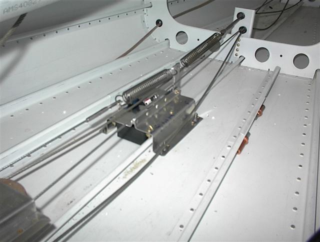

I have 'developed' a spring bias rudder trim system
for the RV-10. After
sharing this idea with Deems he encouraged me to do the
same with the rest
of the group. So here goes, but before I get into any
details let me
preface this whole conversation with a few thoughts. This
is all in
theory, I have absolutely no actual flight testing to back
up any of the
'claims', or assumptions. Just good old common
sense and a tiny bit of
engineering. Our airplane is not in the air yet, I had
hoped to get in
the air, prove out the system, then share with the world.
To prevent
anyone else for possibly needlessly cutting into their
rudder to add a
trim tab, I have decided to bear the scrutiny of an
unproven, theoretical
system. Please be gentle...

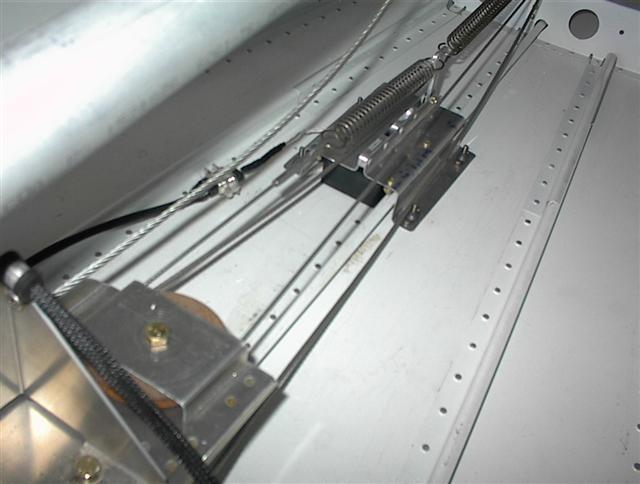

I will attempt to verbalize the system. I used two torsion
springs, one
mounted / wrapped around, each rudder bar (the bar that
connects the
rudder pedals). One of the springs is fixed on both ends
providing a
torsional force on the rudder bar. The other springs free
end is hooked
to a servo motor that allows approximately 30 degrees
deflection. The
theory is that the two springs will seek equilibrium (OK,
that's not much
theory, that's more fact), here is where the testing
needs to happen. If
I deflect the one springs free arm 30 degrees, will it
create enough force
to put the airplane in trim. The springs apply about an 8
pound force to
the rudder cables (pre-load if you will), assuming they
will want to
maintain in equilibrium a 30 degree deflection should be
more than enough
to trim the airplane. The servo will act as sort of a fine
tuning
mechanism, the course adjustment will be accomplished by
winding more or
less tension in one spring or the other during flight
testing.

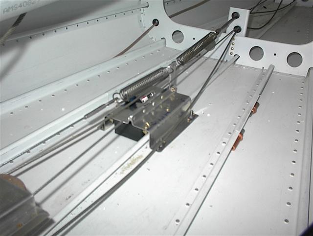

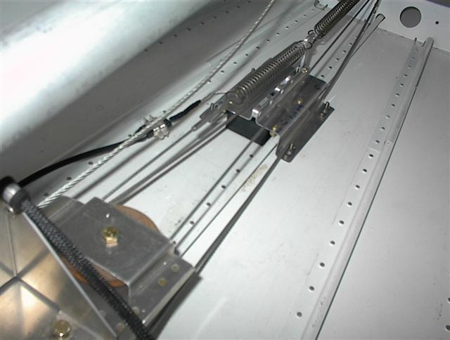

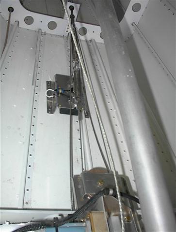

I sent pictures of this system to Deems, I will
'attempt' to post some
pictures to this forum if there is interest. Comments

1. How did you determine which spring type/size/strength to
use?
OK, you busted me!! I didn't do the math, I feel
extremely guilty about
this, as an engineer, I should probably go back and figure
the forces
here. Here is what I did; since I grew up in the business
of garage doors
(my Dad owned his own company doing this), I went to Fleet
Farm (one of
our local supply houses, similar to most lumbar yards) and
found a garage
door spring that had an ID that would slide over the rudder
bar with room
to spare, and would fit between the two rudder bars (I will
measure this
for you). I then cut lengths of the spring until I got
what I 'thought'
was a reasonable amount of force with two turns of
pre-load, and bent some
custom ends on them. With torsion springs you have two
options to
increase the reaction force. You can add turns of
pre-load, or you can
shorten the spring with the same number of turns. I just
went until I
reached what I 'felt' was a happy medium. Remember
that as you wind a
torsion spring more and more the inside diameter decreases,
until it
eventually binds on the shaft (rudder bar). What mostly
drove me not to
do the math, was I had absolutely no idea what sort of
corrective rudder
pressure was required to put the ball in the middle. My
plan all along
has been to get it in the air and do some experimenting, I
installed the
system so that modification of the spring force should be
simple. I just
need to start dating a contortionist Smile
2. I assume that you can 'adjust the torsional load
somewhat by moving
the collar/s, Is that true?
Correct, I started out with each spring wound an equal
amount. If I find
that I need additional trim to one side or the other I will
wind one of
the springs to compensate. The servo will just provide the
'fine tuning'.

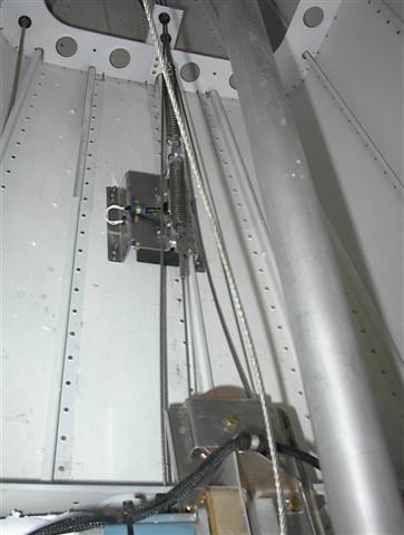

3. One of the pictures shows the center support brace minus
the delrin
bushings, I'm assuming that leaving those out is not a
requirement of
your approach and was just the result of taking the picture
before they
were installed?
Correct, in fact there isn't a single modification to
the airframe, if I
remove the system no one could ever tell it was installed.
I built the
mount so that it could be used in either the forward or aft
rudder
mounting positions, my pedals are mounted in the aft
position. But I
drilled and prepped the airframe to mount the rudder pedals
in either
position.

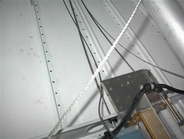

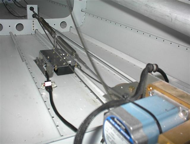

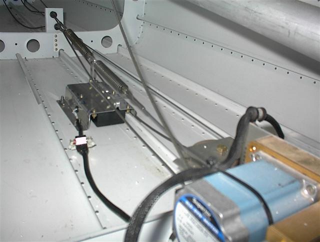

4. What about the mount for the RAC servo, do you have a
picture of it
before the servo is mounted.
See attached.... The angle was determined by something, I
just don't
recall what anymore. I know it has to be at an angle to
work though. I
can measure if you decide to attempt this.
5. Also it' looks like you used a small section of SS
cable to connect
the servo arm to the spring coil, correct? Picture?
Correct, see attached. One end is run through the servo
arm, the other
gets hooked by the spring. The spring on the pilot side is
hooked over
the opposite rudder bar.

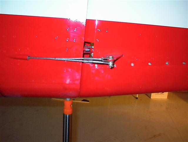

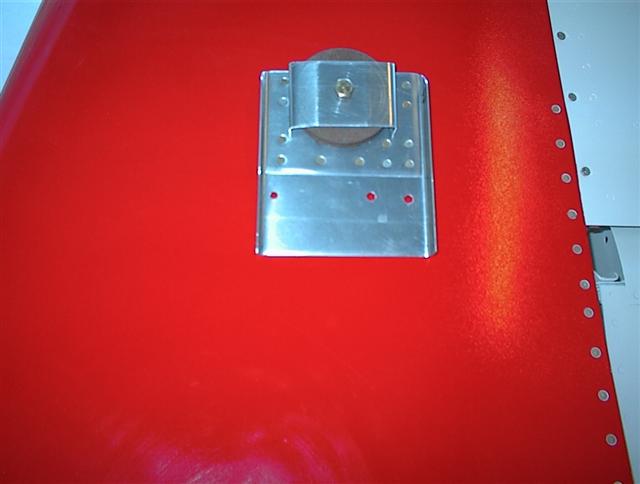

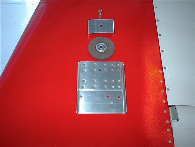

OK, here they are. Installation in the tail cone is straight forward. Bolt
the pulley bracket behind the elevator bellcrank using the aft 3 screws.
Build Vans aileron trim unit and locate the servo unit about half way
between the aft baggage bulkhead and the next one aft straddling the floor
stiffener. Fabricate 2 3/32" cables, one long enough to wrap around the
pulley. I left a 12" gap that the springs would bridge and provide bias
tension. Attach the cables to the rudder horn. Hook up the servo to the
switch and indicator. Fly. I added a keeper to the pulley bracket to insure
the cable could not come off the pulley. It adds some small security for
gust protection on the ground but not enough to replace a gust lock.
Albert Gardner
N991RV
Yuma, AZ

That is a very clean and foolproof installation.
Bill DeRouchey

[quote]OK, here they are. Installation in the tail cone is straight forward. Bolt
Albert Gardner
