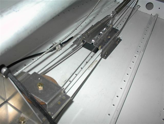

I have 'developed' a spring bias rudder trim system
for the RV-10. After
sharing this idea with Deems he encouraged me to do the
same with the rest
of the group. So here goes, but before I get into any
details let me
preface this whole conversation with a few thoughts. This
is all in
theory, I have absolutely no actual flight testing to back
up any of the
'claims', or assumptions. Just good old common
sense and a tiny bit of
engineering. Our airplane is not in the air yet, I had
hoped to get in
the air, prove out the system, then share with the world.
To prevent
anyone else for possibly needlessly cutting into their
rudder to add a
trim tab, I have decided to bear the scrutiny of an
unproven, theoretical
system. Please be gentle...
I will attempt to verbalize the system. I used two torsion
springs, one
mounted / wrapped around, each rudder bar (the bar that
connects the
rudder pedals). One of the springs is fixed on both ends
providing a
torsional force on the rudder bar. The other springs free
end is hooked
to a servo motor that allows approximately 30 degrees
deflection. The
theory is that the two springs will seek equilibrium (OK,
that's not much
theory, that's more fact), here is where the testing
needs to happen. If
I deflect the one springs free arm 30 degrees, will it
create enough force
to put the airplane in trim. The springs apply about an 8
pound force to
the rudder cables (pre-load if you will), assuming they
will want to
maintain in equilibrium a 30 degree deflection should be
more than enough
to trim the airplane. The servo will act as sort of a fine
tuning
mechanism, the course adjustment will be accomplished by
winding more or
less tension in one spring or the other during flight
testing.
I like a few things about this method.
1) It can be installed to any flying airplane with no
modifications
required other than wiring.
2) There is a chance that this system could be made manual
and eliminate
the RAC servo if desired.
3) This system provides tension to both rudder cables, no
more 'flopping
rudder'.
4) Keeps the rudder 'clean'.
5) Doesn't add much extra rudder input force.
I sent pictures of this system to Deems, I will
'attempt' to post some
pictures to this forum if there is interest. Comments
welcome, I
apologize for the extremely long post, but I have added
Deems questions
below, I figured if he asked, many more will have the same
questions....
1. How did you determine which spring type/size/strength to
use?
OK, you busted me!! I didn't do the math, I feel
extremely guilty about
this, as an engineer, I should probably go back and figure
the forces
here. Here is what I did; since I grew up in the business
of garage doors
(my Dad owned his own company doing this), I went to Fleet
Farm (one of
our local supply houses, similar to most lumbar yards) and
found a garage
door spring that had an ID that would slide over the rudder
bar with room
to spare, and would fit between the two rudder bars (I will
measure this
for you). I then cut lengths of the spring until I got
what I 'thought'
was a reasonable amount of force with two turns of
pre-load, and bent some
custom ends on them. With torsion springs you have two
options to
increase the reaction force. You can add turns of
pre-load, or you can
shorten the spring with the same number of turns. I just
went until I
reached what I 'felt' was a happy medium. Remember
that as you wind a
torsion spring more and more the inside diameter decreases,
until it
eventually binds on the shaft (rudder bar). What mostly
drove me not to
do the math, was I had absolutely no idea what sort of
corrective rudder
pressure was required to put the ball in the middle. My
plan all along
has been to get it in the air and do some experimenting, I
installed the
system so that modification of the spring force should be
simple. I just
need to start dating a contortionist
2. I assume that you can 'adjust the torsional load
somewhat by moving
the collar/s, Is that true?
Correct, I started out with each spring wound an equal
amount. If I find
that I need additional trim to one side or the other I will
wind one of
the springs to compensate. The servo will just provide the
'fine tuning'.
3. One of the pictures shows the center support brace minus
the delrin
bushings, I'm assuming that leaving those out is not a
requirement of
your approach and was just the result of taking the picture
before they
were installed?
Correct, in fact there isn't a single modification to
the airframe, if I
remove the system no one could ever tell it was installed.
I built the
mount so that it could be used in either the forward or aft
rudder
mounting positions, my pedals are mounted in the aft
position. But I
drilled and prepped the airframe to mount the rudder pedals
in either
position.
4. What about the mount for the RAC servo, do you have a
picture of it
before the servo is mounted.
See attached.... The angle was determined by something, I
just don't
recall what anymore. I know it has to be at an angle to
work though. I
can measure if you decide to attempt this.
5. Also it' looks like you used a small section of SS
cable to connect
the servo arm to the spring coil, correct? Picture?
Correct, see attached. One end is run through the servo
arm, the other
gets hooked by the spring. The spring on the pilot side is
hooked over
the opposite rudder bar.
I gave some thought to your desire to have a manually
operated system, I
think this system could be done manually with very little
pain. You may
be able to add a knob that would come out of the sub panel,
really
anywhere along its length. What would have to happen is a
bracket would
need to be made that slid over the rudder bar with a nut in
it. Then a
threaded shaft running from the rudder bar to the sub panel
would be used
to adjust the free arm of the spring. It may be best if
the spring were
pushed by the shaft instead of pulled, as this would make
the mechanism a
bit simpler. I could do a drawing of what I am thinking if
you are not
following.
While it was not my intention to begin producing kits, if
there is enough
interest, I could be persuaded to fabricate a few.
Thanks, Jason

All, I have received several off-line inquiries as to the status of the development of the spring bias rudder trim system. The work continues however, it has gone down an unexpected path. Since receiving so many requests for kits, I decided it would be best to put pencil to paper and actually calculate the trim forces we could expect to see. Well, numbers don't lie (if you ask the right question), and the numbers didn't look good. The maximum trim force I could accomplish given the limits of the servo motor both in stroke, and thrust, is 2lbs.
This is far below the value required to effectively trim the aircraft through a wide range of the flight envelope. Van's estimated the required forces to be 5-10 lbs for 'standard' trim, and 25 lbs for takeoff measured at the bottom of the rudder pedal. I had a conversation with Ken from Vans at Sun-N-Fun, I asked him "If you were going to design a rudder trim for the 10 what would it look like?". Long answer short, he would design a spring bias system, he would not add a movable trim tab to the rudder due to the potential to put the rudder out of balance. Please note, I am not trying to start a war here on the better way to add trim, just relaying what I was told. He liked a spring system because it holds a bit of pressure on the rudder, which could eliminate some adverse yaw in turbulence. I asked him why they haven't designed a system yet, and he first replied, we really don't think it is necessary, he then said that he has tried a few times and couldn't come up with a simple enough solution.
So, what does this all mean? After seeing the post by Albert Gardner I started to rethink the concept. I liked the idea of using extension springs, as they would allow the forces acting on the servo to stay within limits, while providing 10+ lbs of trim force. I still like the idea of keeping the rudder cables under tension throughout the system, this means the springs still need to be connected up-front. I have some ideas, but have not assemble the complete concept yet. Unfortunately it will not be as simple, which is a big negative in my book, I really like simple!
All is not lost, if a person does not want rudder trim, but is tired of 'floppy rudder syndrome' the torsion springs provide enough force. They can be wound during installation to accomplish a certain fixed trim force, eliminating the need to glue a trim block to the rudder. I will let everyone know how this all turns out. Sorry for not sending an update earlier, but I have been trying to get a complete answer before posting something again.
Thanks, Jason Kreidler

I was going to reply off-line but decided that maybe more ideas can be generated as a group:
jason.kreidler(at)regalbeloit.com (jason.kreidler(at)regalbeloit.com) wrote: | Quote: |
| I assume, from the statement below that this only applies to the torsion spring design ..... so why not a small jackscrew instead of a trim servo?
SNIP
| Quote: | So, what does this all mean? After seeing the post by Albert Gardner I started to rethink the concept. I liked the idea of using extension springs, as they would allow the forces acting on the servo to stay within limits, while providing 10+ lbs of trim force. I still like the idea of keeping the rudder cables under tension throughout the system, this means the springs still need to be connected up-front. I have some ideas, but have not assemble the complete concept yet. Unfortunately it will not be as simple, which is a big negative in my book, I really like simple!
| Simple is always good! I think if there was a simple solution, it would have shown up already. There are a lot of great minds out there so there should have been something pop up .... even if it wasn't a really great solution, it would be a start.
| Quote: | | All is not lost, if a person does not want rudder trim, but is tired of 'floppy rudder syndrome' the torsion springs provide enough force. | I've never had an airplane with the 'floppy rudder syndrome' ..... and really don't want to start now. I own a Grumman AA-1B with rudder springs ...... the only problem with them is that they're really strong springs and they break ...... but folks smarter than me have devised a 'washer' tool to aid in changing them out. The springs really cure the 'floppy rudder syndrome' which means we have to incorporate a good rudder gust lock to tame the beast. I've modified my rudder pedal attach point to be inside the tunnel, (don't like sand and dirt on my cables) and have thought of a pulley attached to the firewall to make a closed loop system .... or extension springs to the firewall ...... after I find a good spot and beef it up a little. Alas, I just don't have a good answer.
| Quote: | | They can be wound during installation to accomplish a certain fixed trim force, eliminating the need to glue a trim block to the rudder. I will let everyone know how this all turns out. | Thanks for your time/effort. Other than the jackscrew solution, I'm not much help.
| Quote: | Sorry for not sending an update earlier, but I have been trying to get a complete answer before posting something again.
| Rome wasn't built in a day (although I wasn't there to figure out why ) and the solutions to difficult problems take time ..... and I'll really be thinking of a solution before I get too far down the assembly path where it's nigh on impossible to install a mod.

From: owner-rv10-list-server(at)matronics.com [mailto:owner-rv10-list-server(at)matronics.com] On Behalf Of linn Walters

Posted: Wed May 14, 2008 9:13 pm Post subject: Rudder Trim - Spring Bias |
I have been doing a little testing of my spring bias trim system. I did not
measure rudder pedal forces required but the spring bias system has almost
enough force on take off so that only a little right rudder pressure is
required and the same for slow flight. Otherwise for normal climb, cruise
and descents the trim system will center the ball. It was easy to install as
Vans aileron trim servo is used as is and 4 holes drilled in the bottom of
the tail cone to install it. The turn around pulley bracket is simple to
fabricate and bolts to the elevator bell crank housing assy. The hardest
part was pulling additional rudder cables from the trim servo arm back to
the rudder horn. Also, having 2 rudder cables attached to the rudder horn is
the one thing I don't like about the system. I already had a 5 wire cable
installed in the tail come anticipating rudder trim at some later point when
I built the plane and a Ray Allen LED trim indicator and switch on the panel
with wiring completed. The trim forces are fairly easy to overcome so run
away trim doesn't seem to be a big worry. All in all I'm very happy with the
system. Frankly, the idea of clamping the rudder cables to effect trim seems
difficult for me to accept.
Albert Gardner
N991RV
Yuma, AZ
_________________ RV-9A N872RV
RV-10 N991RV |

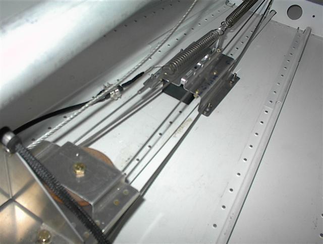

Albert Gardner
Joined: 10 Jan 2006 Posts: 455 Location: Yuma, AZ
Posted: Thu May 15, 2008 2:42 pm Post subject: Rudder Trim - Spring Bias |
OK, here they are. Installation in the tail cone is straight forward. Bolt
the pulley bracket behind the elevator bellcrank using the aft 3 screws.
Build Vans aileron trim unit and locate the servo unit about half way
between the aft baggage bulkhead and the next one aft straddling the floor
stiffener. Fabricate 2 3/32" cables, one long enough to wrap around the
pulley. I left a 12" gap that the springs would bridge and provide bias
tension. Attach the cables to the rudder horn. Hook up the servo to the
switch and indicator. Fly. I added a keeper to the pulley bracket to insure
the cable could not come off the pulley. It adds some small security for
gust protection on the ground but not enough to replace a gust lock.
Albert Gardner
N991RV
Yuma, AZ

That is a very clean and foolproof installation.
Bill DeRouchey
N939SB, flying
Albert Gardner <ibspud(at)roadrunner.com> wrote:
[quote]OK, here they are. Installation in the tail cone is straight forward. Bolt
Albert Gardner
N991RV
Yuma, AZ
