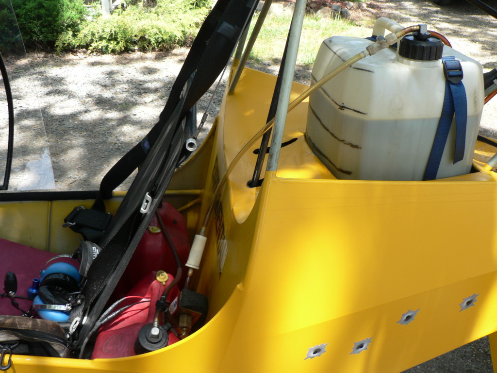

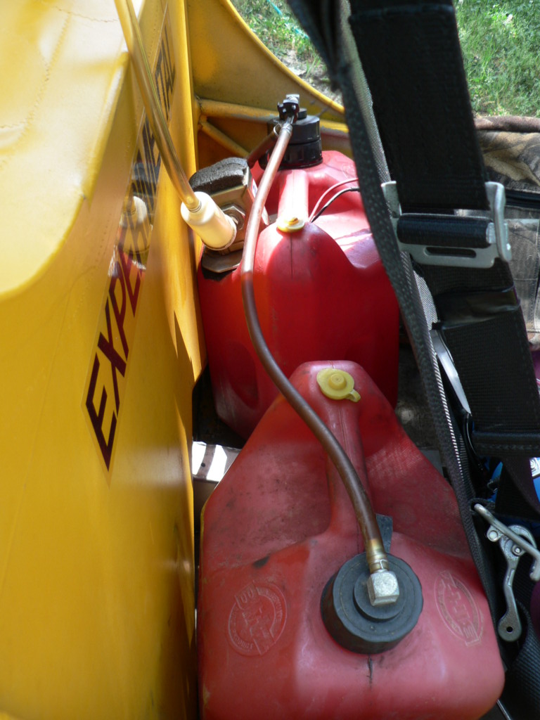

Here are some quick shots of my setup. I'll be using it to fly 356 air miles to the Rock House this Wednesday to meet up with John H, John W, and Larry and Karen Cottrell.
The setup.
 Filesize:  178.34 KB
 Viewed:  566 Time(s)

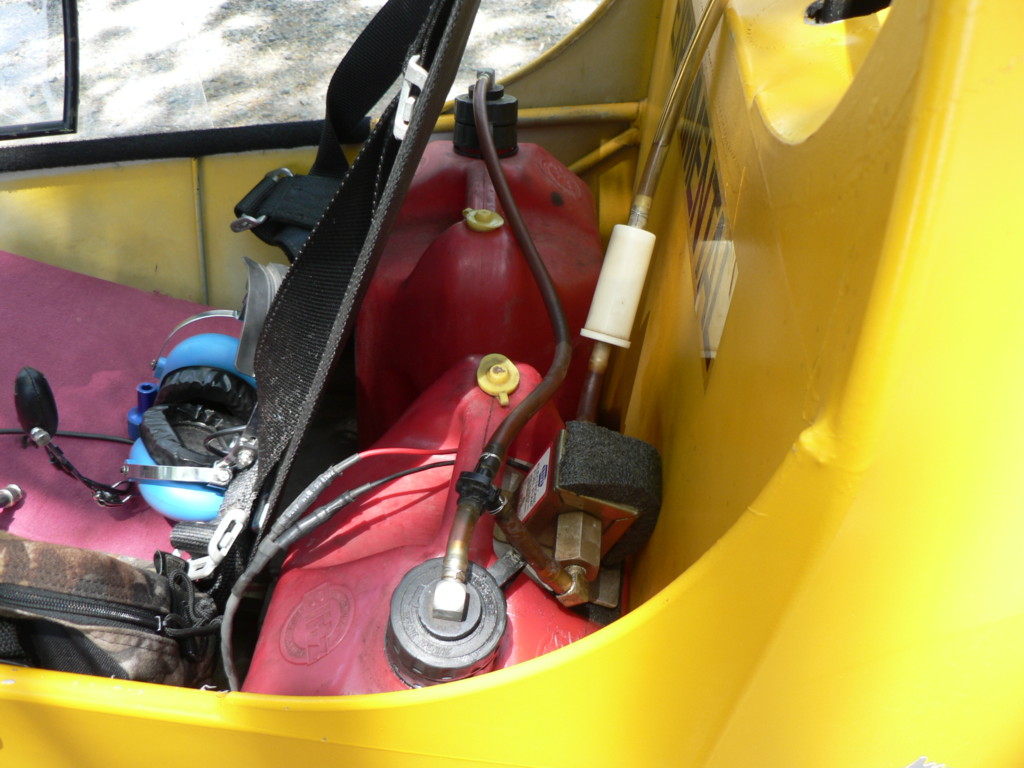

View from the port side
 Filesize:  215.61 KB
 Viewed:  560 Time(s)

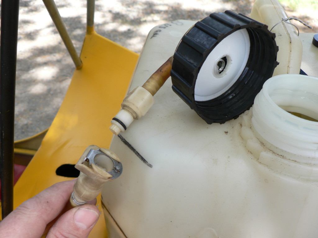

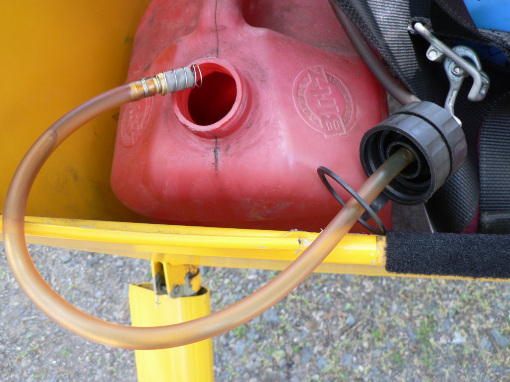

Tank pickup-tube and strainer.
 Filesize:  198.96 KB
 Viewed:  540 Time(s)
View from the starboard side
 Filesize:  178.13 KB
 Viewed:  562 Time(s)
Cap and disconnect
 Filesize:  139.79 KB
 Viewed:  515 Time(s)

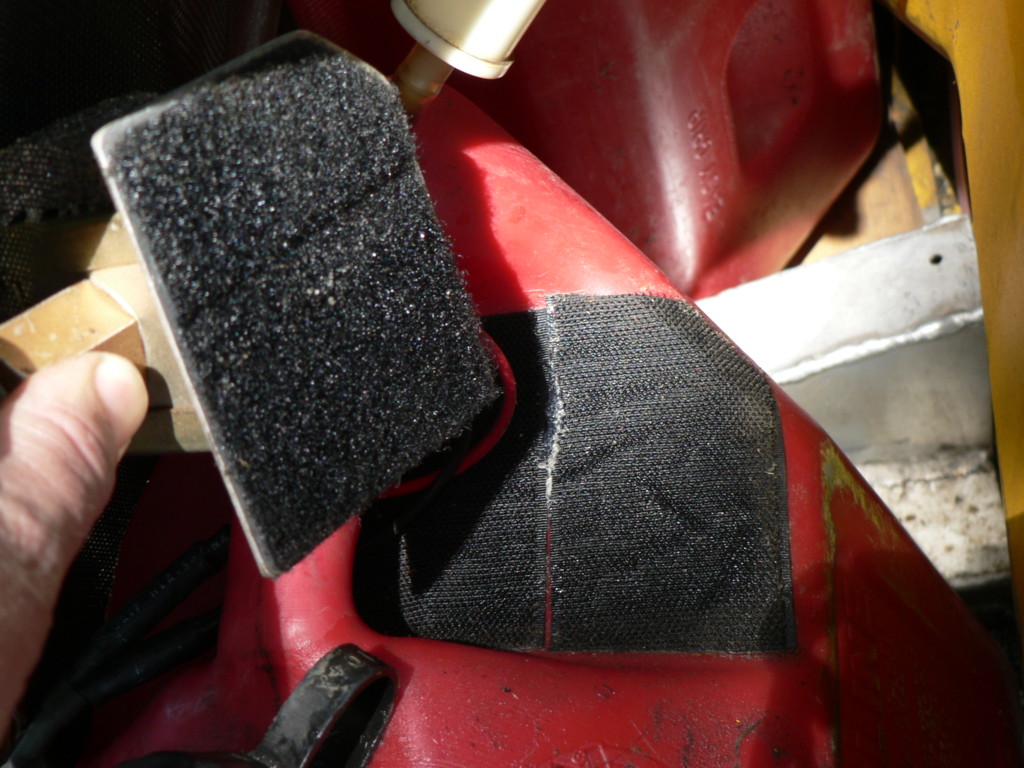

Velcro Mount
 Filesize:  209.02 KB
 Viewed:  513 Time(s)
Roger in Oregon

PostPosted: Mon May 19, 2008 4:55 pm    Post subject: Tansfer pump Ideas? Reply with quote
Rodger NICE idea...
And Its a good thing your Main tank is elevated
Them bullet holes up the side could have messed up Christmas hahahaha Cool
Thanks for the pix..
mark

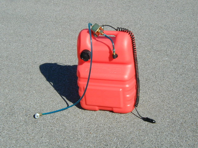

Before I built the 20 gal. aluminum tank for my Mark 3, this is what I used. It is a boat tank with the clunk/filter hose extended to reach the bottom of the tank when standing on end. The fuel pump is a faucet. I used it to transfer fuel in flight. It strapped into the passenger seat. I made a fitting that screwed into the 3/4" pipe thread in the cap of the plastic 5 gallon tanks. This fitting also provided a vent for the tank that I was pumping into.

PostPosted: Mon May 19, 2008 5:11 pm    Post subject: Tansfer pump Ideas? Reply with quote
Hi Steve...
VERY NICE ! Thats exactly what I want to make..
BTW I like the way Rodger Velcros his pump to his can...
Did you install a in line switch to power the pump or
is it just plug and play?
How long did it take the faucet pump to transfer the 5 Gallons ??
Mark

PostPosted: Mon May 19, 2008 5:24 pm    Post subject: Tansfer pump Ideas? Reply with quote
Mark,
I never timed the transfer but the pump is rated at 30 GPH so 5 gallons should take about 10 minutes. If you're close to East Tennessee, $35 will get this one. I no longer need it. If I remember correctly I used Adel clamps to mount the pump to the handle of the tank.
Steven

PostPosted: Tue May 20, 2008 1:13 am    Post subject: Tansfer pump Ideas? Reply with quote
The tank is from Walmart, the fuel pump I bought from Aircraft Spruce.

PostPosted: Tue May 20, 2008 6:07 am    Post subject: Tansfer pump Ideas? Reply with quote
Steve THANKS!
BTW does the pump orientation matter for it to work??
Mounting holes Vertical or Horizontal ???
I was thinking of bolting it to a piece of Delrin
then I could Velcro it to the side of a fuel can....
An easy in and out set up...
Mark

PostPosted: Tue May 20, 2008 10:14 am    Post subject: Re: Tansfer pump Ideas? Reply with quote
Mark,
I'm glad to see that you are going with a well tested, safe pump. The Facet pump will work in any orientation. The fact that you can buy the facet pump from Lockwood, Aircraft Spruce, and CPS should have clued most of the guys in that were giving you bad advice.
Some of these guys are pretty quick to hand out bad advice... Talk is cheap, but I wonder how many of them would actually be foolish enough to drop in a cheap Ebay pump into a plastic tank not designed for it in flight ? Maybe a couple here want to be there for their own barbecue, but from what I read, most people will jump out of a burning airplane, parachute or not, before they will be burned alive.

Mark,
The main tank is sitting on the boom tube. It is an 8 gallon tank out of a Sky Ranger kit. They are under $30 and VERY sturdy. They are 1/2" fatter on the square than the standard tank and quite a bit taller. I had to move the 1/4" crossmember that holds the forward side of the tank to fit it in, but it was worth it for the extra few gallons. As for the bullet holes... You should have seen the other guy Smile.
I'm all packed up, fueled up and headed to the Rock House in the morning. Even with twelve gallons usable, the last leg is a little iffy if the wind kicks up. Maybe I'll hang some bullet shaped tanks off of the struts for next year.

Mark -
The instructions that come with the Facet fuel pump tell you that the
ideal installation is for the pump to be level with the bottom of your
fuel tank, and oriented with its axis of fuel flow at a 45 degree angle.
Of course, you'll see many variations of fuel pump installation that
still work, like on Steven Green's setup for his auxiliary transfer
tank.
Dennis Kirby
